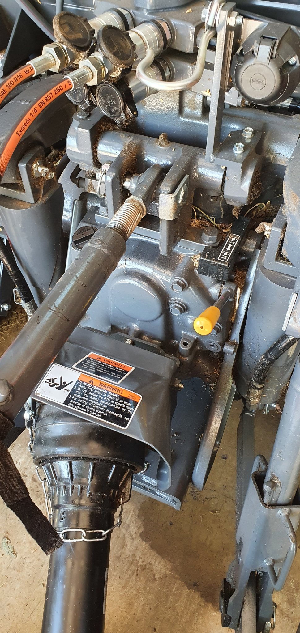

I was going to do some work today with my kubota m9540 hdc when I found the transmission dipstick missing and a small puddle of transmission fluid on the ground under the back of the tractor.
I was doing flail mowing yesterday, and I predict that the dipstick came out (perhaps from a stick) when mowing. I don't know when, nor did I notice anything. If I put a piece of clean wire into the dipstick hole, there is no fluid on it. I don't know how much I have lost. Here's a picture of the transmission dipstick hole if it helps. The hole is just below the yellow lever in the photo. I noticed a lot of fluid on the pto plastic shaft and around the pto housing, giving me the impression that fluid was hosing out. Is it normal to have this pressure in the transmission?

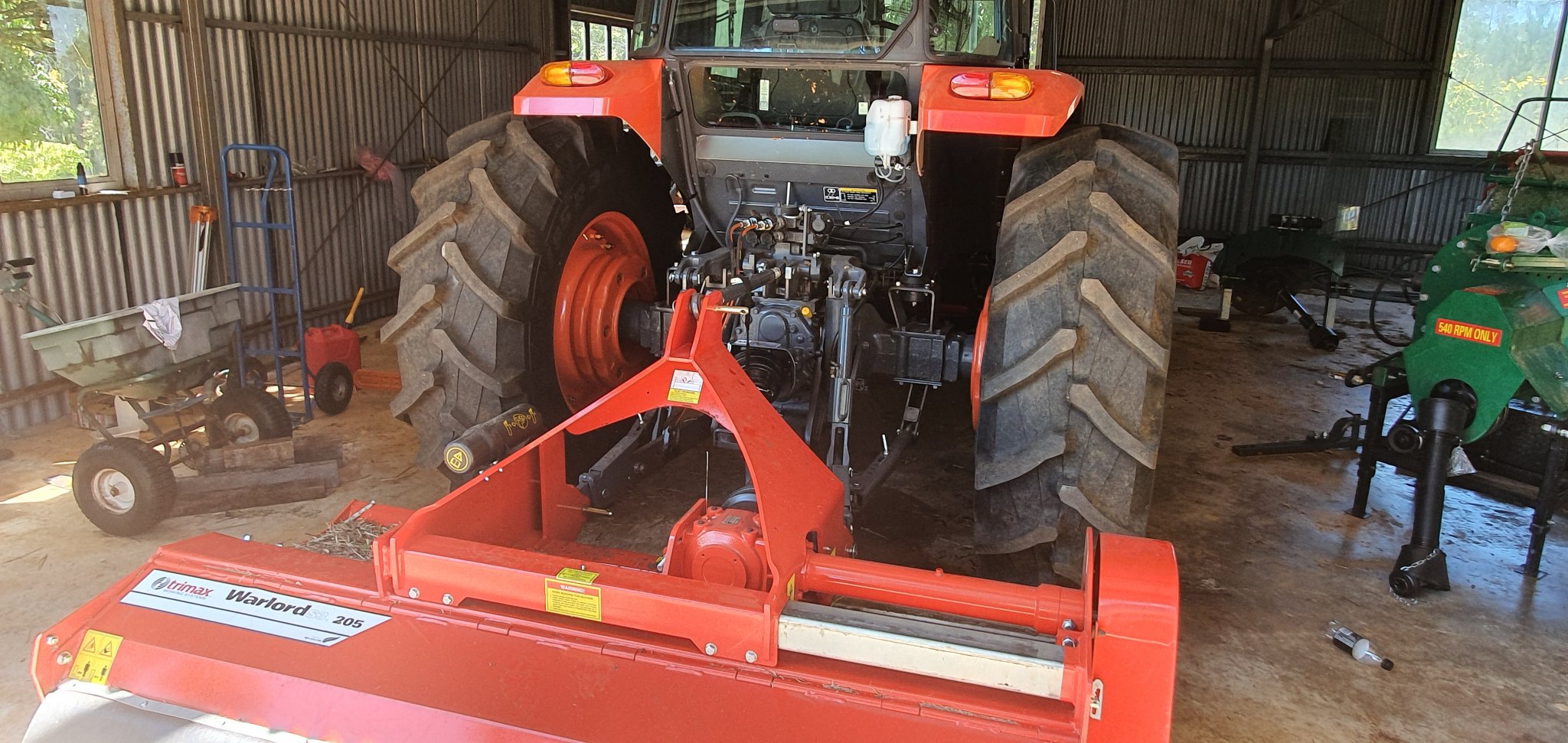

You can see the puddle on the ground in this second photo. I've cleaned it up with a rag though. There was a fair amount there. Maybe 500ml to 1L. I don't know how much more has come out while mowing though.

Just top it off and get a new dipstick

clean the transmission vent
they get plugged and the transmission case builds pressure and then the dipstick gets blown into low earth orbit when the pressure builds high enough

The vent is on top of the gearcase and will have a black rubber hose attached. Some are just curved, others will have some type of mesh insert installed to keep debris out.
I would, for a safety measure against future loss, attach a small safety chain to the dipstick, fastened to one the bolt heads on the pto case.
In as much as it only has 30 hours and is under warranty?, I'd have the dealer get a new one, for zip.
The dipsticks come fitted with a rubber grommet that provides an interference fit resistance in the hole. Yours did have one I presume.
Finally, it SUDT 2 I believe. Won't know how much was lost until you get a new dipstick but you can ascertain the level somewhat. When the tractor is sitting level, The fluid level should be just below the bottom side of the PTO stub. IOW, the level cannot be any higher than the PTO output stub. The stub seal isn't designed to retain a constant pressure of fluid against it, only to contain it during operation, IOW splash.
