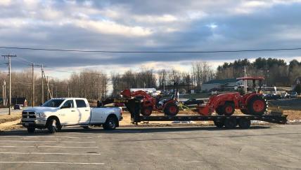

An MX with a loader, loaded rear tires, and a bush hog mower is over 7,000lbs.
I have one as well. Here is what I use:

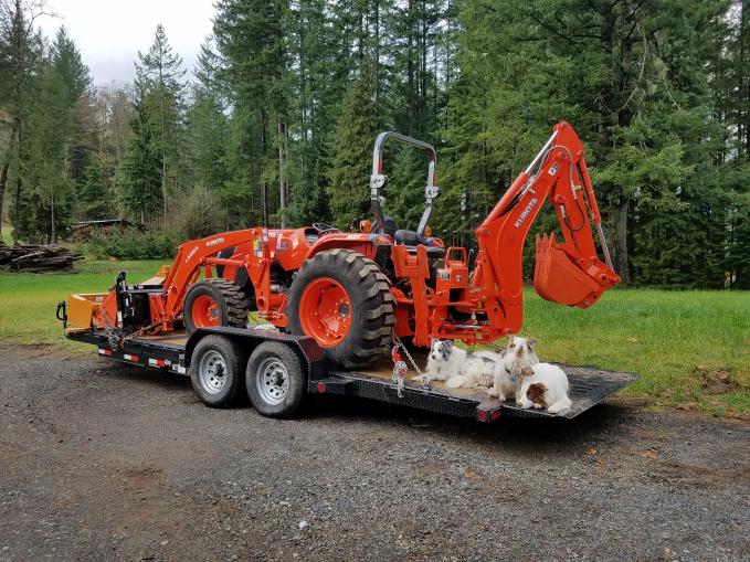

I haul my MX4800 2 or 3 times a week. I have an IronMan 24' with 2x17k axels and electric brakes. It is a hydraulic tilt trailer, takes 5 minutes to load or unload. With my grapple or bucket and 6' LP rotary cutter the tail wheel sets just off the back. I haul it behind my Ford F250 Superduty pickup and have zero problems with it.
No need for four chains and four binders, i use two chains and one binder.
