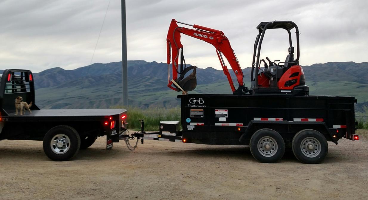

Keeping in mind I already have this 12' 10K GVW dump bed trailer, here is what I have come up with for the occasional move. Unless I get into commer cial work with lots of moves on a weekly basis, this would seem to get the job done. My other alternative is to make a custom hauler, maybe with a tilt bed, and I also have a bid out on a couple used trailers. Both of the used ones are skid steer haulers, with a lower bed then the dumper, and pretty much flat beds so easier to tie down then the dealing with the constraints of the dump beds sideboards.

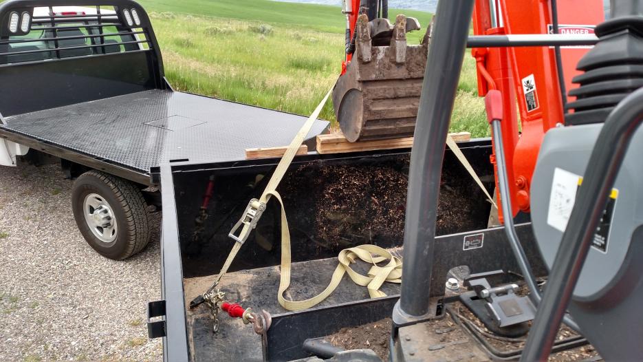

Short of hacking holes in my side boards or welding more tie downs in the bed (which I could do, but that kind of creates a problem for sliding stuff out of the bed, I want to keep them to a minimum), I am dealing with the 4 already located in the 4 corners. Keeping the curled bucket located on the front is the thing, today I am going to weld up a simple bracket that will bolt onto the permenant (like the sides, I call them sideboards but they don't come off) front sideboard with two bolts, and positively preclude any side to side movement. I'll still bind it down to the front tie downs as pictured, and in addition am going to use another tie down to the front of the tongue, so it can't move side to side or fore and aft. That should satisfy any requirements for securing the movable part of any equipment being trucked? I sure can't see it going anywhere.

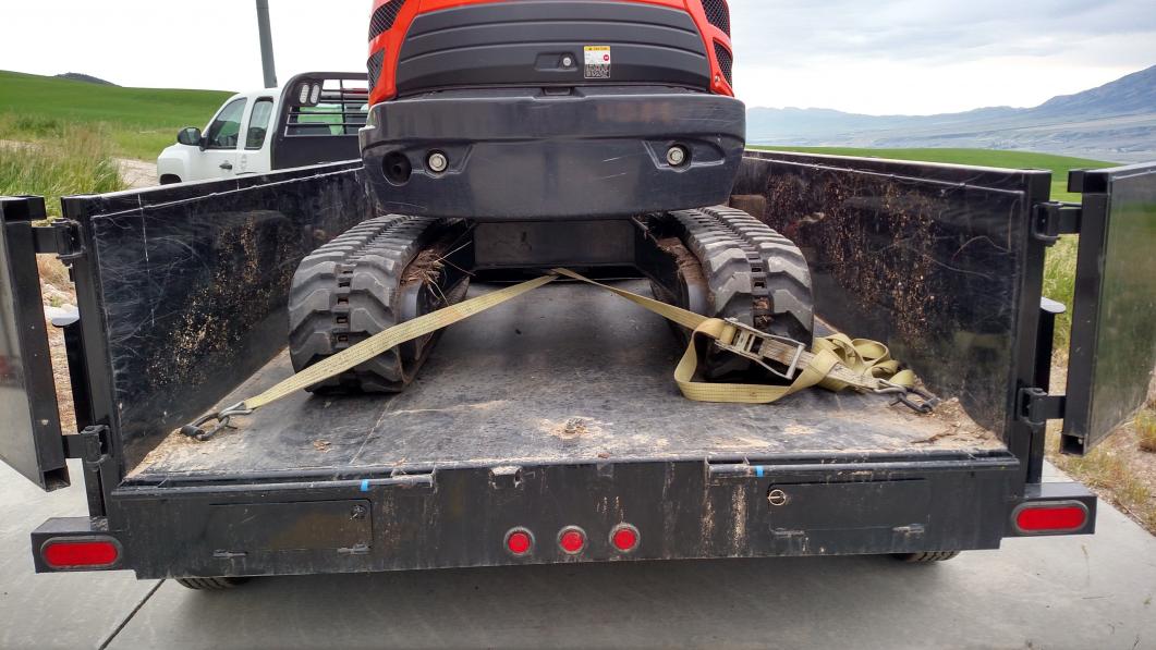

Two chain binders on the front blade, and for now anyway 2 binder straps (one pictured, since replaced by two) on the rear tie down point. Those 2" web straps are pretty strong, but I using two instead of one made me feel better.
I have a state trooper barracks right down the road a 1/2 mile from my crane yard, and a CDL to protect, so I need it all to be legal and pass inspection, as I also have a Port of Entry on the I-15 interstate to contend with if i choose to use the freeway (unlikely, there is a 45 mph secondary road goes the same direction, which is my usual choice to get to my crane yard and town.) Those 2" strap binders on the rear may need to be upgraded, we'll see. I am happy with the center of gravity, the 1 ton pickup and trailer seem to be also, it looks right anyway just sitting there parked, have not driven it yet. The mini weighs 5600lbs I'm told. Critiques invited, blast away, I'm half hoping I get to build a custom trailer but right now this is looking like a reasonable way to haul it my usual 30 or 40 miles round trip a few times a year. BTW, the same trailer (with the same compromises, as oppposed to a custom built hauler) is used for the L 3301. If I do go custom, it would also be my choice for hauling the tractor, they both are 5' wide and have similar needs for tie down placement.
