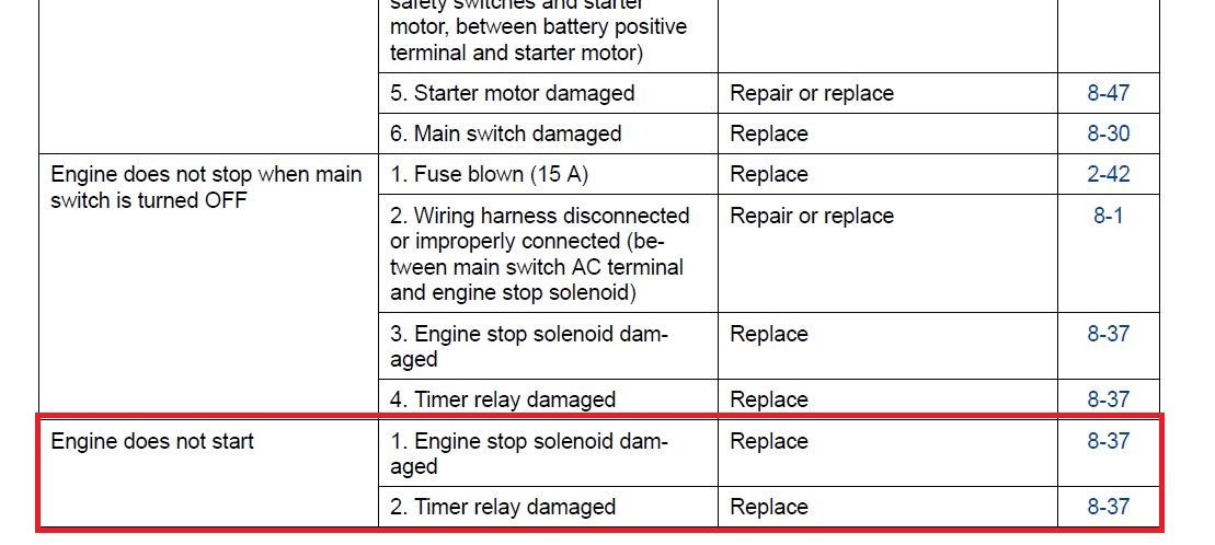

You need to understand the safety systems to figure out what is not working.
This is from memory..... the engine stop solenoid is powered for a few seconds by a timer to shut down the engine............. i.e. you need power to stop the engine. Some tractors work the opposite way.
Unplug the connector for the stop solenoid and try and start the engine.
Report back what happens.

I had the same problem with L4330, crank all day long, no pops. It started out being intermittent, then failed hard.
Traced it to the OPC Timer. $105 plus shipping from Messick's; no aftermarket available. Screw that. I bypassed it; never a problem since.
