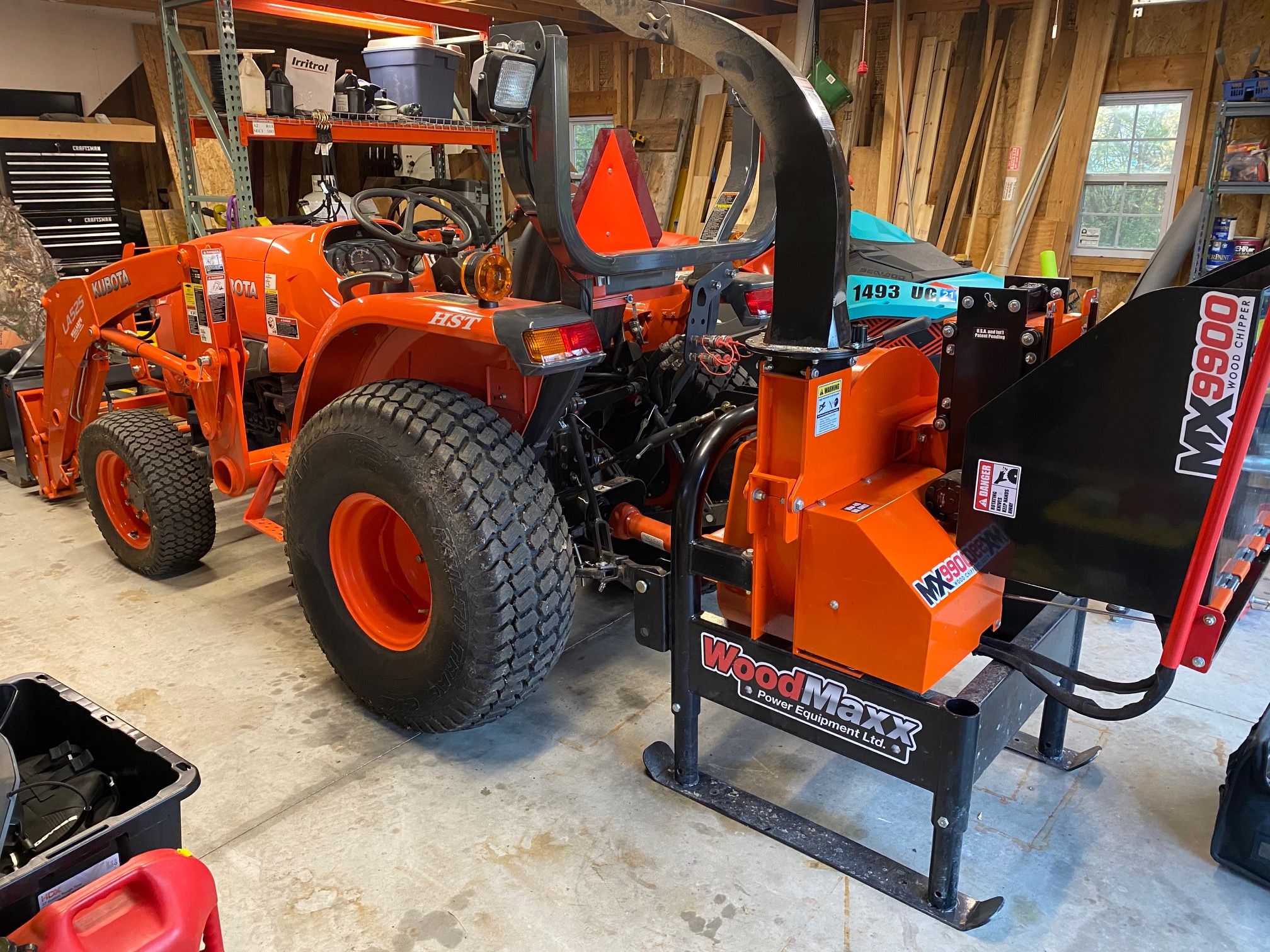

MX6000 You will not be disappointed with your new chipper, I have the MX-9900 which is very similar, Woodmaxx makes good equipment and it is US made. Mine is just a beast and eats whole trees or large branches all day long, I have about 8 miles of trails that I maintain, the auto feed is an amazing feature that allows you to be really productive. Most of the time I run my off an L3200 or L3901, they both handle it fine.
Good luck with your new unit.

MX6000 You will not be disappointed with your new chipper, I have the MX-9900 which is very similar, Woodmaxx makes good equipment and it is US made. Mine is just a beast and eats whole trees or large branches all day long, I have about 8 miles of trails that I maintain, the auto feed is an amazing feature that allows you to be really productive. Most of the time I run my off an L3200 or L3901, they both handle it fine. View attachment 45588
Nice looking set-up!! Thanks for the info, I am looking forward to putting it to work. I was originally looking at the MX-9900, but ended up with the mindset anything bigger than the 8 inch capacity of the MX-8800 would be used for firewood anyway. Doesn't hurt that this decision is going to save me $1K ....They said the MX-9900 is 8-10 weeks out as well.
