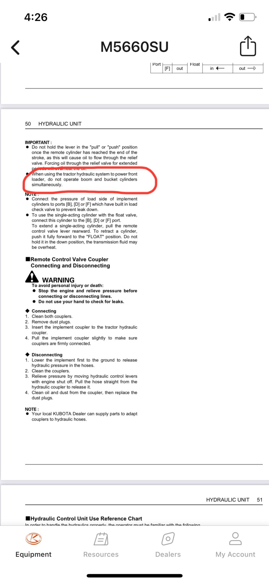

M5660 operation manual page 50 says don’t operate boom and bucket cylinders simultaneously.

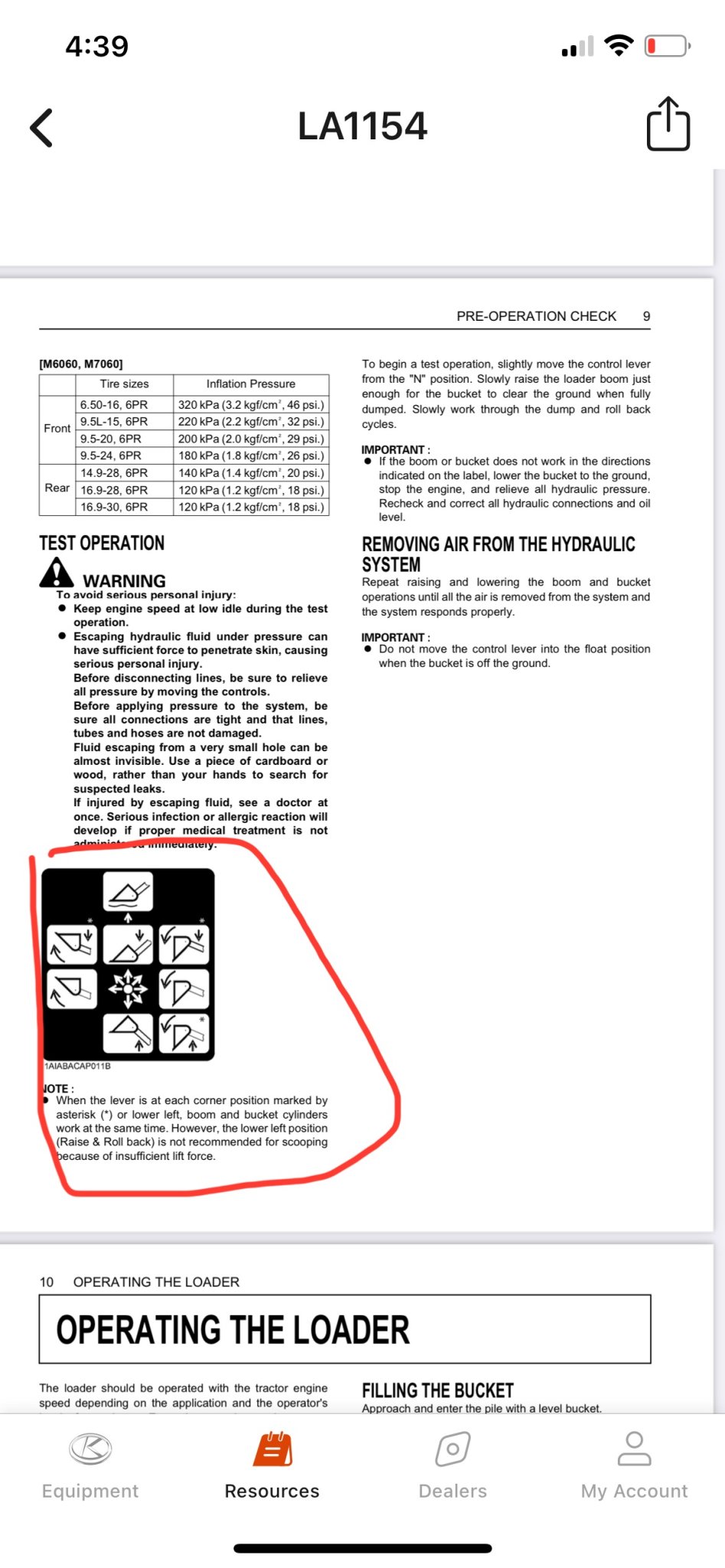

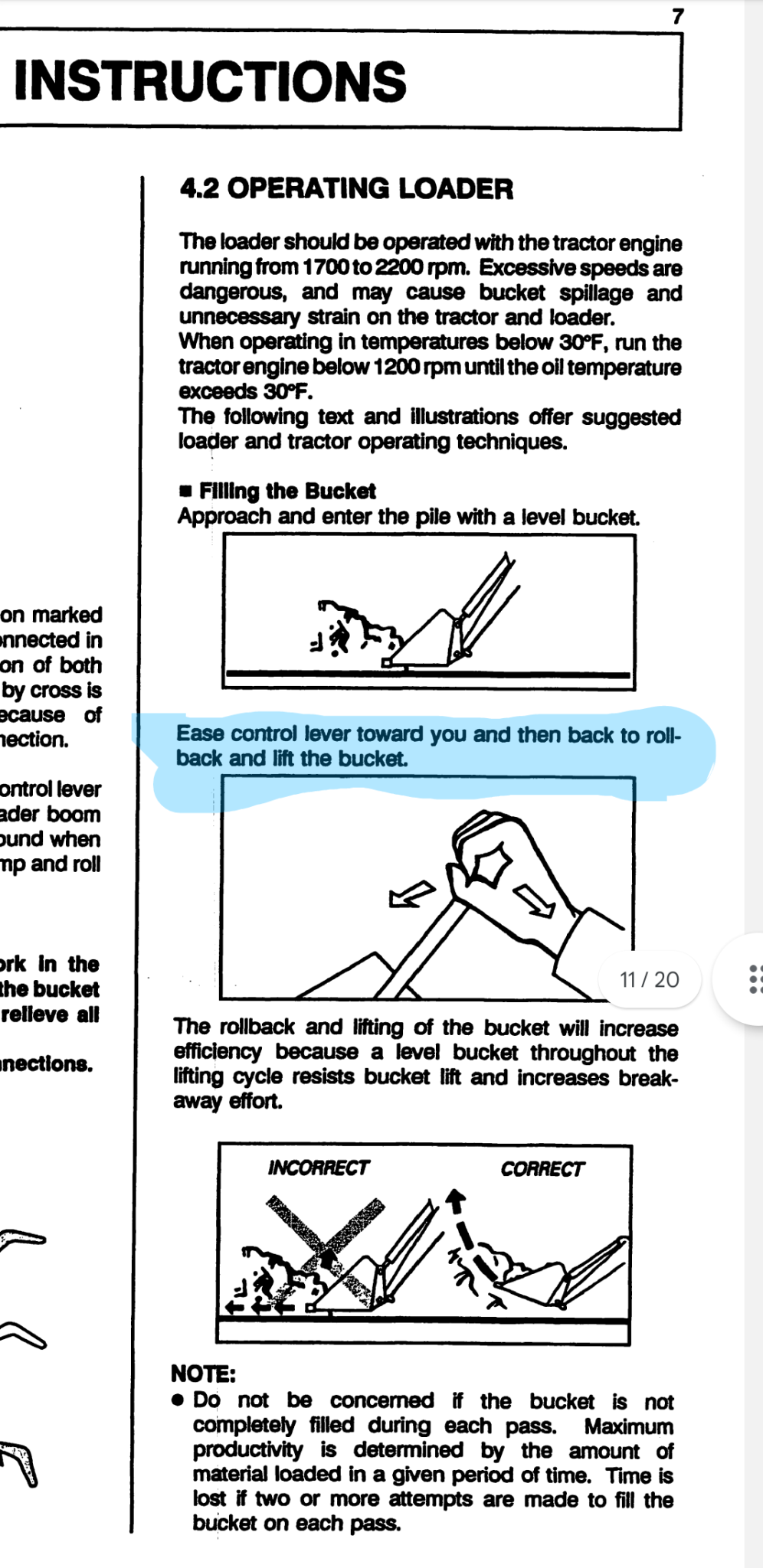

LA1154 loader operation manual page 9 indicates simultaneous operation is standard procedure.

You missed a word, it says "When using the tractor hydraulic to POWER front loader. do not operate boom and bucket cylinders simultaneously"
The bottom right is ONLY powering the up (releasing pressure from the curl). Says the same....
For the record, you can do both power up and curl - IF there is NOTHING in the bucket (or very light).

When doing power up and curl the output from the lift cylinder is supplying pressure to the curl cylinder and the load on the lift cylinder is the sum of boom and bucket loads. Both functions will stall when the inlet pressure at the lift cylinder hits the relief valve setting.

Notice the drawing near the bottom, (and circled in red) showing the decal has the bottom left position blanked out. That would be the up and up position and the instructions make an attempt to explain it.
9,489
4,968
I understand the operation fine. The lift and bucket cylinders are operating in series which means the two loads are additive. It works fine but you will get reduced force on both lift and curl.
Both operations will stall when the combined loads causes base end pressure on the lift cylinders to reach relief pressure.

In practical operation you can lift and curl simultaneously unless the load is pretty close to max. If you’re lift/curling and it stalls, it sometimes works to do the operations separately as that provides a bit more power for each function since the available power is dedicated to one function only. In my admittedly limited experience with only a few tractor loaders, the only time a lift/curl won’t work but a separate lift then curl will work is very near the max capacity of the loader, so not particularly common to make any practical difference.
Academically, an interesting discussion. In practice, not very impactful in my experience. YMMV.
