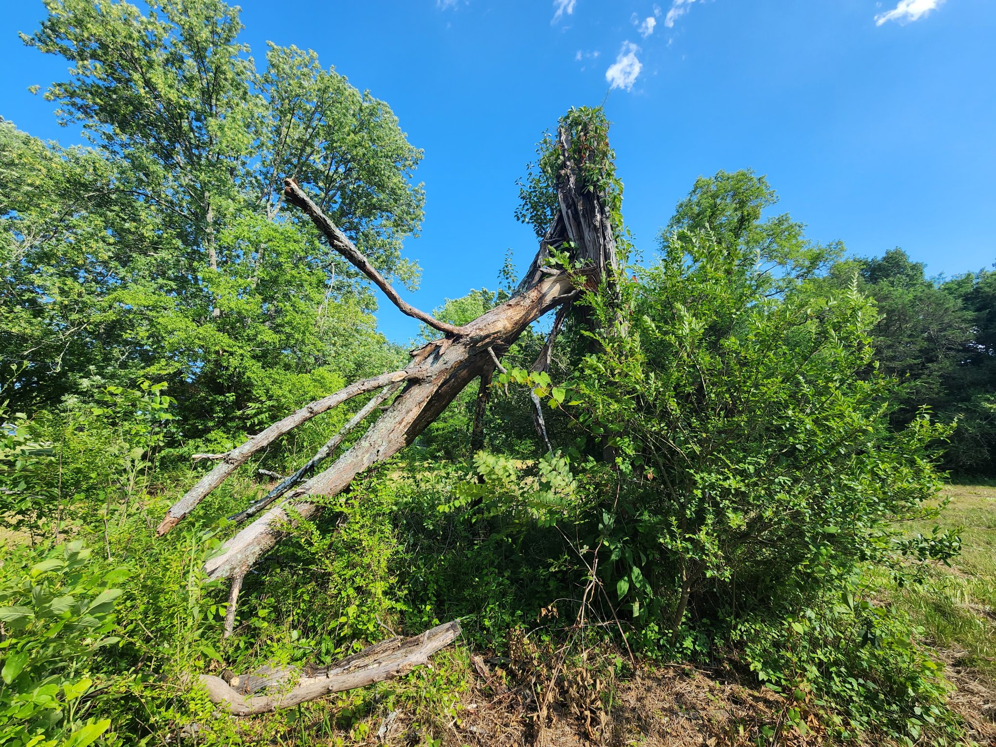

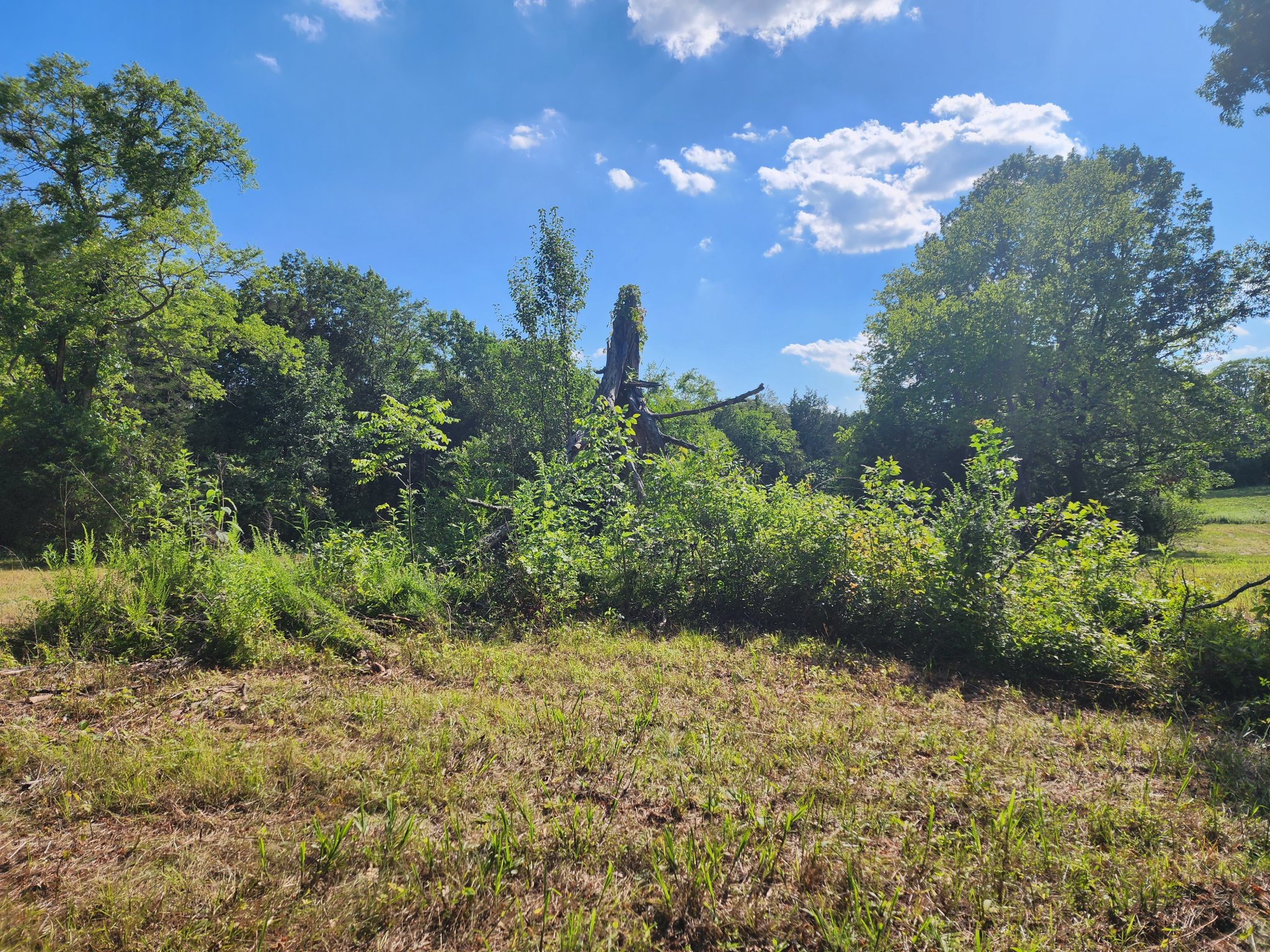

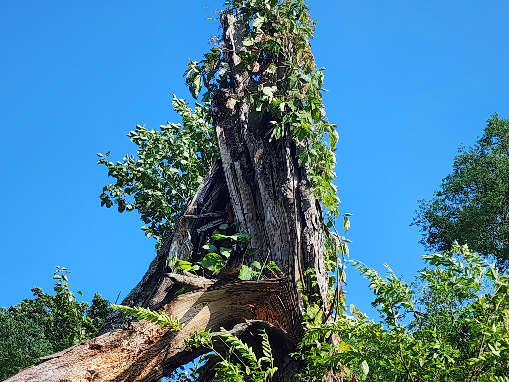

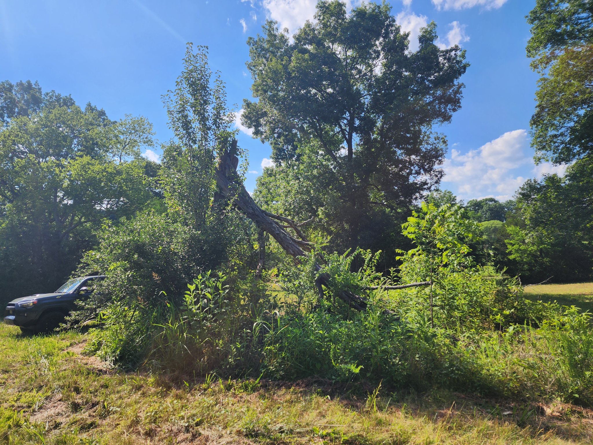

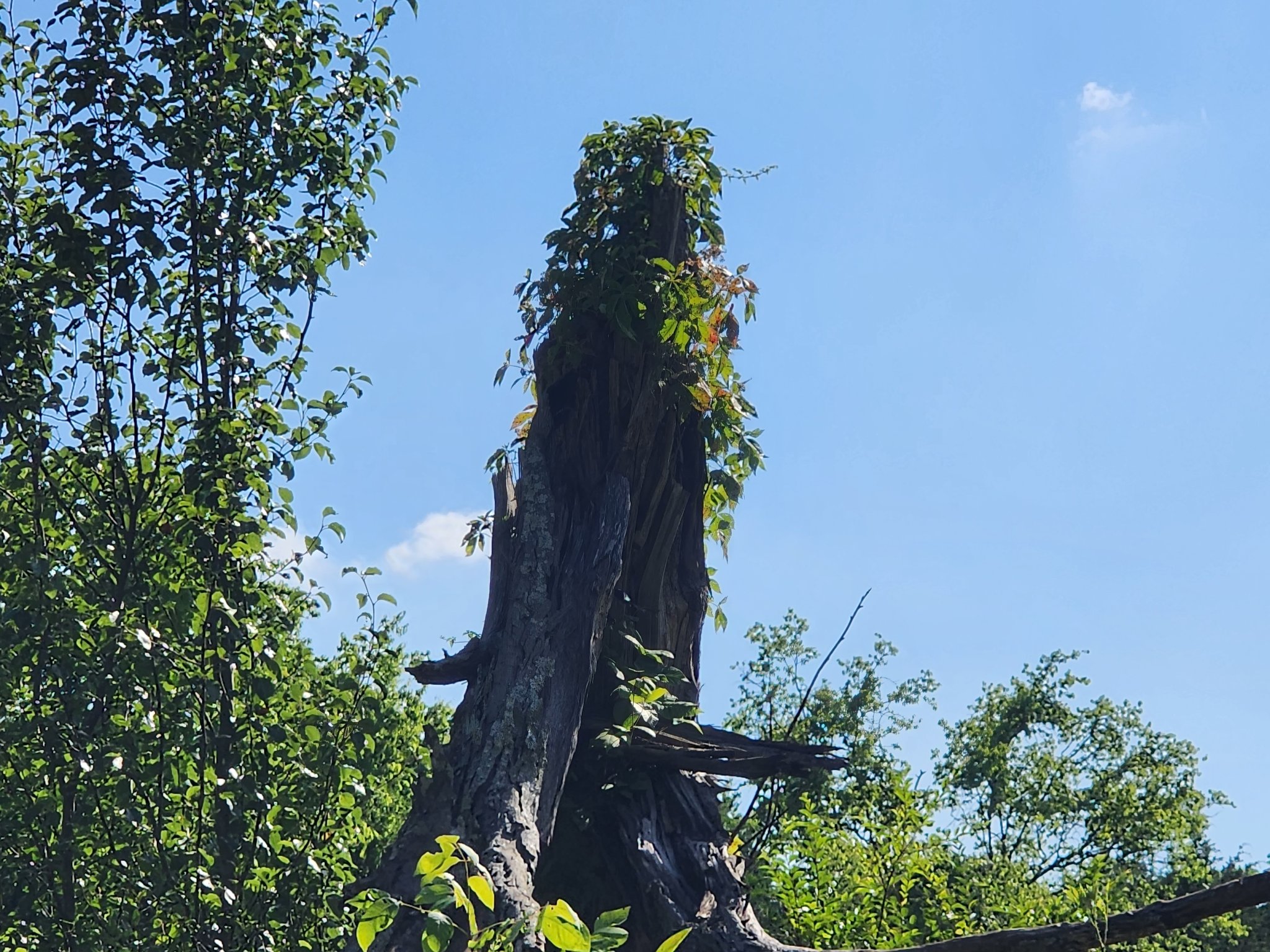

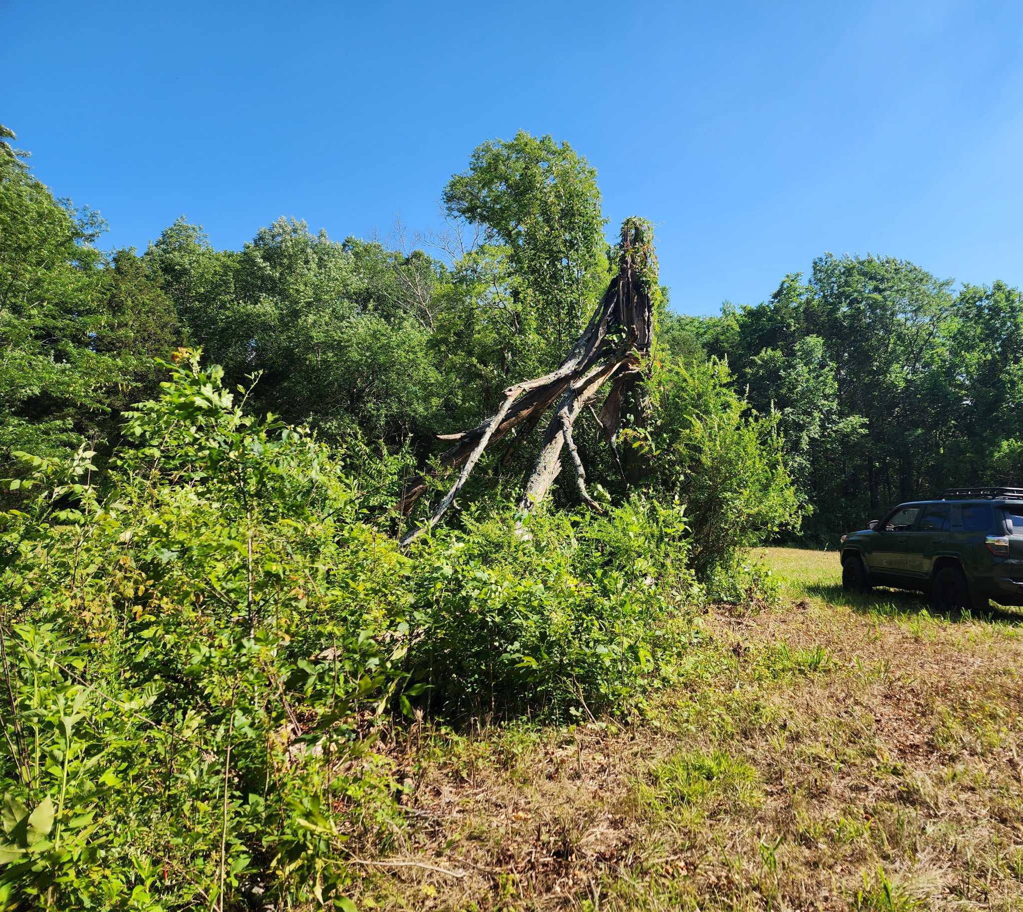

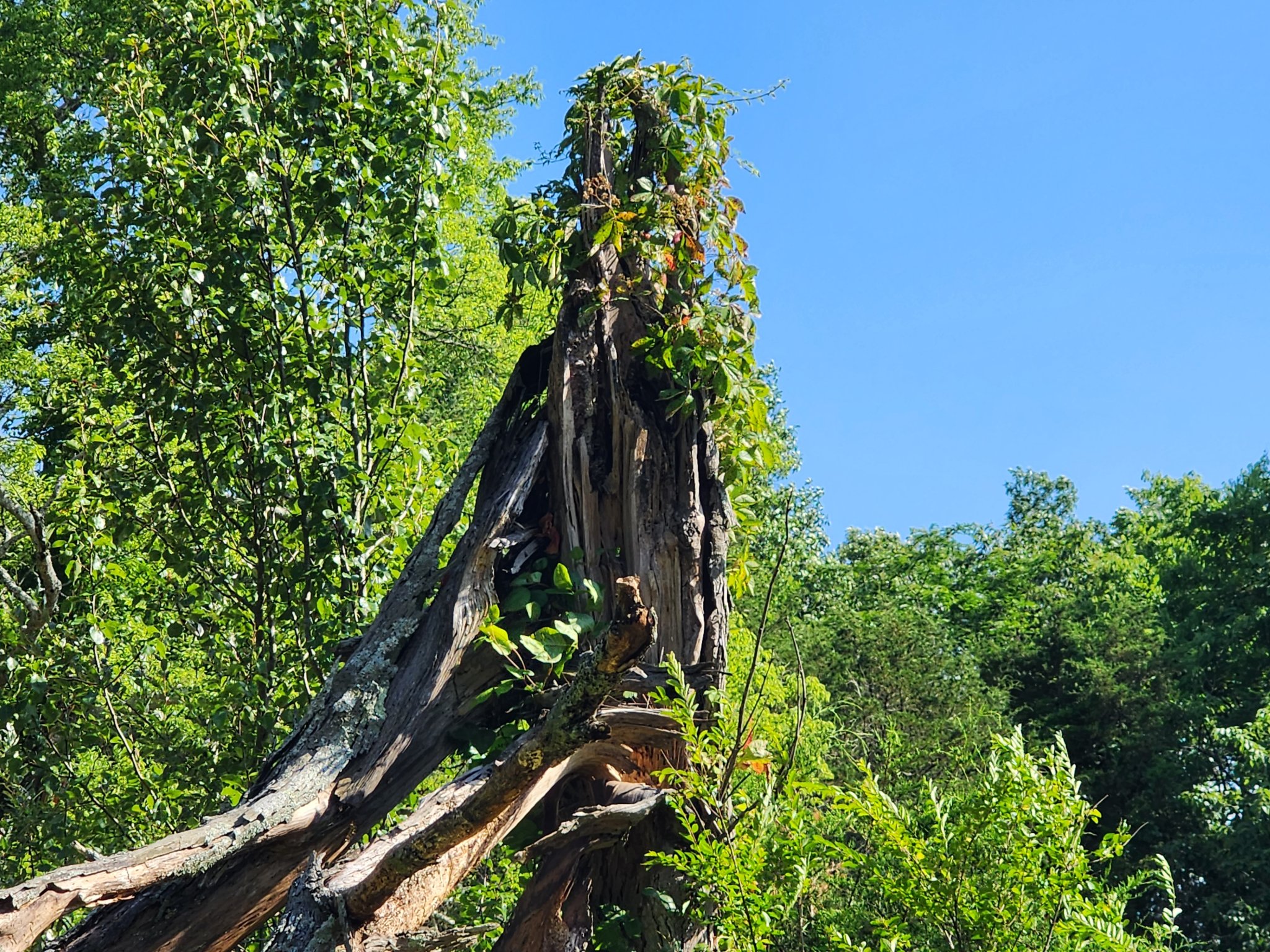

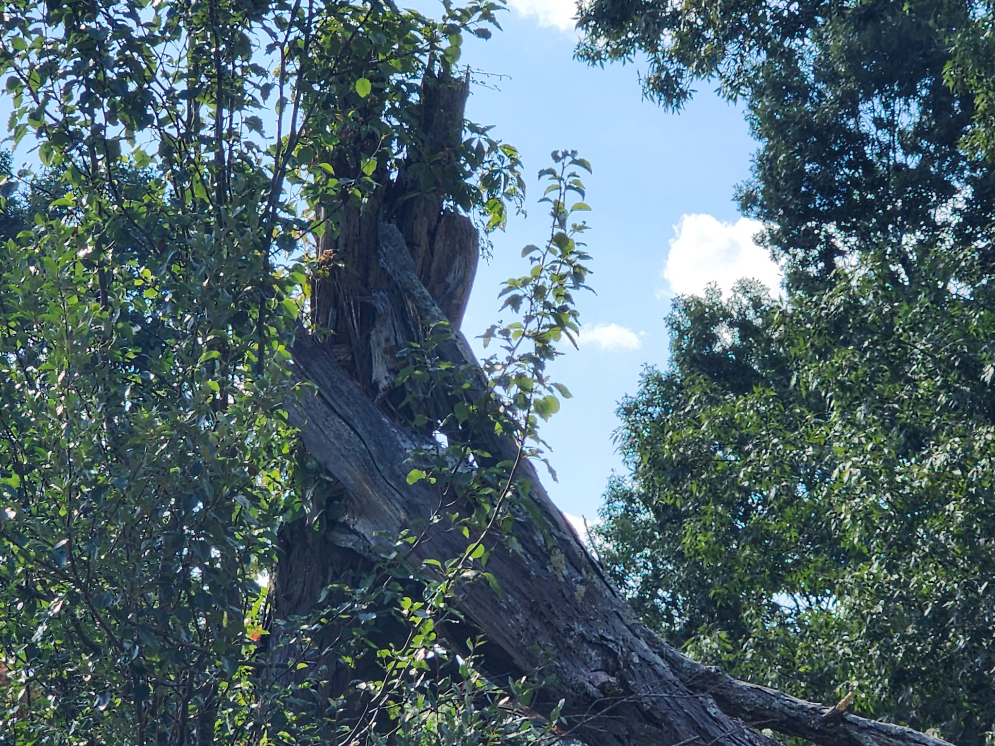

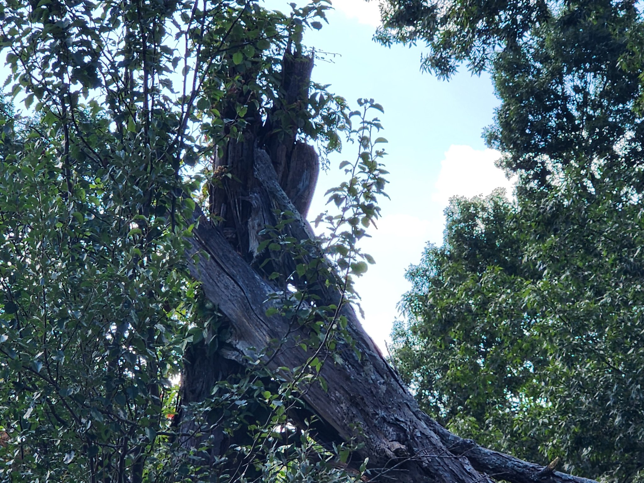

Ok so one week later, I finally got these pics. Looking closer, I can see the hinge is quite looser now, with two main trunk components trying to fall on what looks like either side of the main trunk.

Ok so one week later, I finally got these pics. Looking closer, I can see the hinge is quite looser now, with two main trunk components trying to fall on what looks like either side of the main trunk. View attachment 105964 View attachment 105965 View attachment 105966 View attachment 105967 View attachment 105968 View attachment 105969 View attachment 105970 View attachment 105971 View attachment 105972
Cakewalk.
Try pulling at 90° to the lay of the tree first. Should pop right off. If not more back towards the trunk.
I'd spend a little time clearing off the area right around the top first, and maybe cut any limbs jammed in the ground. Otherwise....just go for it, that's not a bad one.

If you have a snatch block, attach it to the broke tree. Then anchor one end of a line to another tree or stump go through the snatch block then to your pull vehicle. That will give you a mechanical advantage of 2 to 1. Follow Flintknappers advice and pull the broke tree at a 90 degree angle. Good snatch blocks are available at Tractor Supply.
Here’s a link on how to do it.
