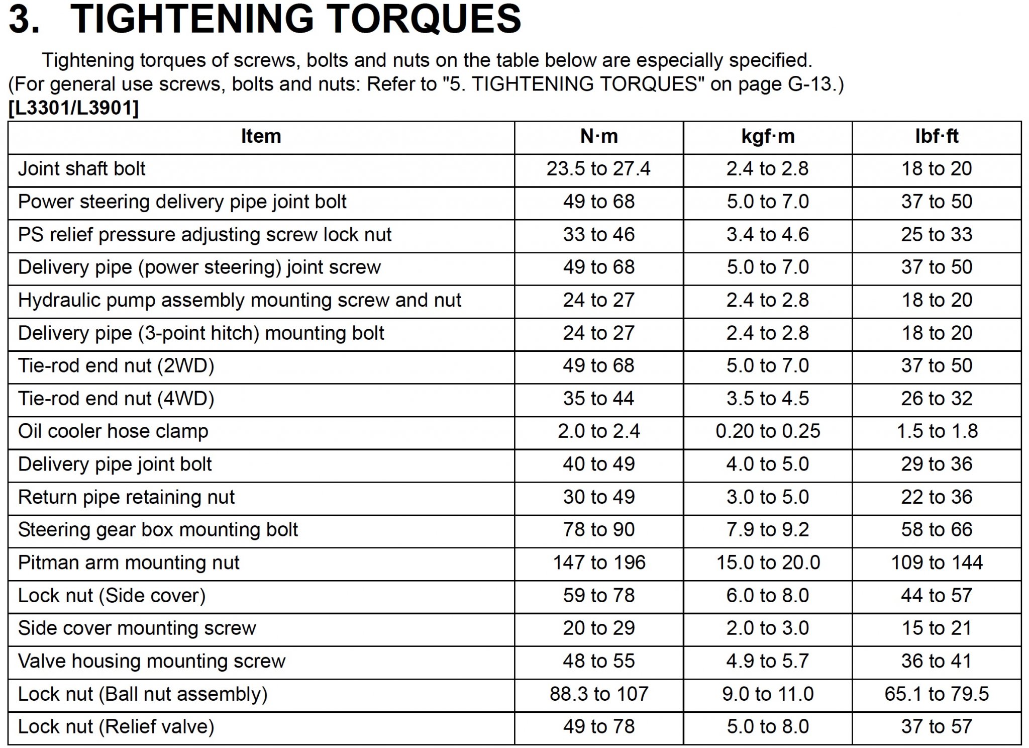

J Jhgr New member Equipment L. 3901 Aug 14, 2018 23 1 1 Cumming Ga. Sep 29, 2020 #1 Installed left steering arm on L3901 4 wheel drive. How tight do the ends to be tightened?
wgator Active member Equipment L4701HST, FEL and other stuff. Jul 28, 2018 482 147 43 NC Sep 29, 2020 #2 Below attachment is from WSM (available on Kubotabooks.com) for the steering parts. Attachments Steering torques.jpg 510.3 KB Views: 342
J Jhgr New member Equipment L. 3901 Aug 14, 2018 23 1 1 Cumming Ga. Sep 30, 2020 #3 wgator said: Below attachment is from WSM (available on Kubotabooks.com) for the steering parts. Click to expand... Thanks for the chart.
