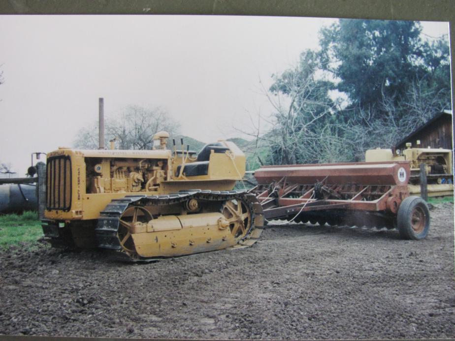

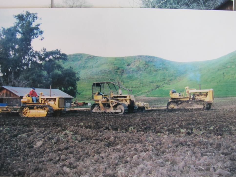

Looks like your doing a great repair job I have a L3830 also great tractor but I know what you mean by likeing it almost as much as you cat D4 .Here are a few old cats on our ranch. D2 5U series, D4 5U series and a D6 9U series

Nice dozers - glad to see I'm not the only one with the "equipment disease." Anyone else a member of ACMOC as well?:D
By the way, I discovered you can do a whole lot more unintentional damage much more quickly with a dozer than you can with a Kubota. I'll be replacing some fence this spring.:(
