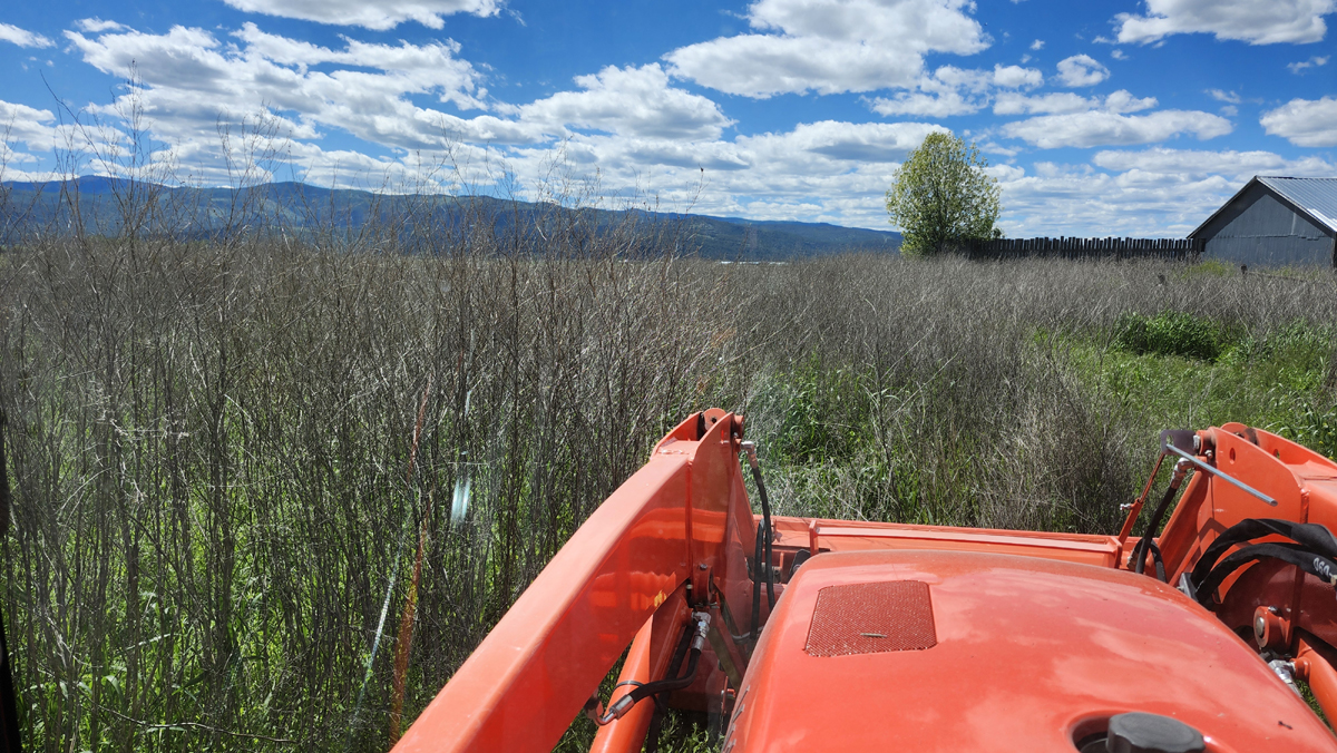

I have a 5ft flail, a 7ft rotary cutter and a 12ft folding cutter. Flails are smoother (less vibration), quieter from the operator's perspective, require less hp, put less stress on the PTO, are much more compact, and don't tend to get high centered on uneven ground due to the rear drum. Flails are also available as offset models, and some have hydraulic adjustment of the offset and even cutting head rotation. Hammers will cut a lawn better than well enough, but also mulch up 5ft of tall weeds or grass.
Flails are very popular in Europe whereas rotary cutters aren't. Perhaps that's because of the miles and miles of hedgerows that need to be cut each year. I have no plans to upgrade the rotary cutter or folding cutter, but another (bigger) flail for the M6060 is on my wish list.
Here's an example of one pass with the flail. A few more jobs like this and the flail will have paid for itself.
