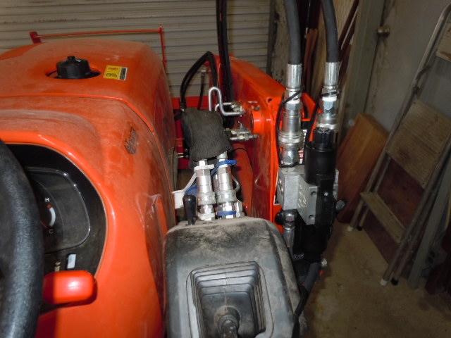

Hey everybody, been lurking & looking for a while—thanks for all the good info. While I have read several threads about adding top & tilt, I am still a bit confused. I just added a grapple for my FEL, with a 3rd function valve. I also want to add power back to another remote to power the TNT.
What is the best way to tap into the hydraulics for the TNT remote valve Assy.? It seems easiest to install tees into the power & return lines (and run one leg of each tee to the TNT remote) either before the FEL valve, or between the FEL valve and the 3rd function valve that I installed for the grapple. What am I missing here?

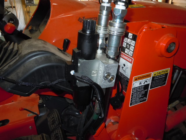

OK, you didn't mention the WR Long valve before (just said 3rd function)...and you didn't show the feed and return hoses in you pics.
But, find the OUT hose on the WRL valve, you will connect that to the IN of your new spool spool valve. Then the PB/BYD (power beyond) port of the new valve will connect to where you WRL hose in connected now. This puts the new valve in series with the flow. Now, just one more connection needs to be made, the OUT port of your new valve needs to connect back to the tranny case somewhere, if you look I'm sure you'll find a plugged port you can use. This takes the "waste oil" from the "work ports" on the new valve and sends it back to the tank to cool and get recirculated.

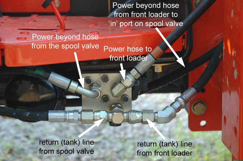

Assuming that this is going onto your L3301? The picture shows the best place to have the return to tank line run. Simply tee it into the existing return to tank line at the port.
Yes it is going on my L3301, but my pump assy does not look like your picture. I have at least one more line coming out of it, but I do get what you are saying--that it is OK to tee into return line, just not the power beyond 'pressure' line, as Kenny had said in earlier post.
This is the hydraulic block under the right side floor board. Yours has more than 3 ports??? :confused:
