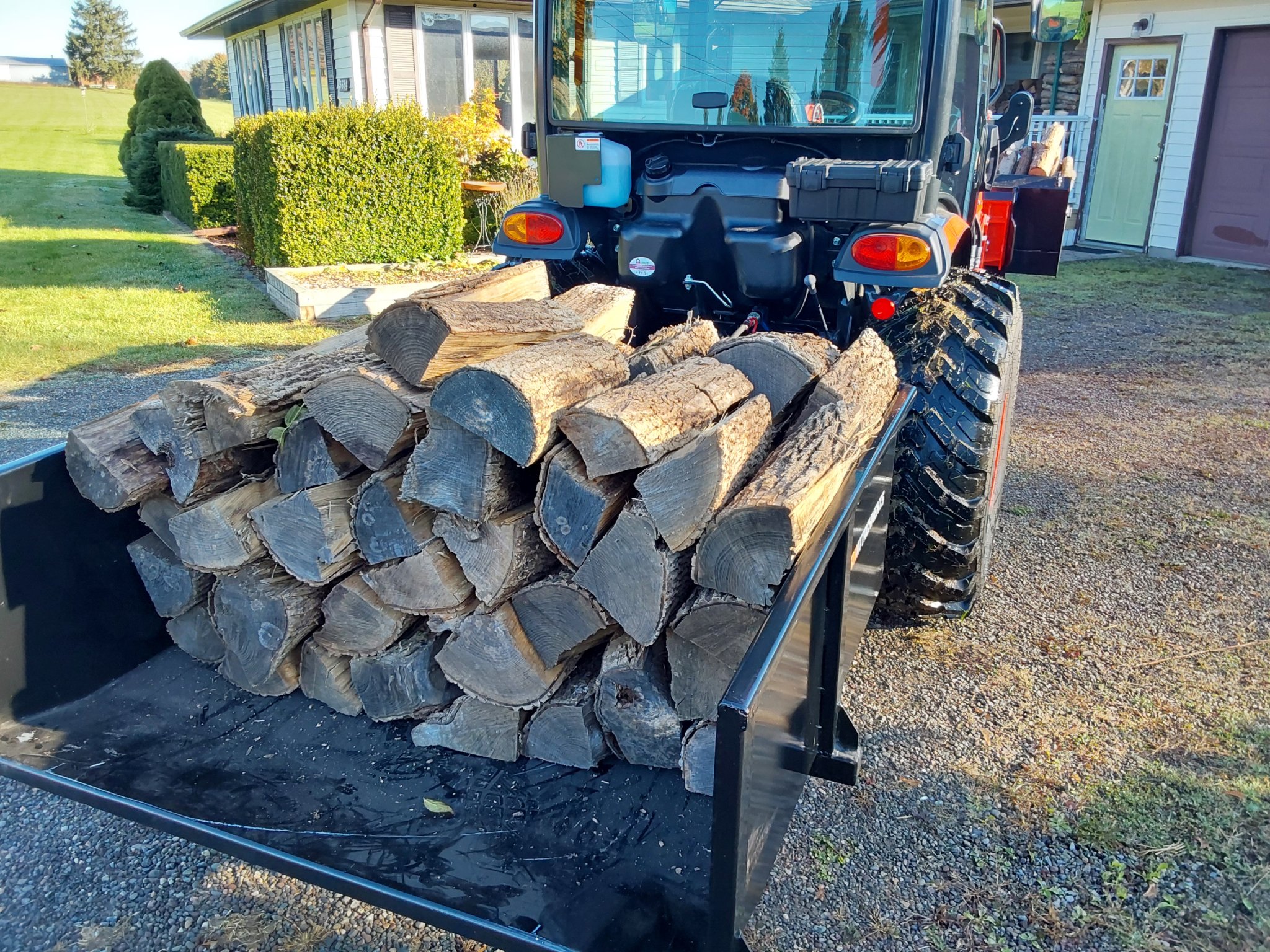

Well tried using it for firewood and what a back saver. Having adjustable height makes it easier on my back then the high RTV box height. Only put 2 rows in the first trip to be sure it doesn't affect handling. Couldn't tell the difference so I'll fill it full next load. This thing is overbuilt with all the extra reinforcing. Dumps fast for me and looking for some hose restrictors to smooth it out. Load the bucket also and what a smooth ride it gives me

Bought one of these and wanted to know about if your dump box tips with no hydraulic pressure applied. If it is disconnected from the tractor I can tip the box about 30 degrees. I can connect the hydraulic lines with the same result. When I pressurize the lines it lifts and drops the box normally. Do you see the same ability to tip the box when the lines aren't hooked up or pressurized? Thanks.

Never tried that. I always set it on a cart when removed. Ag style couplers usually bleed off pressure when disconnected and I can see how that could happen. When on the tractor I always have it connected to the remote and it's solid. I think flat face couplers hold the pressure when disconnected and may help if you're using it disconnected from the remote. Here's the boat cart I bought for storing it

The reason I brought this up was the first time I used it to carry heavy wood blocks right to the back edge of the box it dumped the whole load out while transporting up a hill. The hydraulic lines were hooked up to the tractor but I don't remember if I cycled the dump box up and down. I tried once more and it did the same thing, this time I was sure I cycled the dump box to get pressure in the lines. It almost seemed like a pressure relief valve was activated. Haven't used it since for this job but I just tried bouncing my weight on the back of the box after cycling the hydraulics and it seemed rigid. Maybe if fixed itself but I'm done cutting wood til fall so I'll test it again then. It was real handy loading it with large blocks I can't handle getting into a higher trailer. The bucket doesn't hold much so with both the box and bucket loaded I can transport a larger amount of large blocks at a time.

I would try another remote or flip the lines . If it was fairly new, I wonder if air could have been trapped in the lines. I haven't had that happen, but I have never had a load hanging out either.

I contacted Titan about this issue and they guess that the hydraulic cylinder has some bad seals. They are sending me a replacement cylinder and hoses under warranty. I've read some instances of bad support from Titan but that is not the case with me.
