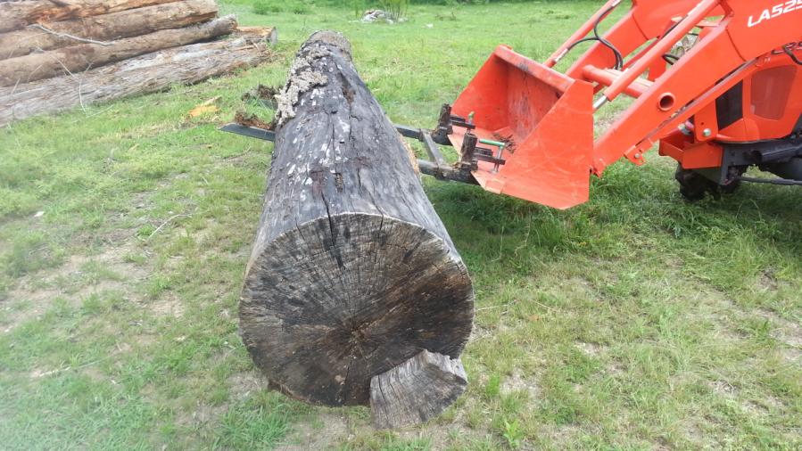

Mulga
I hear several on here talking about the clamp on forks but I'm thrilled with mine. I used the chains for a while and they actually started bending the bucket lip up so I quit the chains and the bucket has straightened out and hasn't bent since. they're stronger than my L3901 as I've tried to pick up or lift the tips of the forks and stall the hydraulics with no problems. With my Titan 1500# forks if the tractor will lift it the forks and bucket have handled it.
