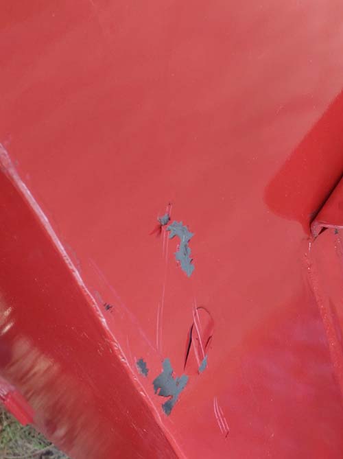

My ballast box arrived with a few paint dings and scratches. Not surprising for taking 132 lbs of steel wrapped in cardboard that manhandled on and off the FedEx Ground truck then up to my door.
Probably will paint mine Kubota orange this summer.
