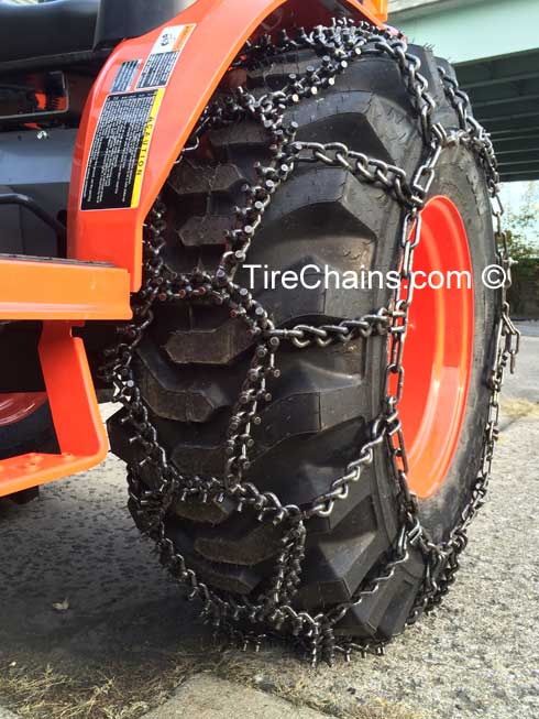

Obviously I’m no expert on tire chains but for a picture of something that doesn’t mostly fall between the lugs, this is the general type of chain configuration I was looking into.
Just looking at them they don’t look like the would fall in between the tire cleats. The also look like they’d shred asphalt but we don’t have pavement so that’s not an issue.

GREAT for traction but do not go near asphalt or concrete.

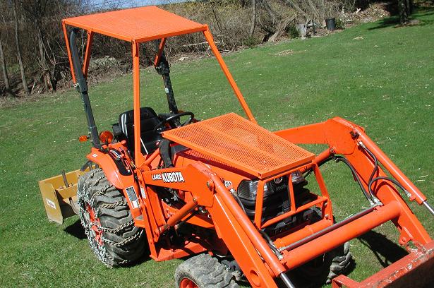

They are not on the tractor now, but could you explain further how chains like this would be properly fitted? They were quite tight, and I was using the spring type tensioners. To get the springs on I had to use a pipe through the center circle, with the end over a lug nut (for leverage), to be able to get the springs installed.
I can’t imagine how I could’ve made them tighter without using some kind of mechanical turnbuckle set up in place of .the springs.
How would one fit ladder chains to prevent them from slipping off the R4 lugs and into the grooves during use? Seems like it would be near impossible for me to accomplish.
Please give further details as it would be helpful if/when I put the chains back on. Likely helpful to others as well.

The chains as installed appear to be too large for the tires, both width and (hard to see) length.
The cross links should end near the base of the lugs, well away from the rims. Perhaps you can rectify this by removing some length from the circumferential chains (perhaps a cross link or two also, but cannot tell), perhaps not. DO NOT cut chains before test fitting at least once and preferably twice.
I have rarely (never?) bought a set of tractor tire chains that did not need modification, sometimes major modification, upon initial installation. Manufacturers manufacture tire chains to fit multiple tire sizes so compromises are (almost) inevitable.
This is why initial installation is critical and why I stated in a previous post that one would struggle upon fitting/initial installation.
Recently, I spent about four hours fitting and initially installing a set of rear (perhaps one hour for fronts) tire chains for my B3350 but the effort was time well spent.
The chains now fit very tightly, do not move regardless of load, do not contact the fenders, do not ride into the tire grooves (much) except near the tire edges, and cannot be installed loosely because I have removed excess length. They are simply too short to be installed loosely.
Subsequent installations can be done in about one hour. Yes, I find it necessary to attempt to lock the circumferential chain ratchets multiple times as I repetitively move side chains about to gain length and I do lie on the ground while doinig this. One should expect to spend more time to install tire chains on larger tires for multiple reasons, especially the weight of the chains.
If one expects to install tractor tire chains quickly, even for a B2650/3350 sized tire, one should not expect to achieve proper fit/installation and one should expect the need of tensioners, etc.
