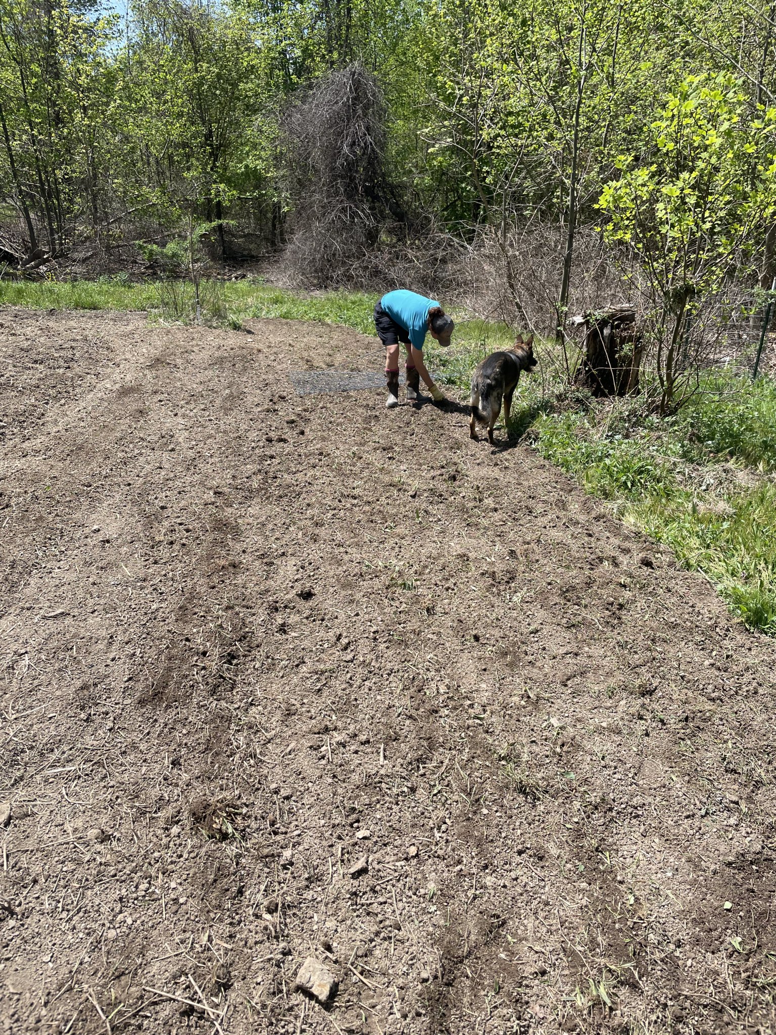

Good day I have a reverse rotation rear tine tiller and I am not sure I can help…I am not sure I really understand the OP and the configuration of the tines and rotation / reversible-I am just not understanding or familiar with your equip…if I understood you have ‘reverse tine’…to me that means the tines are behind, correct? Then also it said ‘tiller is reversible’…I am not sure what you mean there…is that spins either way? What I can say is that my reverse rotation tiller that mounts on my three point does t see to do what you describe bed, but I would say though that if tilling unbroken ground with vegetation for first time, it will leave plant debris and more problematic and t will leave some clods…you can either till it many times to try to chop up the clods/debris (may be less than ideal for your soil though) I suspect no matter what you do there will be clods, or you could try to scrape or bush hog off the plant debris off before tilling. The pic below was unbroken ground and after two passes it looked like below…certainly not a perfect seedbed as it left some clods. We ended up picking up the largest of clods to make a little easier to run our walk behind seeder…if not for using a walk behind seeder I would have left the clods, but they clogged it up. Anyway I think a reverse rotation works fine considering there was vegation on prior to the tilling. I am not sure that makes sense or not to what you described above and your result?

My seedbed looked quite a bit worse than yours. I would be happy with what you have pictured there.
