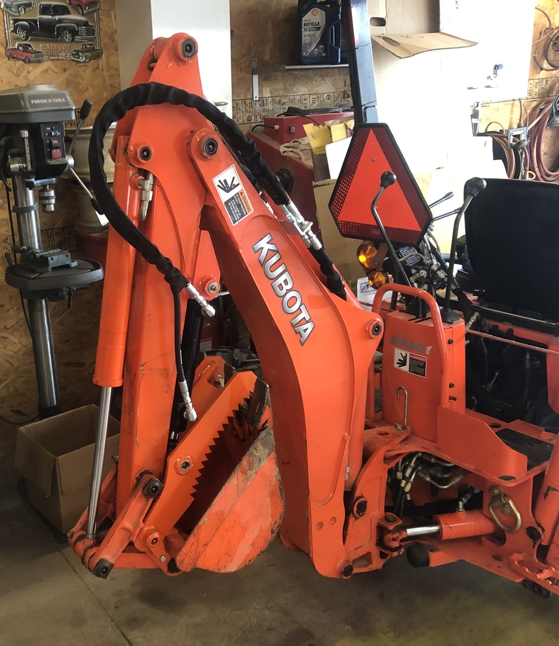

I had a manual thumb on my BX24. I sold it and built a hydraulic thumb that is way more user friendly. Any thumb is still better than no thumb.

I had a manual thumb on my BX24. I sold it and built a hydraulic thumb that is way more user friendly. Any thumb is still better than no thumb. View attachment 73007
Nice job! You've incorporated a couple of things I like. First, I think the best pivot point is at the bucket pivot, by using a longer pin. But that requires a custom fit on pin size and span across the bucket. The Titan I bought is a universal fit, so there is some compromise there.
Also your cylinder geometry allows the thumb to fold back far enough to be out of the way when digging (mostly). Titan makes a hydraulic version of their thumb, but it just replaced the third leg with a short cylinder. When fully retracted, the thumb still sticks out at nearly 90° so it's in the way for digging.
I'm curious. Do you have a pressure relief on your thumb hydraulics? It looks like you're using one of your remotes. Seems like some folks are concerned with over pressuring the thumb if they curl the bucket too hard, and vice versa.

The thumb is controlled by my homemade remotes valve. The valve doesn’t have a relief valve. The thumb has more power than the bucket curl so I always curl the bucket against the thumb and never the thumb against the bucket.

Here’s my thumb build thread. Lots more pictures.
