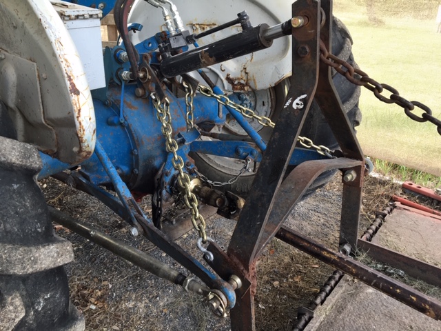

I shred some pretty rough areas. Never had a problem with the shredder, an old Bush Hog Squealer. It came with a chain running from the rear to near the top link. This allows it to float up quicker than the way newer shredders are built. Also added check chains to keep the deck at a constant level since old tractors are prone not to hold it for me.

I am not disagreeing with you but could you explain in more detail what you mean by you statement. The picture would seam to work nicely at preventing the hog from dropping at the front end and the chain would allow the the flex in the top link to prevent damage.
