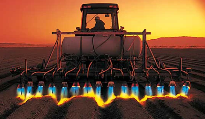

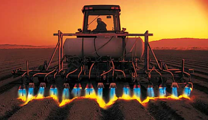

old time farmer here.
how about a propane weed burner?
the vinegar mix thingy is an interesting one. Its very common talk in our coffee shop with a lot of garden women claim its fantastic at killing the weeds. Vinager et all will / may kill what it contact with by speeding up dehydration/dry down by stripping off protective covering but will not kill what it doesn't touch (like roots) (its a contact thing) but some salts have beneficial benefits to plants (think fertilizer value), and some soaps contain potassium which again is a fertilizer.
So the women wonder why the plant looks dead but comes back to life with a vengeance.
I would vote an ag. propane weed burner if the generally accepted tried and true methods are not acceptable

Several to respond too.
The suggestions of the vinegar mix and the weed burner. Ive thought of both alot Im pretty certain both will cause extra corrosion of the fence. Not 100% what temps hurt galvanization but any fence comes out of campfire is suddenly rusty.

steam shouldn't hurt the fence...kinda same as rain water... tossing galv steel in fire is a bad thing ! shouldn't do that or weld, as fumes are toxic. tossed in fire, fire burns off the zinc(galv) leaves bare steel which will rust.
