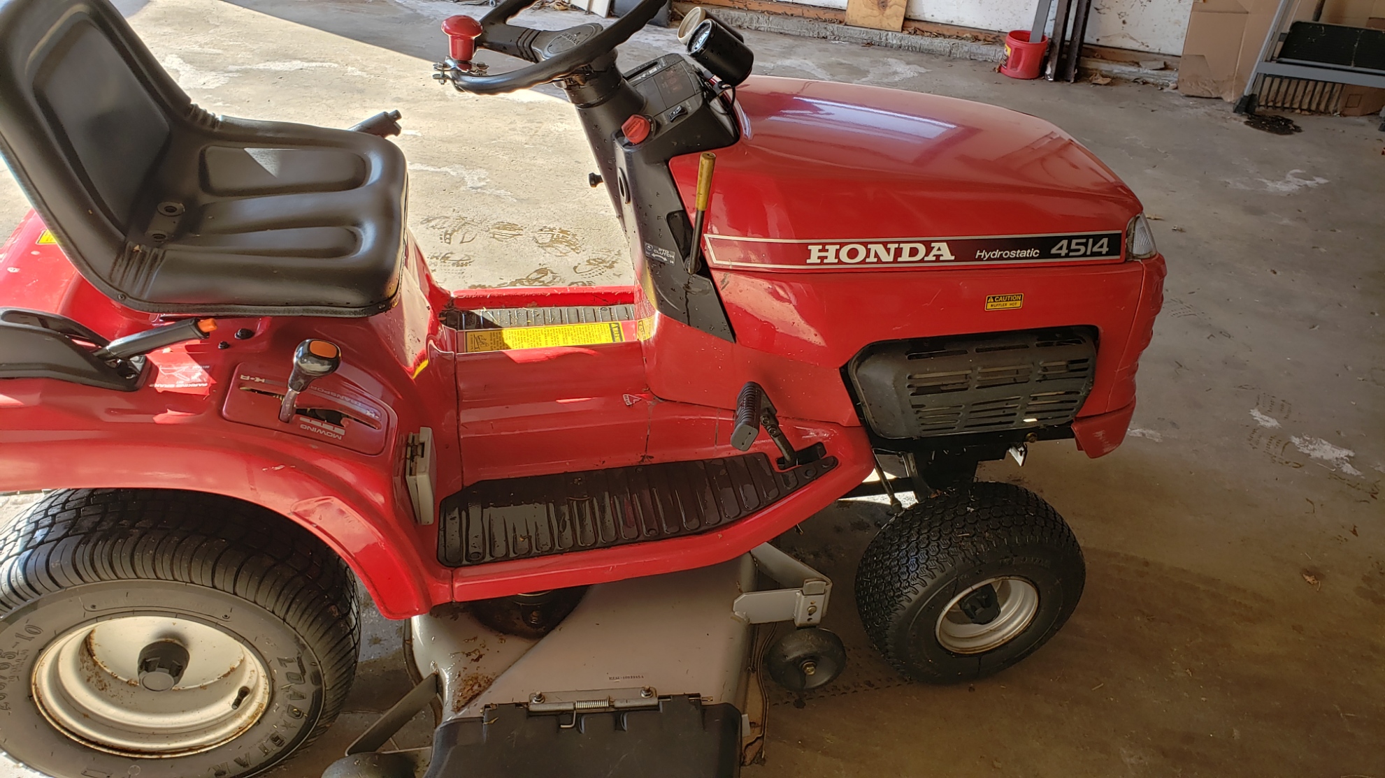

They're actually pretty sweet little machines. I really do regret not keeping it sometimes. I really love the Kubota and the "music" that little diesel makes (sounds like a mini Cummins :D) but using that huge 60" deck in my front yards is like trying to use the Queen Mary on a small lake :D The little Honda with the 42" deck was perfect. Tight radius and smaller deck worked great on the front. Blades were outrageously expensive. I can buy a whole set of new blades for my Kubota for the cost of one blade for the Honda! But, yeah sweet little machines
A couple photos of my Honda also showing my oil pressure and tach setup

Sweet. This was after the engine repair on the 14. Both the 14 & 18 have new paint.
And before the other two 18’s were added.
