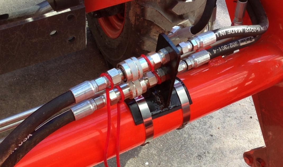

Got some hose brackets made up yesterday and mounted. A little scrap 16 ga metal bent for the base, a 3/16 piece with holes to mount the bulkhead fittings in and a small piece of rubber with 2 hose clamps.
It is much more rigid than I first thought it would be. Helps keep my hoses off the ground and the fitting from rubbing the paint off the loader cross tube.
I've got another one mounted on the loader mount under the floor board for when I remove the loader.
