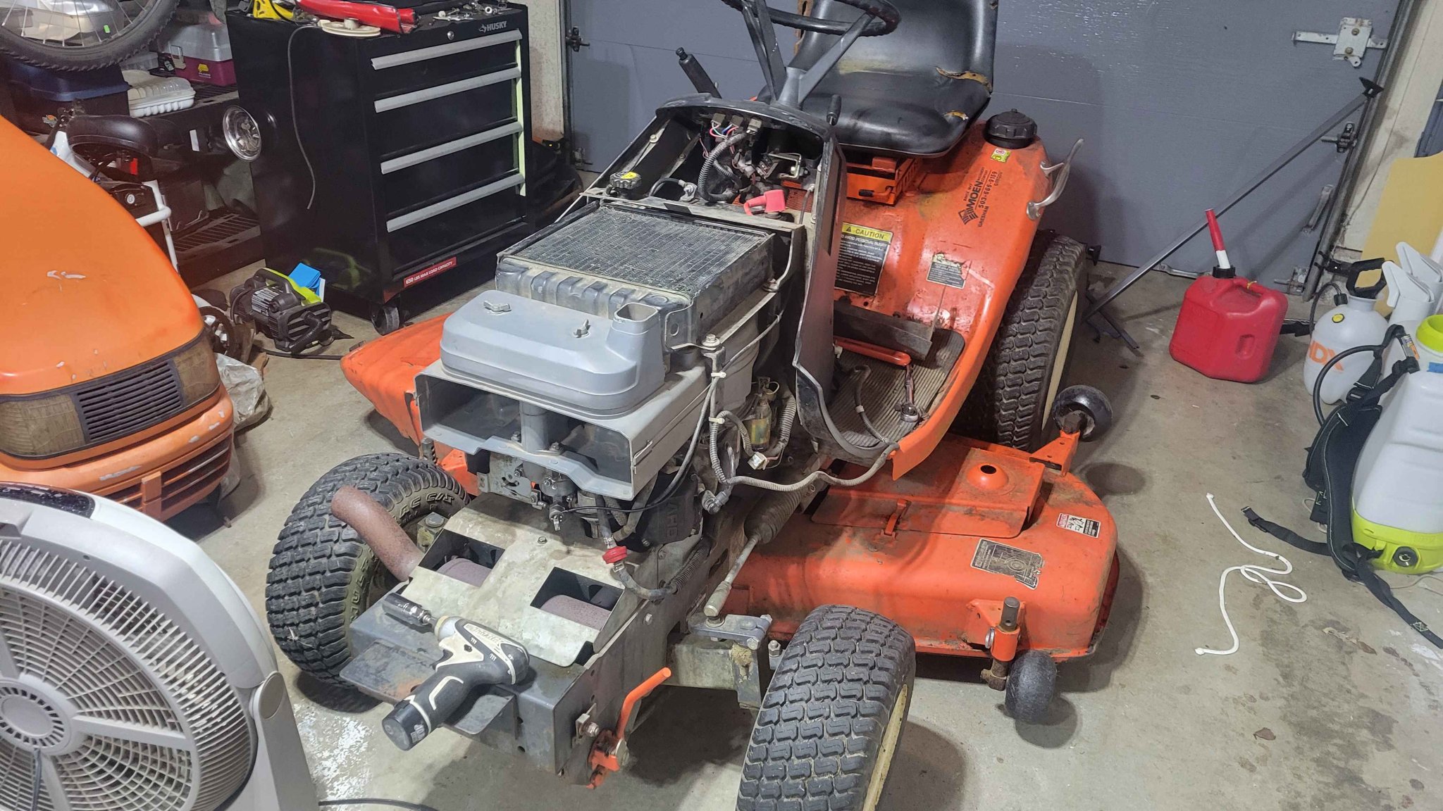

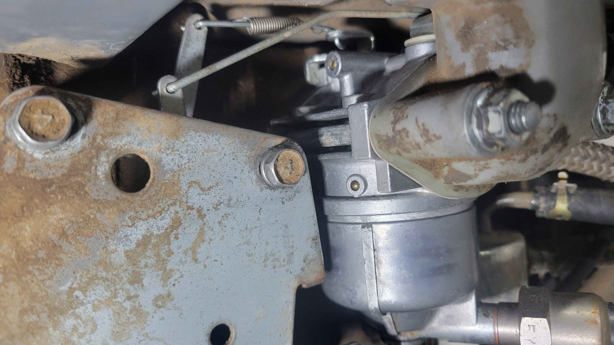

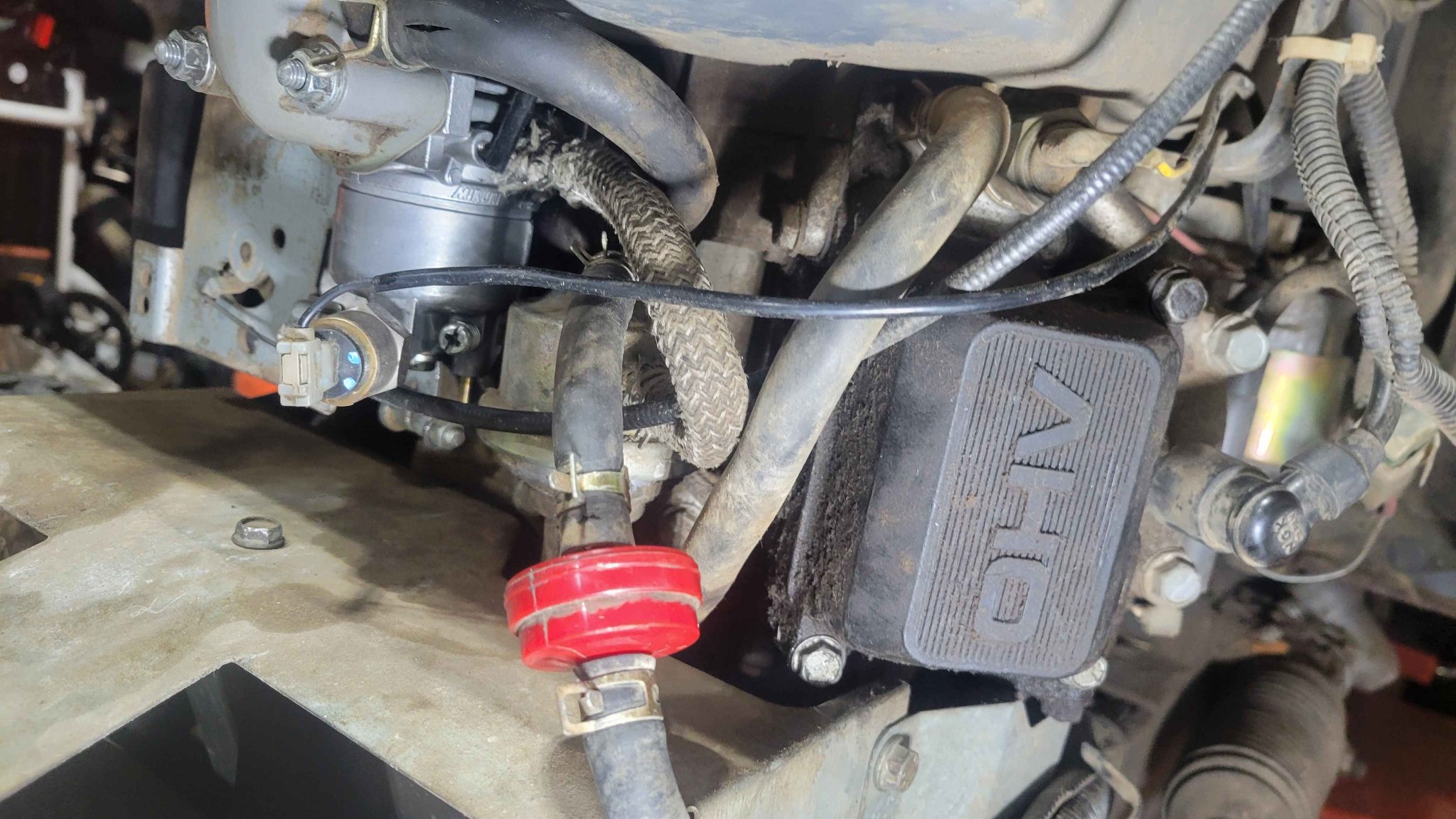

A couple days ago it was working completely fine and idling after I cleaned the carb. Fast forward a few days and now it runs horrible. I have removed the carb some 5 or 6 times to reclean and make sure I haven't missed something and made sure I didn't mess up something with the governor. I checked for spark on both sides and both show good clean spark with both cylinders being able to run without the other, smoother even (with roughness from being down a cylinder). Valves were adjusted in case that was an issue. Fuel tank was drained and lightly refilled. Is this a fuel issue of some sort? I am getting a new carb to see if it does anything but I am really starting to think its a fuel pump issue with this FD590V-ES08. The idle is different to surging, more inconsistent but jumps less. It has split inconsistent moments where it cuts off and then revs back up, but it dies at the bottom of its idle and is about 500 RPM below its specified maximum rev. Any help?

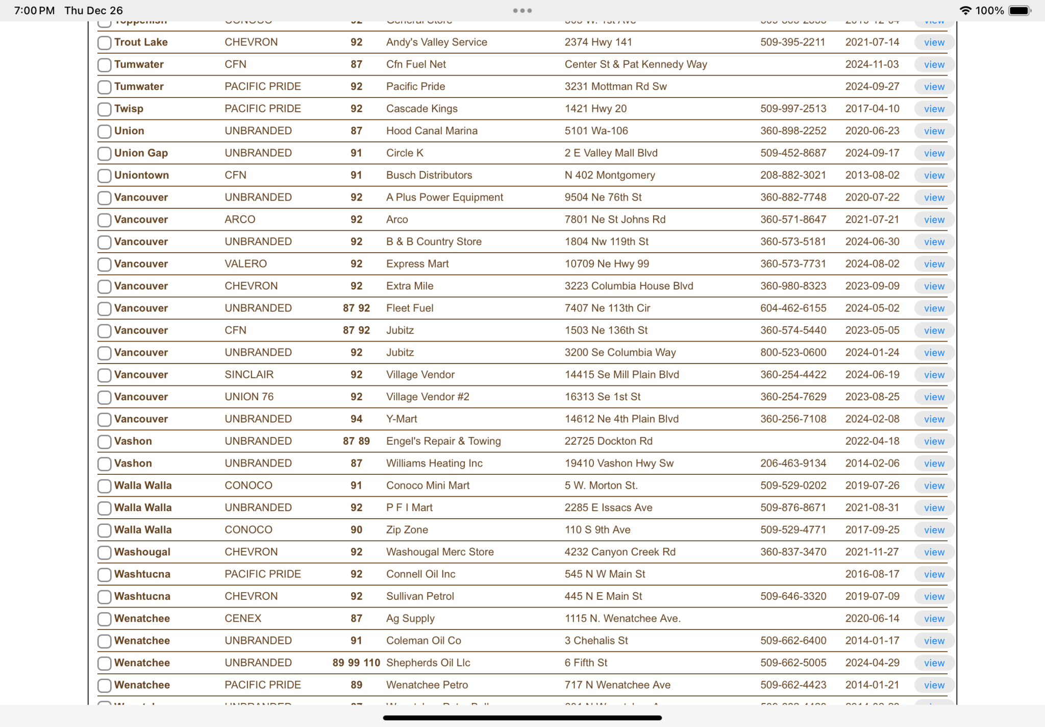

Looking at this site
I located some in your city
I would drain the fuel you have out, get a couple of gallons of pure gasoline into a clean container and see if it will clear the issue and post back the results.

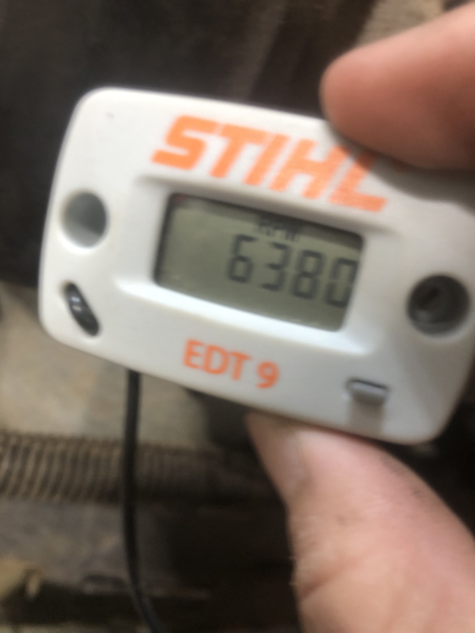

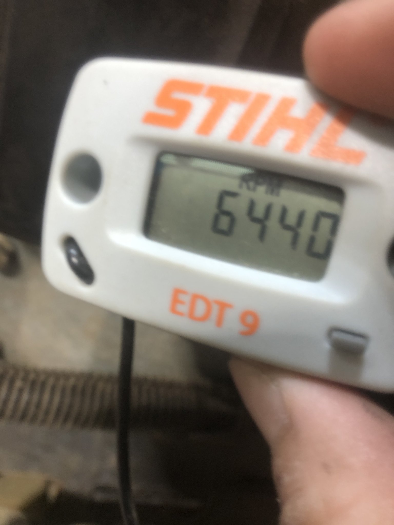

It has been idling for about 30 minutes and it does seem to have minor my smoothen out it’s rpm but I am still missing 500 RPM at the top and it still has tiny moments of its RPM cutting. Any idea why it may be?
Actual RPM is half of the tach. Don’t have the proper tool for this job so making do with what I have.

It has been idling for about 30 minutes and it does seem to have minor my smoothen out it’s rpm but I am still missing 500 RPM at the top and it still has tiny moments of its RPM cutting. Any idea why it may be? View attachment 144968 View attachment 144967
One thing I have done with it idling is to take off the air cleaner and then put my thumb over the carb inlet to make it pull a vacuum. This sometimes clears out the little jets. YMMV

As far as I am aware, this Mikuni carb doesn’t have a rebuild kit available for it. I used drill bits and cleaned out the jet holes for all the jets (to my knowledge) and the float is in good condition. Not sure how it would look in bad condition.

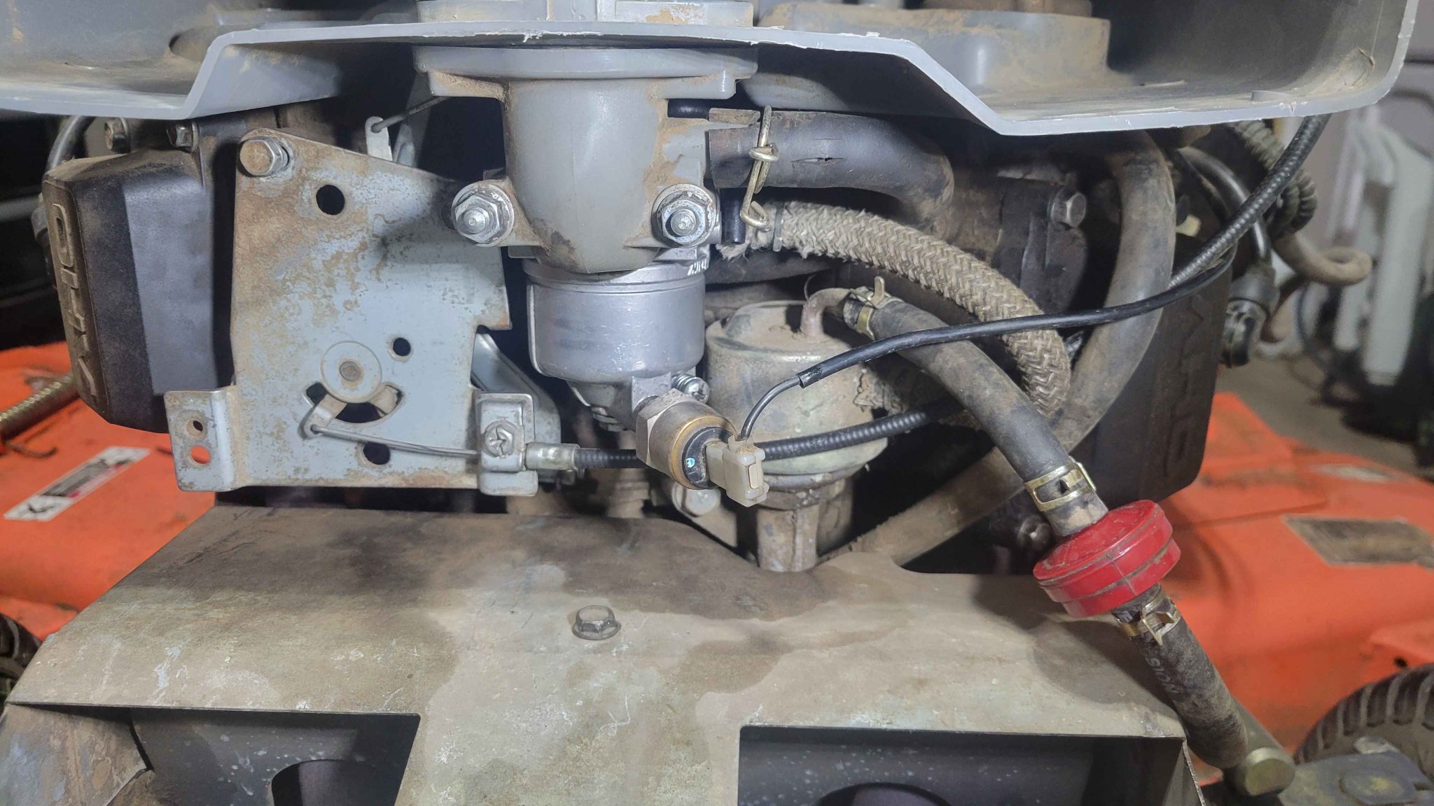

1) fuel line will get 'coated' with 'varnish' over time. Lousy gas today breaks down fast. bits stick to inner wall, break off, carb 'troubles'.
2) if the solenoid at carb bowl is the 'anti-dieselling valve' ,it needs to be tore apart and cleaned. again 'varnish' builds up... carb 'troubles'..
3) how old is the machine? that gas varnish builds up in the tank as well.....
4) replace the cheapy red B&S filter with a clear one ! That way YOU can see the condition of the gas.
When clients come with 'carb troubles', I start at the tank and work towards the carb. If they complain, they're shown the road. I haven't cleaned/rebuilt newer carbs in years as <$50 gets you a new one and is cheaper/faster to replace than the one that's on the beastie.

I do intend to add a clear paper filter in the coming future and I have a chinese carb on the way. I will also look into cleaning that solenoid once more. Machine is at least 20 years old.
