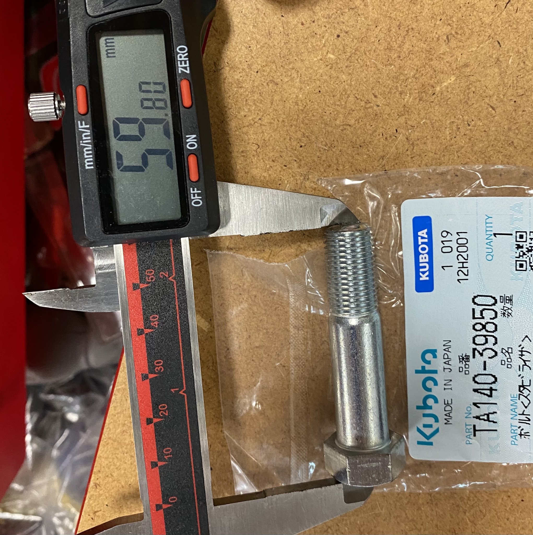

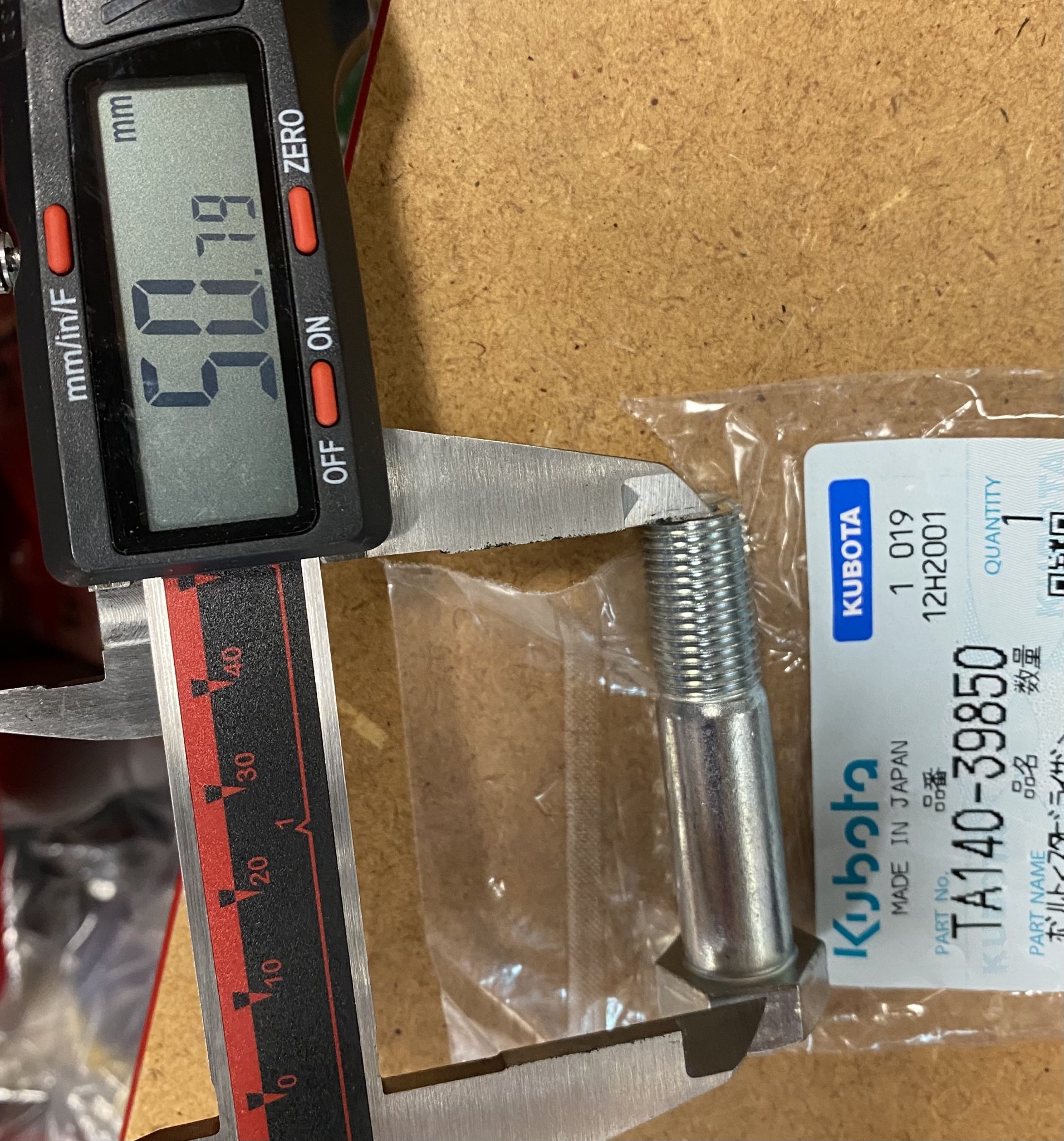

Hi.
I installed the stabilizer kit ( Part # L8430) this weekend on my L2501. I meant to remove the lower bolt and nut (the one that attaches to the frame) from one of the side links so I could bring it into town and replace them with a pin / R clip for faster install and removal. Anyone know the length and size that I need offhand?
Thank you.
Denis

If it’s the bolt you’re referring to (see Messicks exploded parts diagram):
