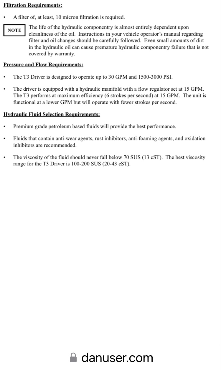

That’s a pretty neat T post driver. A bit spendy. Looks like it has a hydro motor that lifts the ram and compresses a spring which releases imparting 40 ft-lbs of energy with each blow.
Specs say at 15 gpm it will do 6 blows per second and slower with lessor flow. That seems crazy fast to me. The T post would always be moving, almost like being vibrated into the ground. I’m think it’d penetrate some serious hard ground to the point the strength of the T post would likely dictate what could be penetrated.
Here’s the specs:
Danuser T3 T Post Driver Manual
