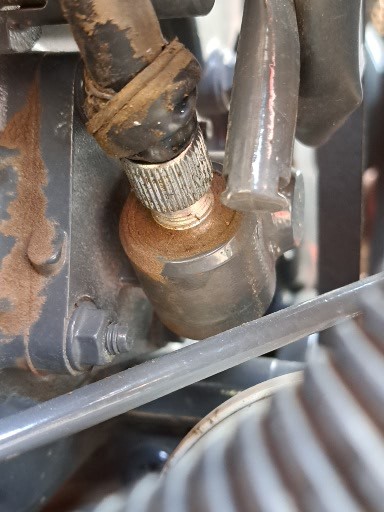

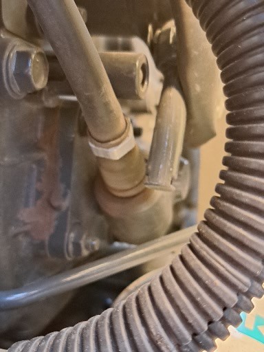

Well, mystery solved. Its the cable.
I had to remove the right engine shroud to access the motor side of the cable.
Pulling 2 , 12mm bolts, the shroud pops right off, leaving good access to the connection point. (Aft one pictured here)
Then roll up boot, and unscrewed the attach point.

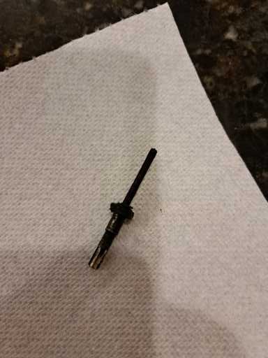

Here she is.
I'll call the dealer today and see if its covered.

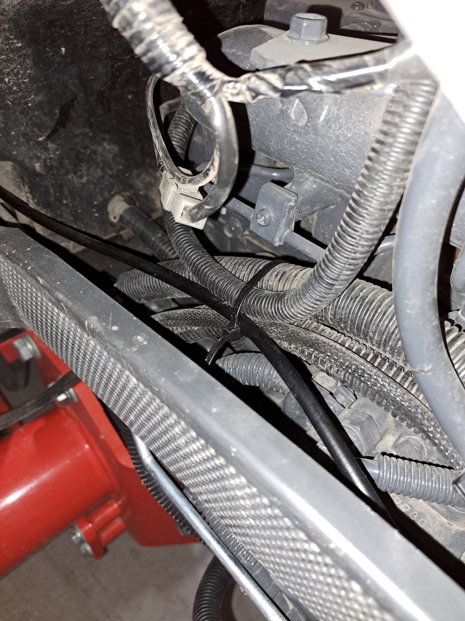

......or routing around sharp corners that gets those.
I think this is the problem.

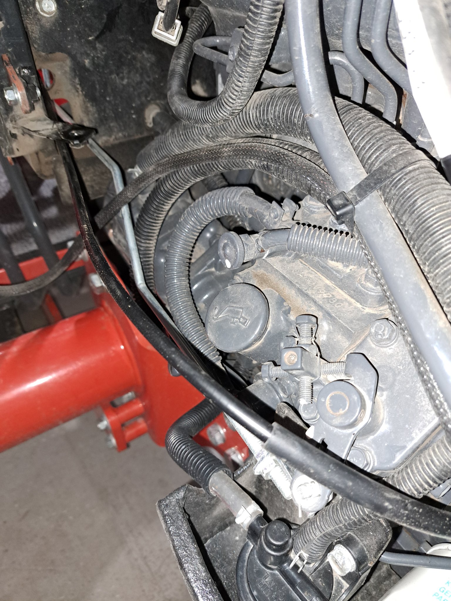

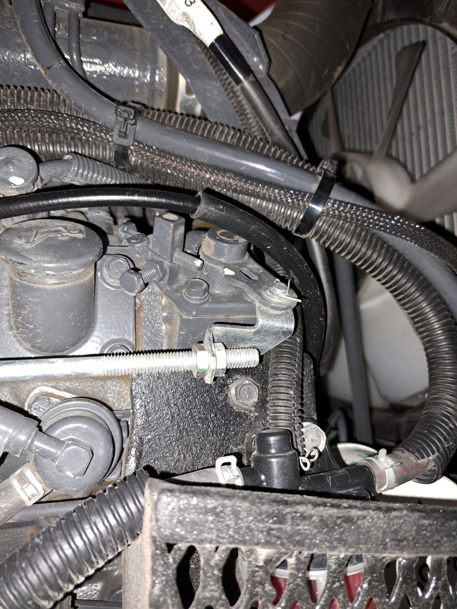

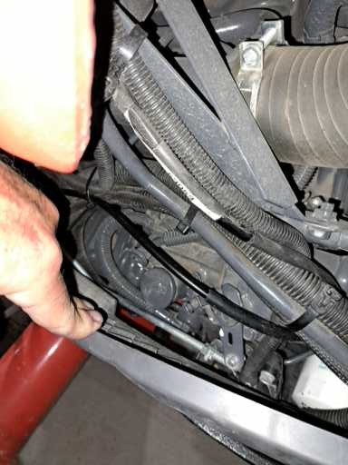

I will take a pic when I get it back from the dealer, however, when I traced it back, it was zip-tied in a bundle of wires which caused it to make what "I considered" too sharp of a turn.
3,000
3,710

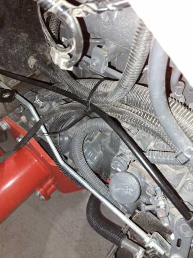

Ok, just picked up the General Lee.
They installed a new cable and zip tied it in the sam spot. Here are some before pics.
Took shroud off for clearer shot.
Tried to capture "unacceptable" angle from different views.

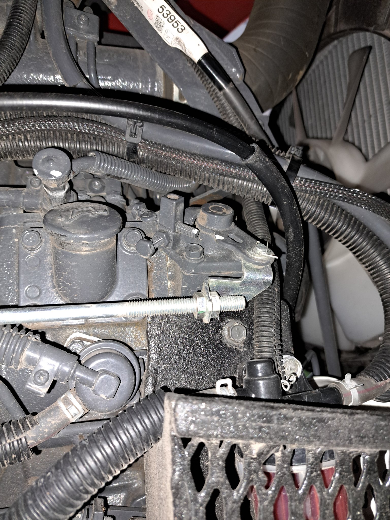

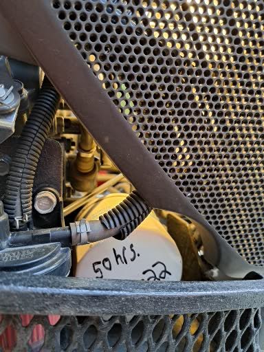

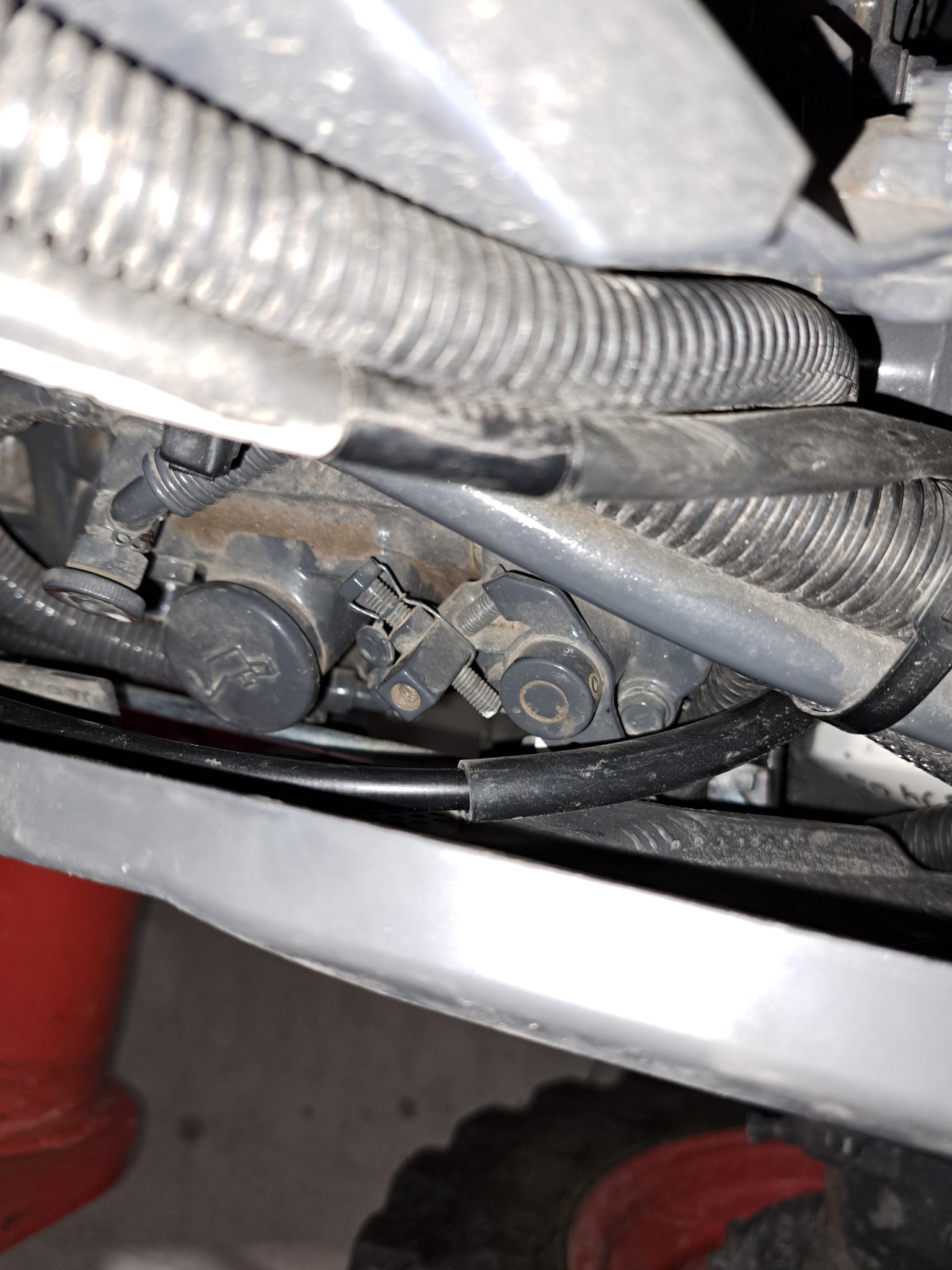

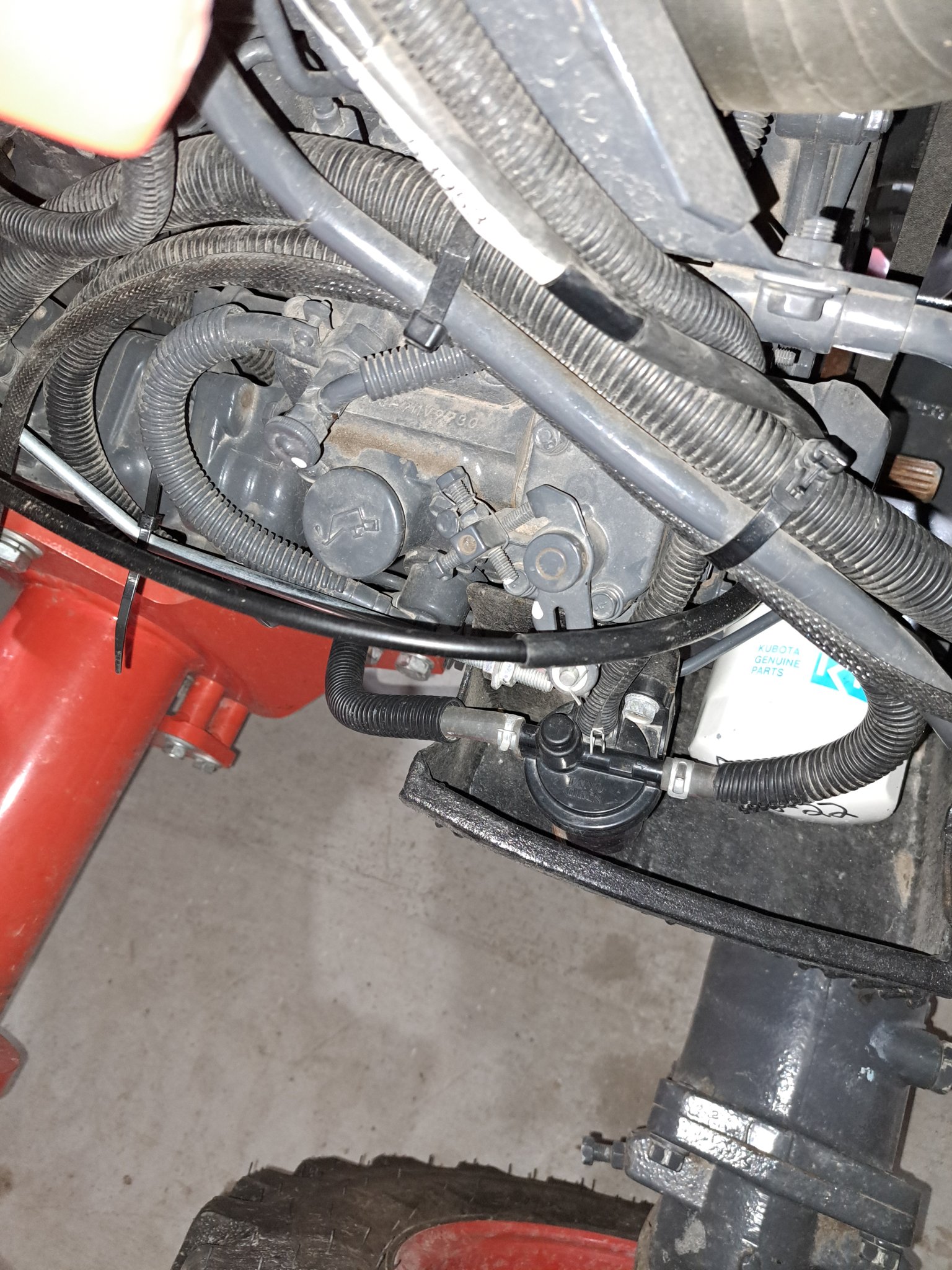

Here are some views of the "after cutting" zip tie.
3,000
3,710
That did not work out well....Lets try some side by side "before and after" shots taken from approx the same angle.
