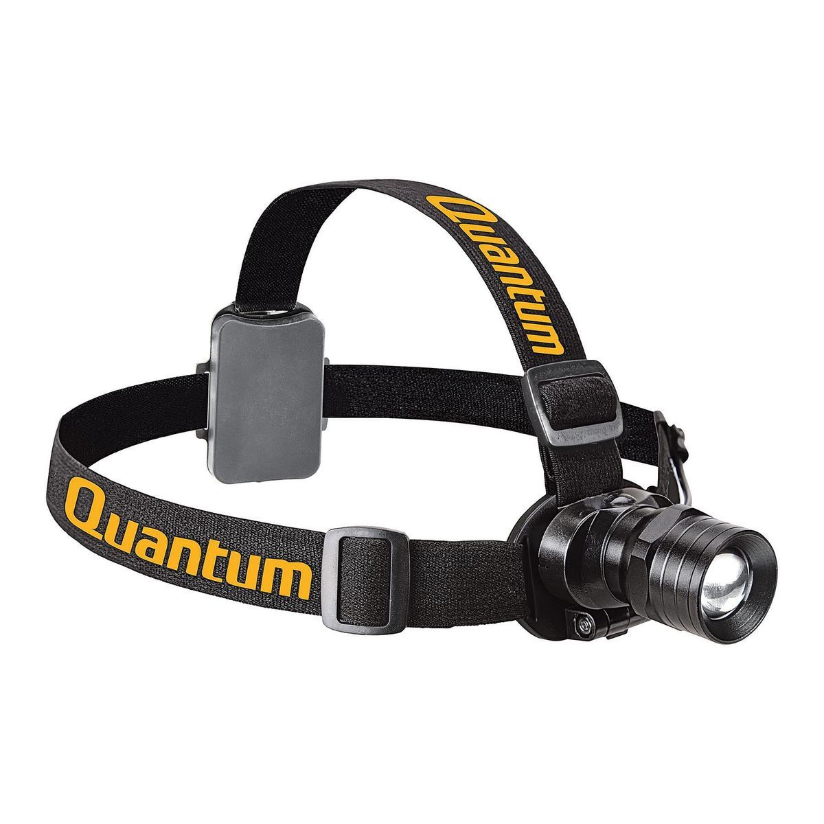

2nd option was already mentioned.
Gottaluv the headlamp!
Replacing with digital gauges (even it were possible) seems like a mighty bit of overkill and potentially complicated. ie: is your tach mechanical? Can you match the resistance of your fuel sender with something digital that uses the same range of resistances? If you can't answer these questions (and no offense intended), then the previous 2 solutions are the ones for you. I doubt very much there is a "plug n' play digital solution for an old tractor like that)
