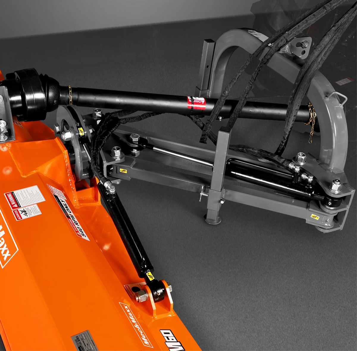

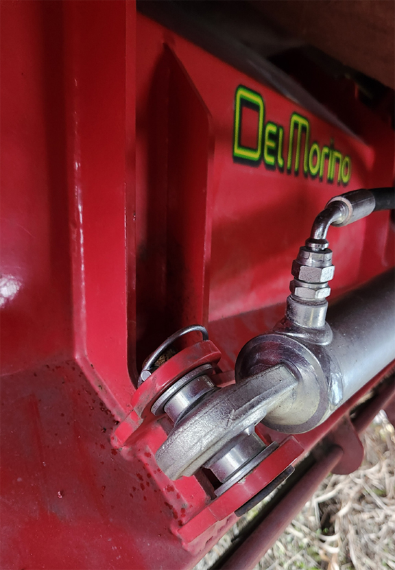

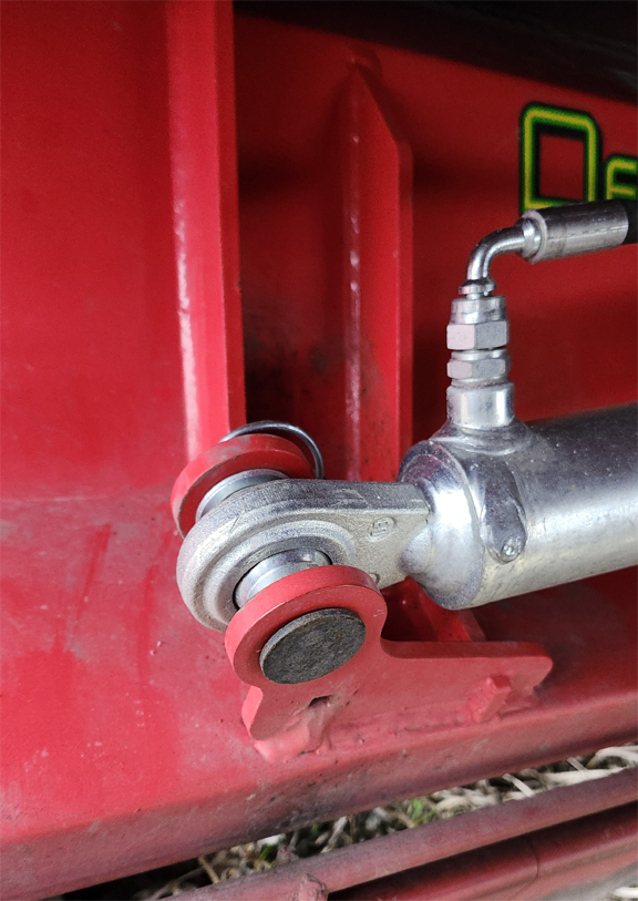

I run the Del Morino 62" flail on the MX6000 and the tractor handles it well but I have liquid ballast and wheel weights. The Del Morino is supposedly 820lb and the cutting head when fully extended puts a lot of weight off to one side of the tractor. If the MechMaxx 60" flail is really 650lb I wonder how your Kioti will handle all of that weight being offset.
I hope you don't have any need for the warranty since it's just about worthless with these Chinese conglomerates like VEVOR, MechMaxx and others.
For anyone buying a cheap Chinese knock off, particularly the ditch bank models, I suggest you keep an eye on the bracket and welds where the cylinder for cutting head rotation attaches. There's a lot of force on that mounting point and it's just not engineered well. Compare the Del Morino bottom to the MechMaxx top.
Here's how Del Morino does it.

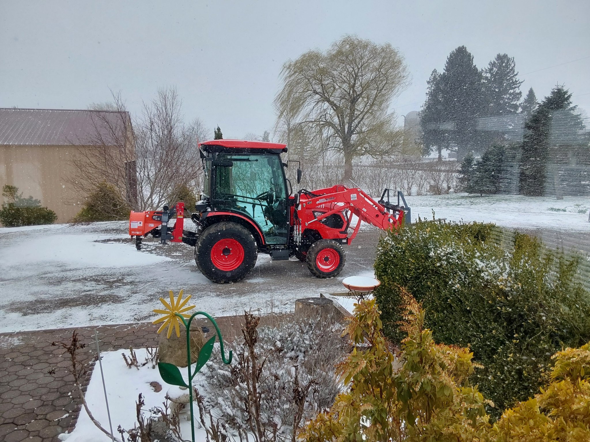

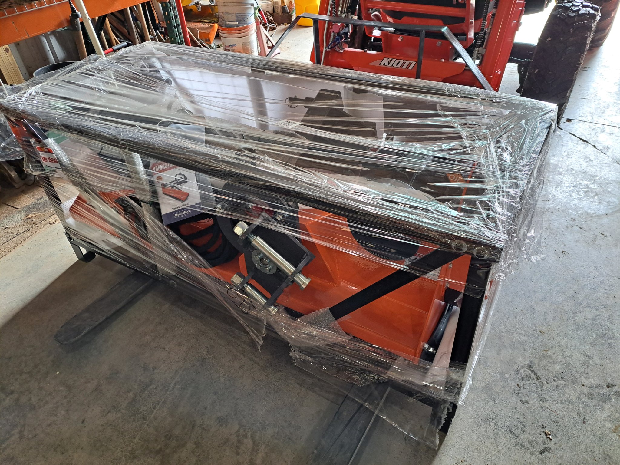

It arrived today in good condition with no damage. Looks well made and the welds are beautiful Single digit wind chills and snow for unloading. Just like February today. Guess I won't be using it for a while. 750 pound shipping weight. Fedex freight is the best in our area, they never damage a shipment.

Well looked good on the outside but lots of burried damage from poor packing. Hose damaged, cylinder damaged, paint damaged and no number to call. Waiting for an email response but going to need a lot of parts and paint. Just changed my mind about MechMaxx.
