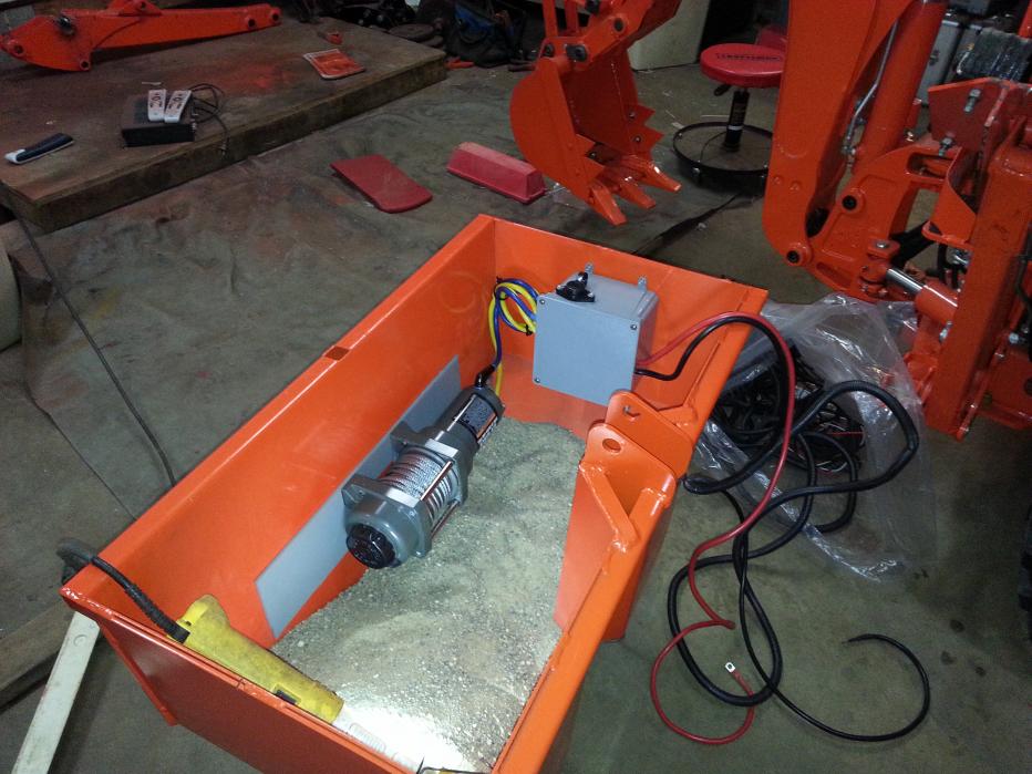

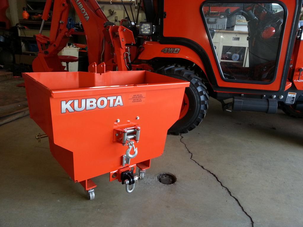

Winch is going to be used in case I get myself stuck again. Only going to use the plug in remote and not the handle bar one.
I have some quick attach cables so I can remove the winch. I've only found a couple of threads with winches, but they are used for log winching or used as a chute rotator.
Would like to find a good spot to place the solenoid and circuit breaker. Kind of getting tight on space. Any suggestions? Finding the place to run the 6ga cables without interfering with anything too. What say you modders of the orange tractors?:D

You could make use of Anderson electrical connectors. .
https://www.youtube.com/watch?v=_hdNL2fFnq0
The above youtube shows these connectors.
Using them would make your winch easily removable.
You could then make some container for the winch electrical in a box on top of the winch rather than trying to have the solenoids etc inside the tractor itself.

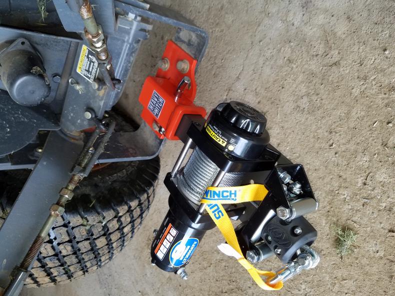

I can get more pictures of my setup next weekend if anyone is interested. Send me a pm of your phone number and I can send them that way. For some reason I am unable to upload them here, had too many unsuccessful attempts not going to try again.
I actually put mine to the test last week, 5000lb viper, was able to winch myself out of a steep ditch that I slid down in and rolled the tractor on its side.
