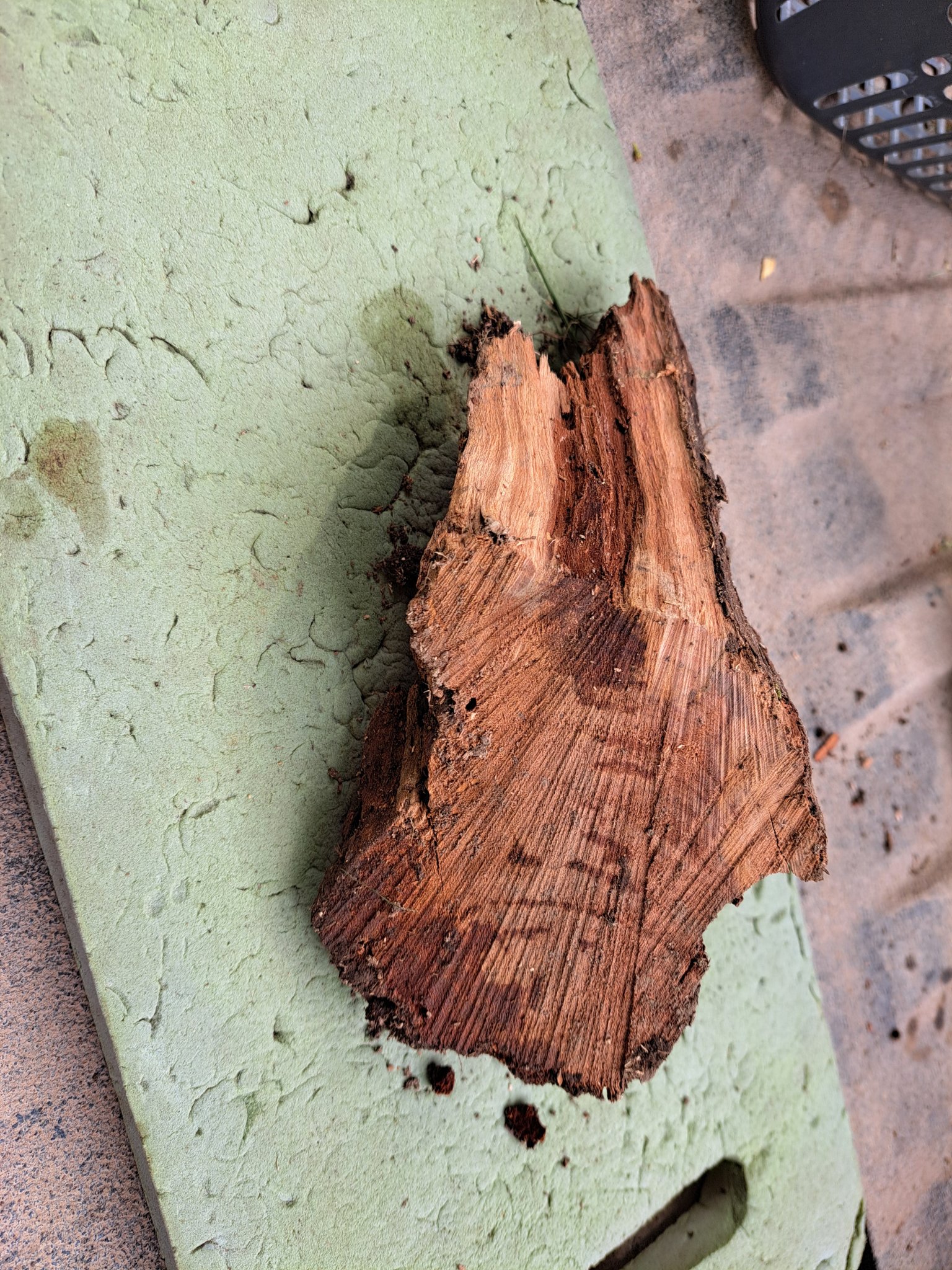

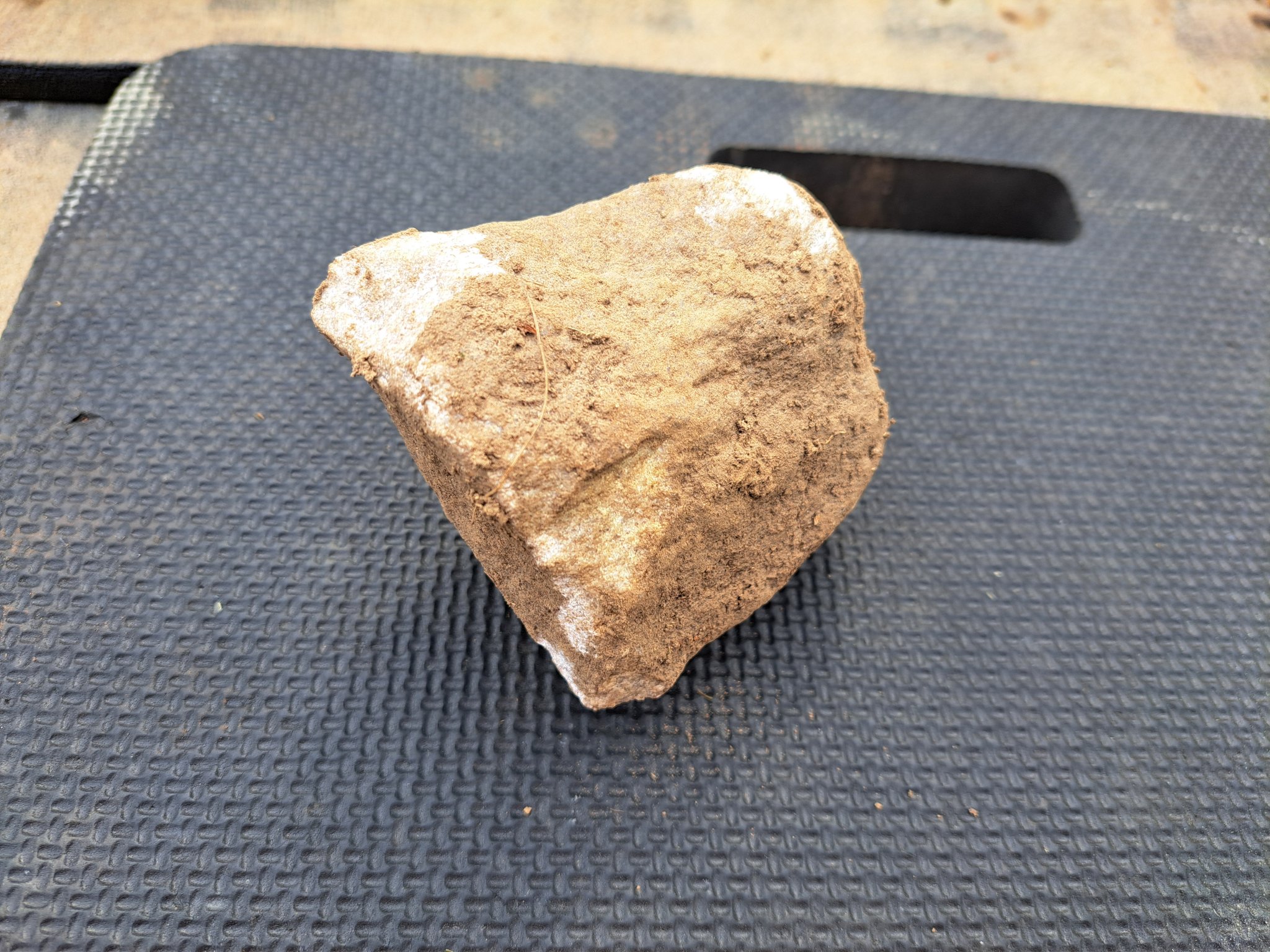

I did a fresh cut cherry 20 inch stump last night. Up to now I did some older walnut stumps about the same size and they were easy to grind. Well that cherry was a match for my little tractor with only a little over 19 pto hp. Could only take light cuts and then it tore off a chunk along with a rock that got jammed and killed my tractor. The clutch is set so it slips under load when the engine starts logging but with a fast hit, it didn't slip for some reason. Stalled the machine instantly. Maybe it needs a shear pin along with the clutch for impacts. Anyone know of higher quality replacement cutters? I need to replace a couple after the cherry and rock hit. Better then digging them.

Not sure which flavor of grinder you got. Here are a few places to look at for replacement teeth. In the mean time, just rotate the bad teeth out and swap them for the teeth that are close to the center of your flywheel. They rarely get any use so they are likely in "new" condition.
Replacement teeth:

Thanks for the links. I wonder if MechMaxx uses the same teeth as Woodland Mills. I like the re tipping option, but will have to buy a set first. That carbide used seems very brittle on mine and I bet good tips would last better. Definitely haven't touched the center cutters yet so swapping would be a good option. I took the grinder off for now and am going to take the pto clutch apart first to see if I can figure out why that didn't slip this time.

Carbide is brittle.
