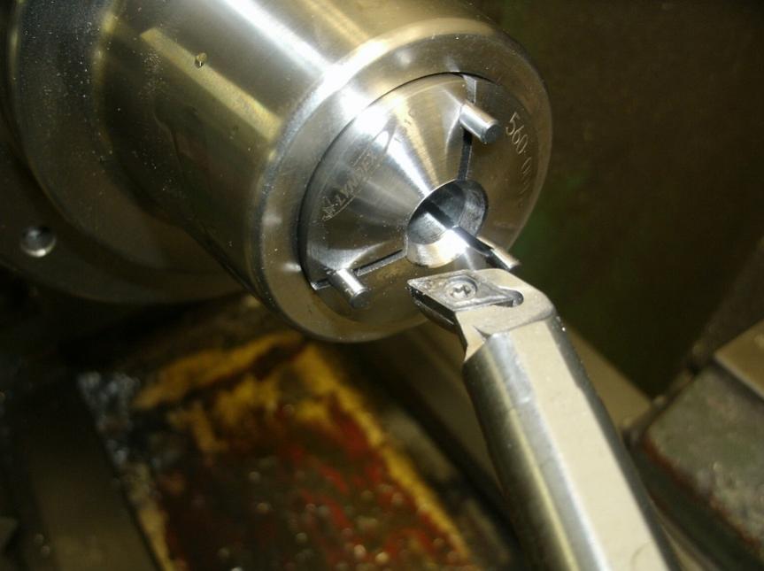

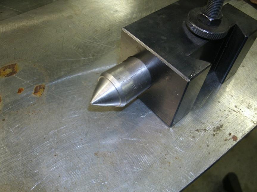

I bought the thickest wall 3/8" hydraulic tube to make the tig welding to the adapter easier. The bad part is, it cannot be flared using conventional tools. I found a video on youtube how a guy did it on his lathe, so I decided to give it a shot.
I got a machinable collet that I bored and reamed to clamp the tubing. Then I machined a 37* angle on the end to form the flare. I machined a lathe center to the same angle to act as the forming tool. Ran the lathe at about 200 rpm and did this practice tube using oil for lubricant.
Not too bad, but then I remembered having some white lead that the old timers used to use for lubricating the centers when turning on the lathe, and that is what is used for the actual tube. Turned out much better.

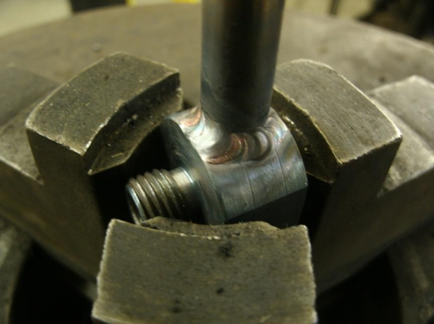

Had to put a slight bend in the tube to aim it back properly, and then tig welded it to the adapter. Looks like it will work. Just need to pressure test before assembly.

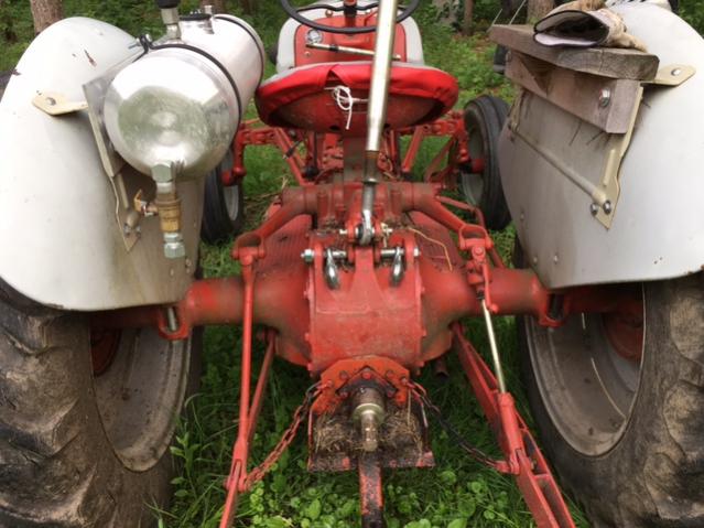

Yes, I got a Prince pump and yes, I noticed there was no way to retain it to the shaft. I glanced at their instruction sheet and see they recommend a torque arm or something like that. If you could sometime, please post a picture of how you mounted yours.
Having just gotten my new B2601 yesterday, I am retiring the 8N from rotary cutter duty which means I can remount the grapple loader. (Sadly, no firewood-- small diameter pine has little value so this setup is purely for putting it through chipper.)
Three pictures to show what I did:
#1- 8N without anything attached, but you can see the hyd tank clearly.
#2- PTO pump attached, large inlet hose (only NPT on the setup), normal outlet with quick disconnect
#3- How it is mounted
Gravity feed from the tank to the pump via larger diameter hose worked very well for me. There is a full-port ball valve for shutting off the oil for disconnecting. (You want to think about how to remove your work of art as guessing your tractor wil not be dedicated to this one task.) The quick disconnect connects to an inlet on the valve bank (pictures next week).
In terms of mounting the PTO pump, it is a torque arm setup using the drawbar as the fixed point. The block of wood is both a spacer and has a little give to it. Not a great picture, but there is a chain that mounts to the the right lift arm limit chain. That prevents the PTO pump from walking off the shaft should it have that inclination. In the Prince kit, they use a single chain to both prevent the pump from spinning (my arm + wood block) and keep the pump on the shaft (my separate chain).

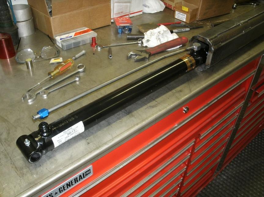

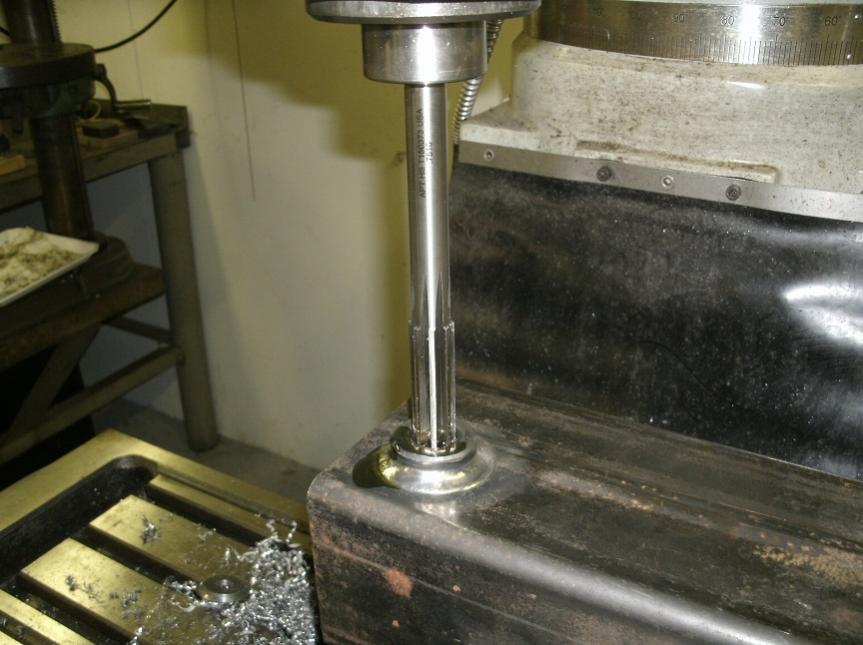

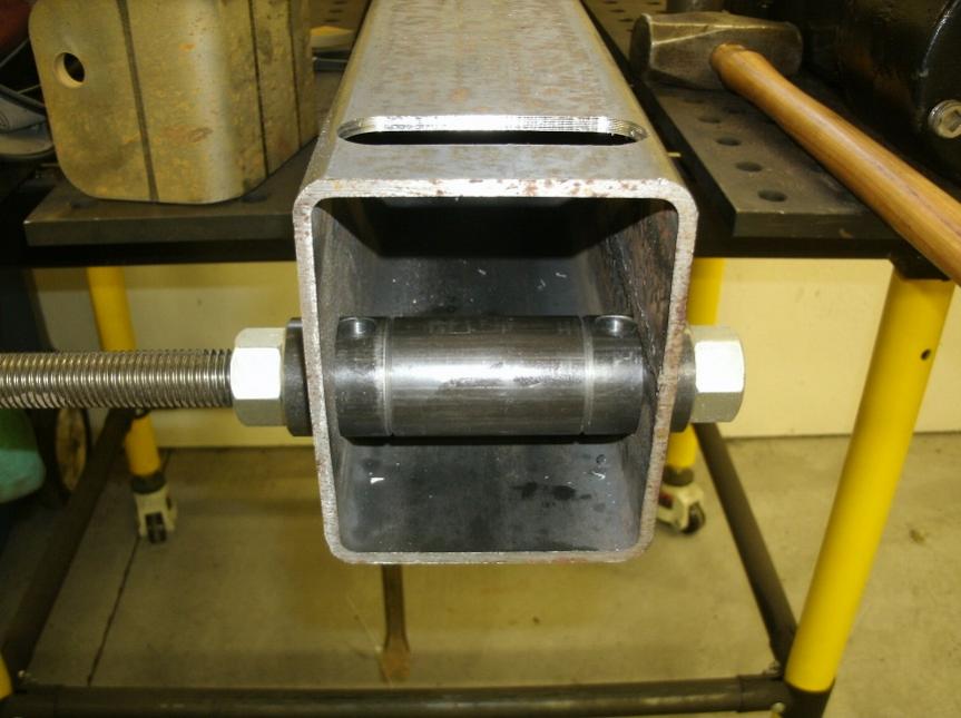

Working on the pivot end of the outer boom. Made up the 'bearings' out of 1-1/4" steel round stock and also made a spacer to allow for clearance of the extension cylinder. The cylinder and pivot will be using a common pin, made out of 4140 x .750.
I'm showing my little positioner that I use for welding rounds. Made a holder out of some rectangular tube to rest the boom on to weld. A little duct tape and a large cut off for a counter balance.
Guess you can tell I get along with reamers quite well. Install the grease fittings and that should be that.

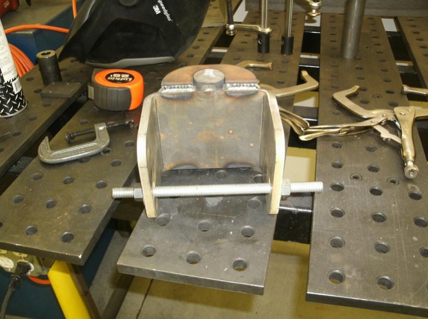

Made the weldment for boom swivel. Next will be getting it on the milling machine to drill and ream the pin bore and also true up the surfaces where it will be pinned to the 3 PH.
