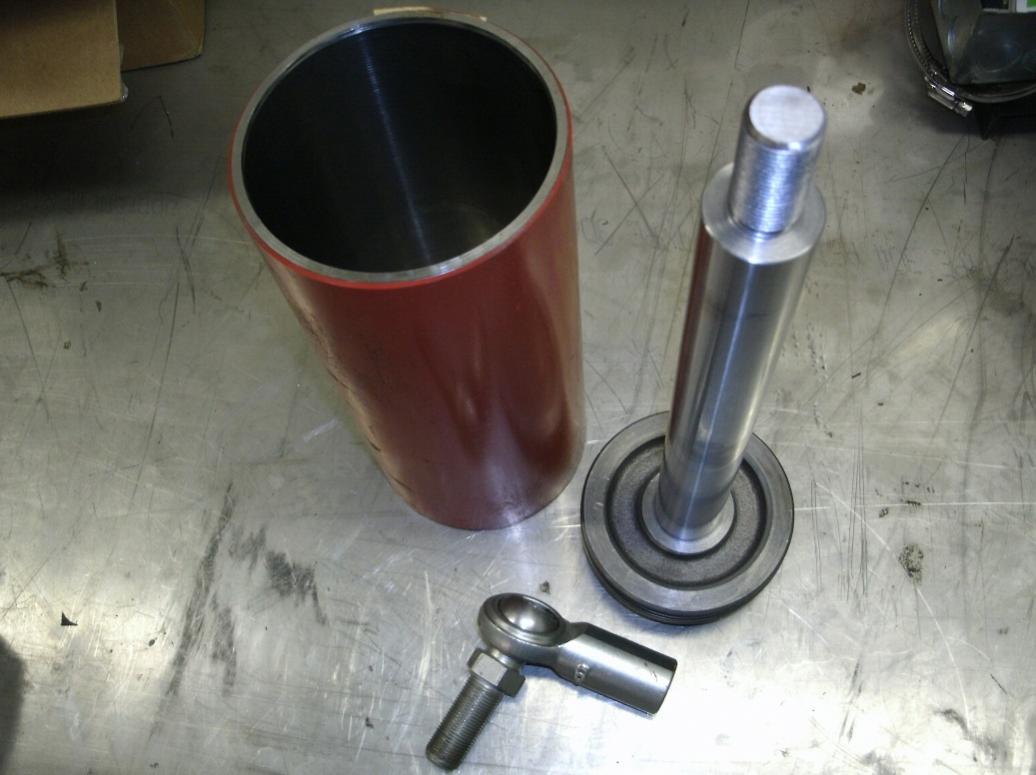

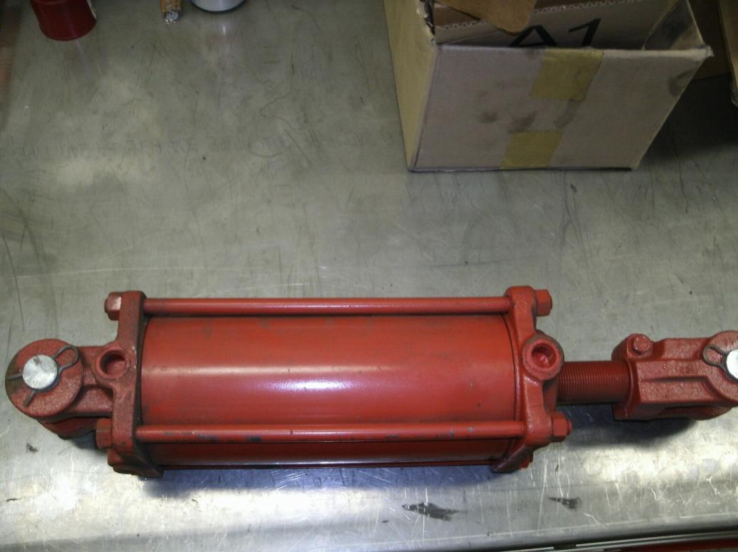

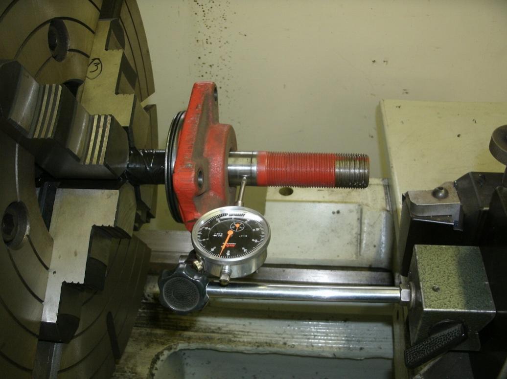

Found this 4" cylinder x 8" stroke in my collection of stuff that I'm going to modify for the swing cylinder. I remember buying this brand new in the early 90's and never used it.
I know there is going to be dangerous power with a cylinder this big and I will have to address this. But the speed will certainly be slower.

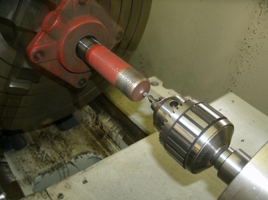

Took it apart and threaded the shaft to accept the rod end. Set to go back together and if the weather cooperates, will get some paint on it.

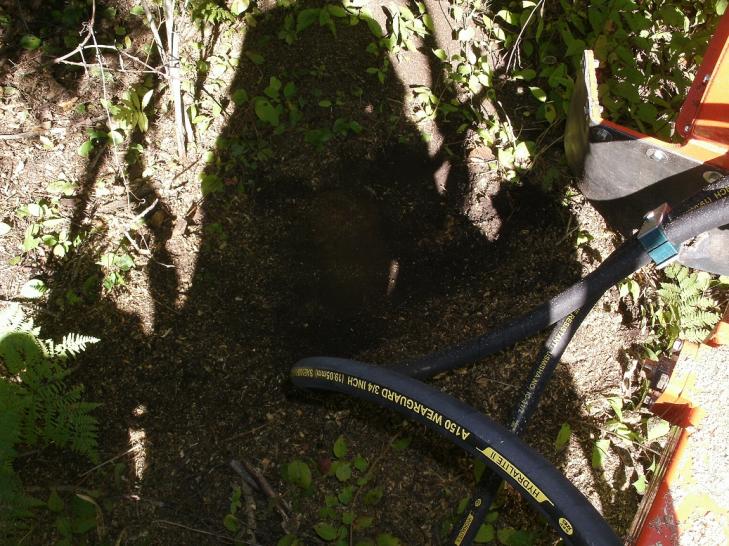

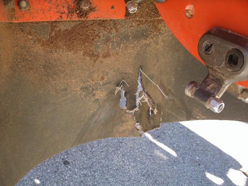

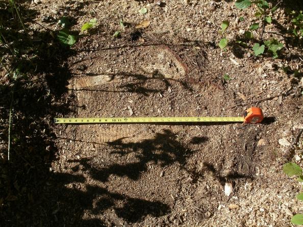

Well, stump number one is in the books. It was about a 30" pine stump and it took about 15 minutes. I'll get faster as I get the hang of it.
One casualty was the flap. Worked good until I got on the far end of the stump at ground level. One experiment I might try is reversing the teeth and wheel rotation and see how that works. No hopping with the wheel sending the chips backwards toward the tractor, which is a good thing. Reversing it might be a different story. Only one way to find out. Then the flap wouldn't have to be so substantial in the back.

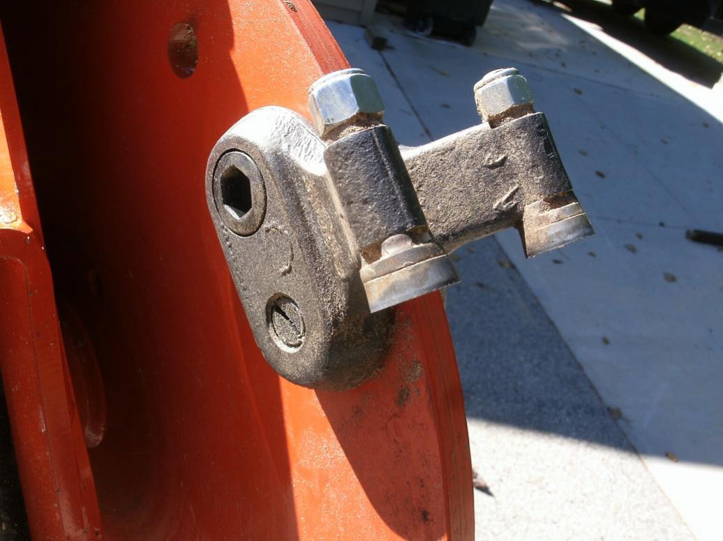

Took a close up of the teeth after grinding. Look good.

No chatter with the wheel going the opposite of the original plan?
Sent from my XT1254 using Tapatalk
I didn't notice any difference like I thought I would. Would like to get better control of the down feed cylinder to better control the depth of cut. Going to try machining some restrictor fittings for that cylinder.
