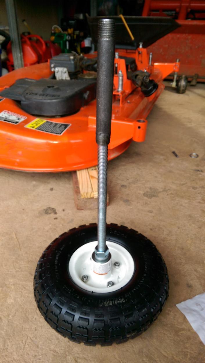

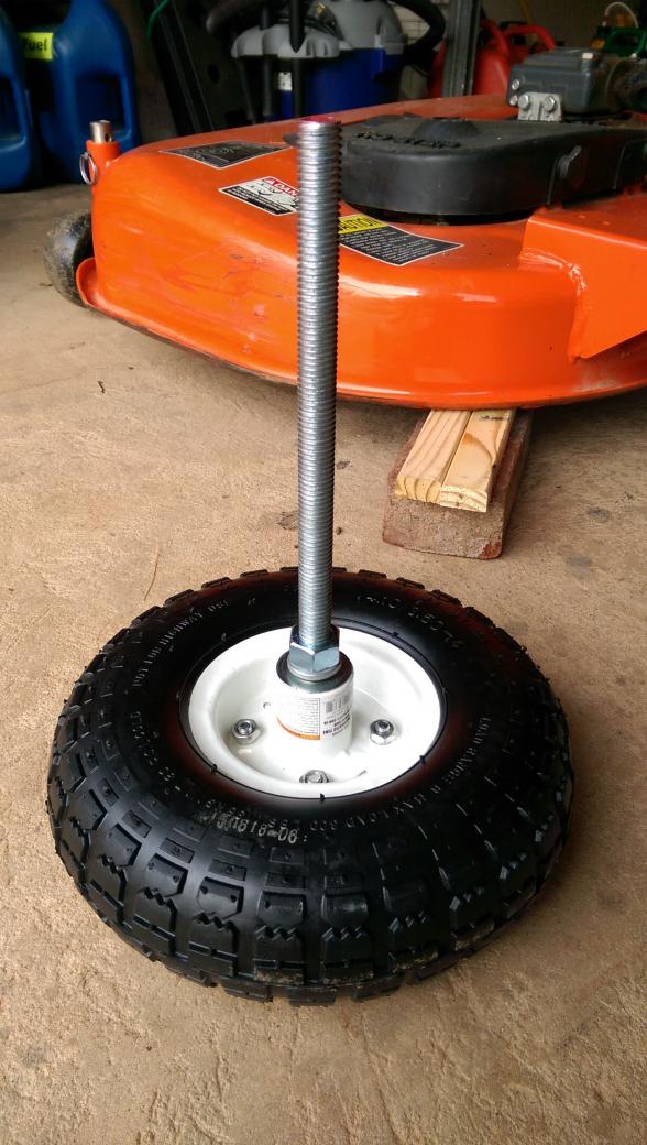

1) Attach a wheel to the threaded rod using lock washers and hex nuts. *Note, the hex nut you see on the inside of the hub will actually not fit when this thing is fully constructed, I just put it there for the picture.
Another view
2) Note that, out of the bag, my 1/2 in. iron pipe would not fit over the end of the threaded rod
This is because there's a seam ruanning along the length of the pipe on the inside, and an internal seam right at the very ends of the pipe on both ends

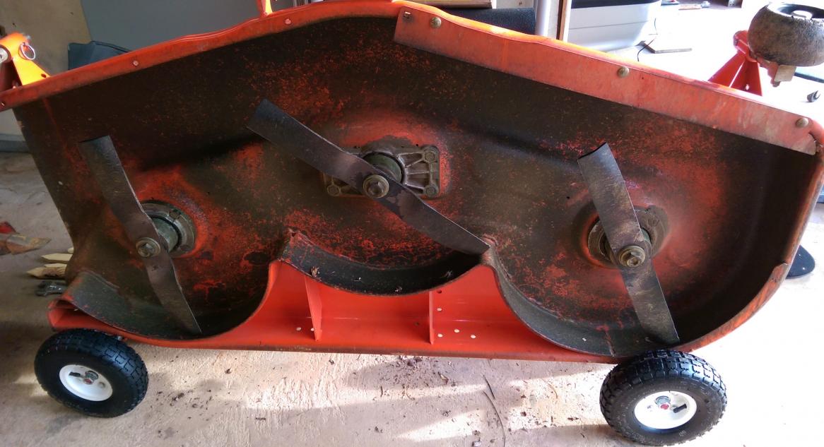

4) After about 10 mins of filing/Dremel-ing, and a few squirts of WD40 later, you'll have something like this (view off of the MMM)
A closer view
5) Wrestle these onto the deck by using a combination of mover dollys, front end loader pickups and stacks of bricks and 2x4's (or muscles if you're Hulk Hogan :) ) and you'll have something like this. Tada!
Now there are a couple considerations. The 1/2 in. iron pipe does not take up the entire space within the anti-scalp post as you can see, so there is some slop
But the balance of this MMM on these back anti-scalp posts is amazing. Even tilting the MMM to the side it wants to return to center by itself - this is the most it will tilt (obviously knocking into it with something heavy or carelessly can cause it to fall - CHAIN IT UP WHEN IT IS TO BE STORED!!!)
