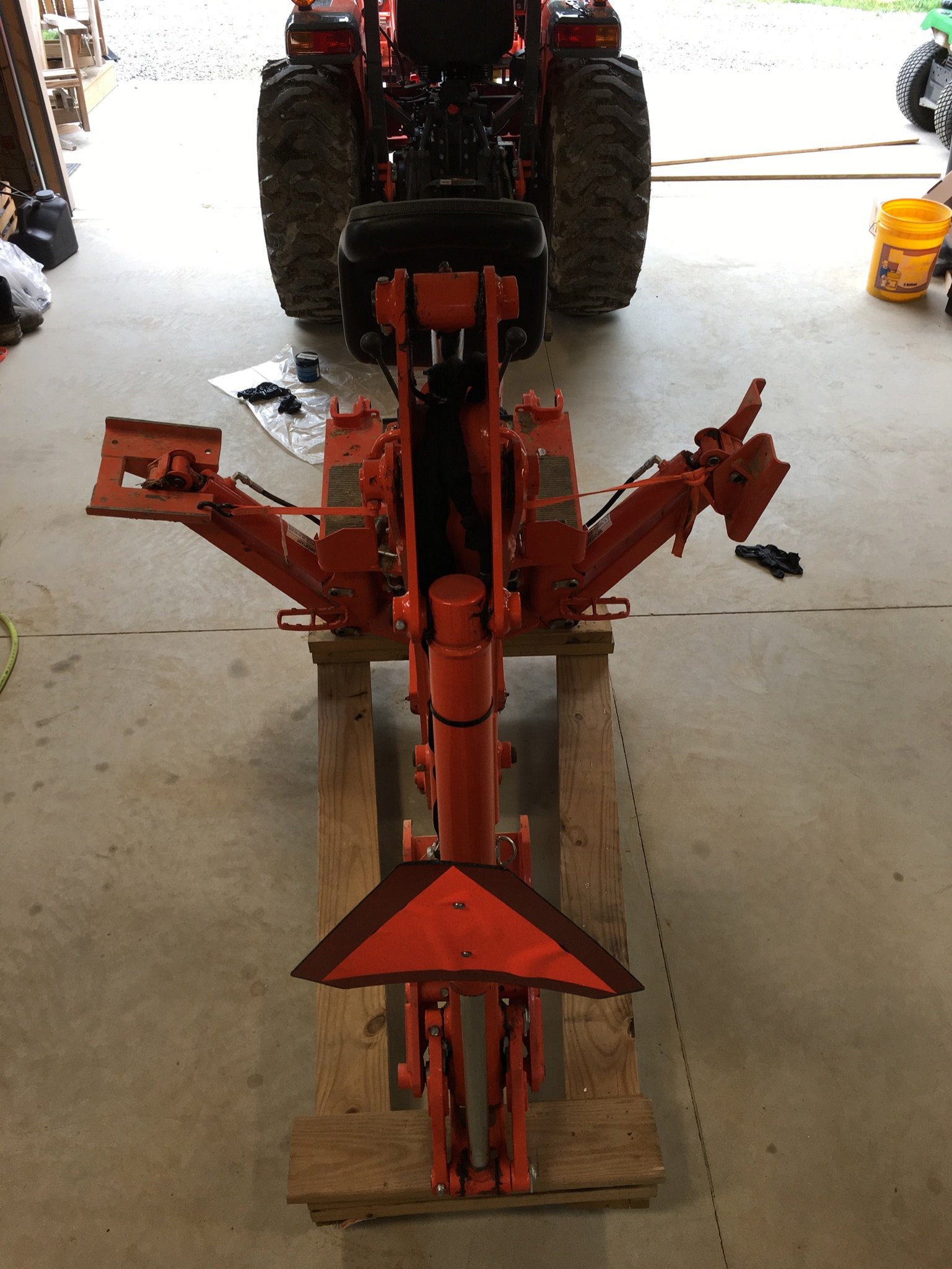

Kevin,
Not sure if this helps. Mine in it's "resting state" without the boom locked.
Rough measurements 53" wide (at stabilizers) by 87" long (not fully retracted) by 64" high at boom/dipper joint.

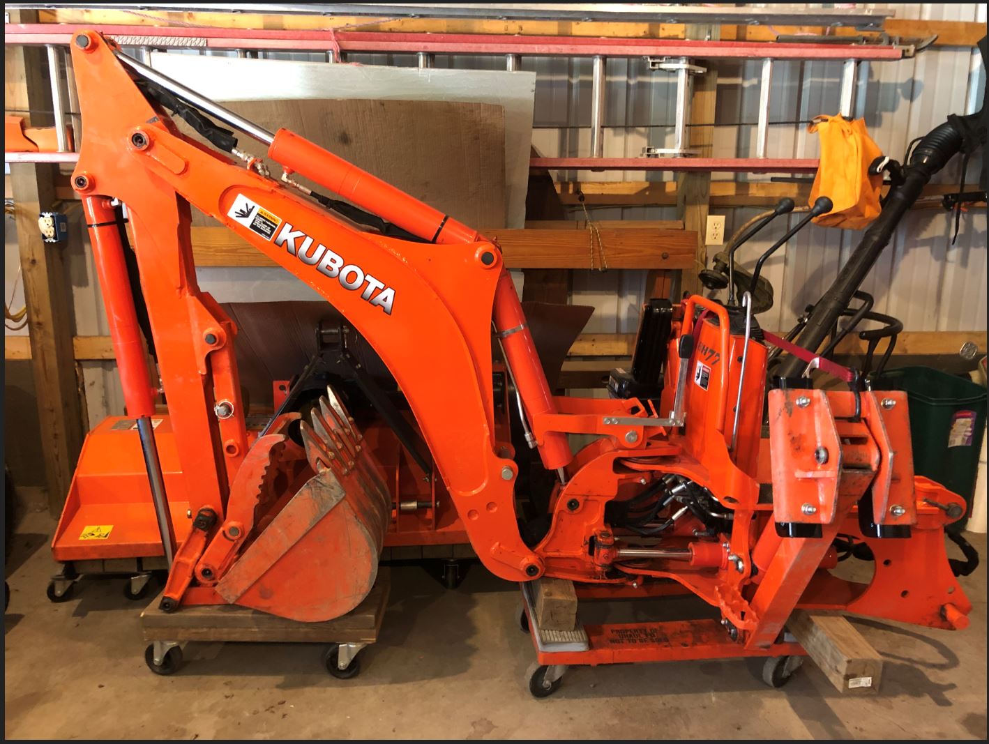

this is a BH77 - 88” x 60” on this dolly
on final approach 😁

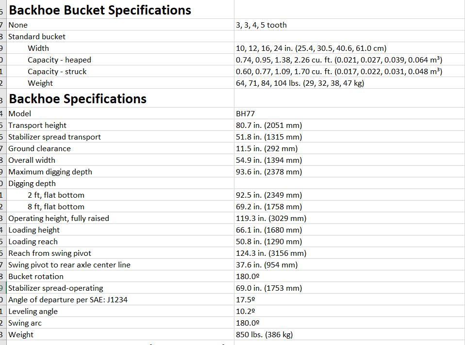

yeesh 850 # PLUS bucket weight...makes for an interesting real life 'Tetris' game for fitting stuff juuuuust right !
Remember you'll need at least a foot more to get around it !
