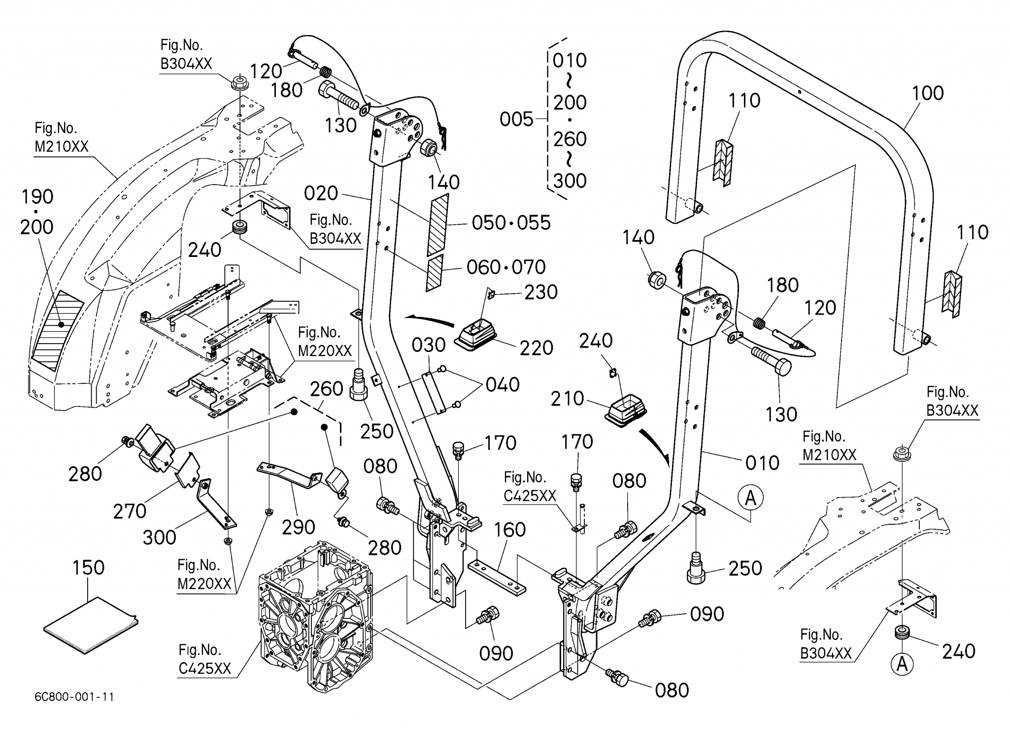

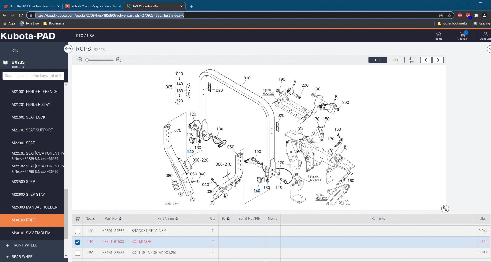

Found it. Well, it should fit. Item 140 in the diagram. PN listed below.
