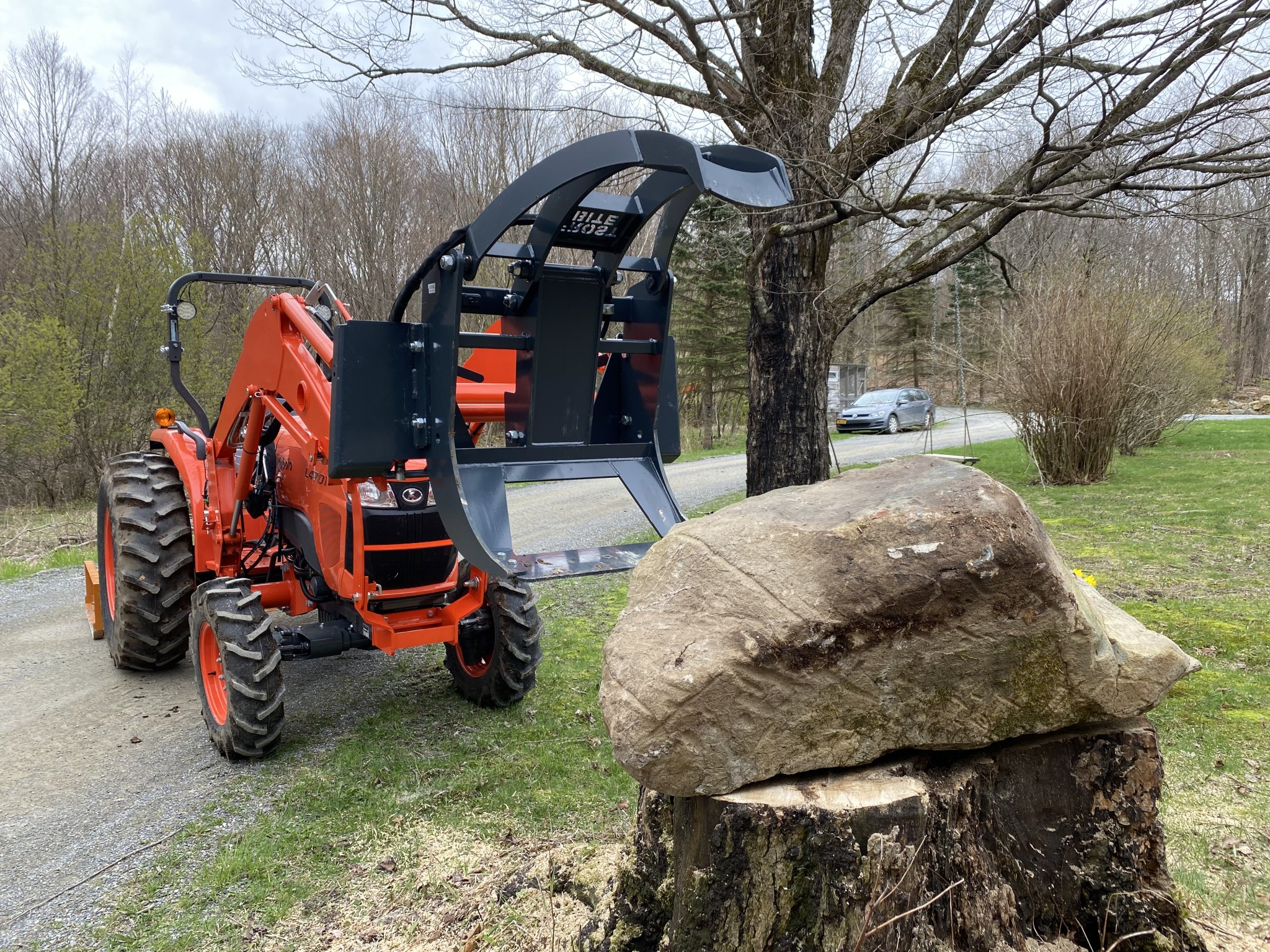

I have very limited use for a grapple, so I opted for a low cost grapple, from MidState attachments, in Denton, NC.. ($1,200)
60" weighs 500 lb.
Kinda heavy, but my loader will lift 3,,000 lbs., so weight is not much of an an issue for me.
Welds look good.
OEM steel pins WERE non greasable, but I replaced them with brass pins, center bored, and made them greasable.
