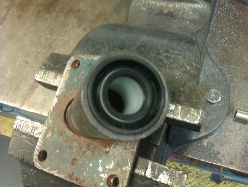

I decided to redesign my little kubota's steering box assembly.Being in Ireland parts are either very hard to get or very expensive so innovation has had to play a big part in my restoration process.Instead of buying a steering kit I have machined my existing steering rod to take a taper roller bearing where the bottom bearing sat, I built up the shaft with weld where the upper bearing and lip seal sat and turned it down to take a sealed ball bearing and new lip seal.I then turned down a teflon bush to act instead of the upper tube seal and tapped it down 10 mm below the top of the tube to allow me to install a lip seal.I have 5.5mm ball bearings on order and should be here in a few days so hopefully it should all be fully assembled in the next week.Ill upload a few pic's soon.

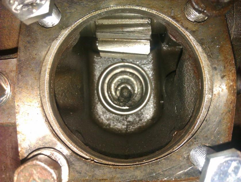

Thanks for the tips matt ill try that...I had nothing to loose before i started as before i started out the shaft had a very slight deflection in it.This was caused from the disintegration of the bottom bearing.you can see in the photo of the main body that the steering rod had actually started wearing away the base of the box.I welded the steering rod in stages with the main shaft wraped in a damp rag and had a bucket of cold water next to me as the heat spreads really quick.I have assembled it with out the worm gear and the shaft turns well,the teflon bush takes most of the run out and should be tough enough to last for a few years.
