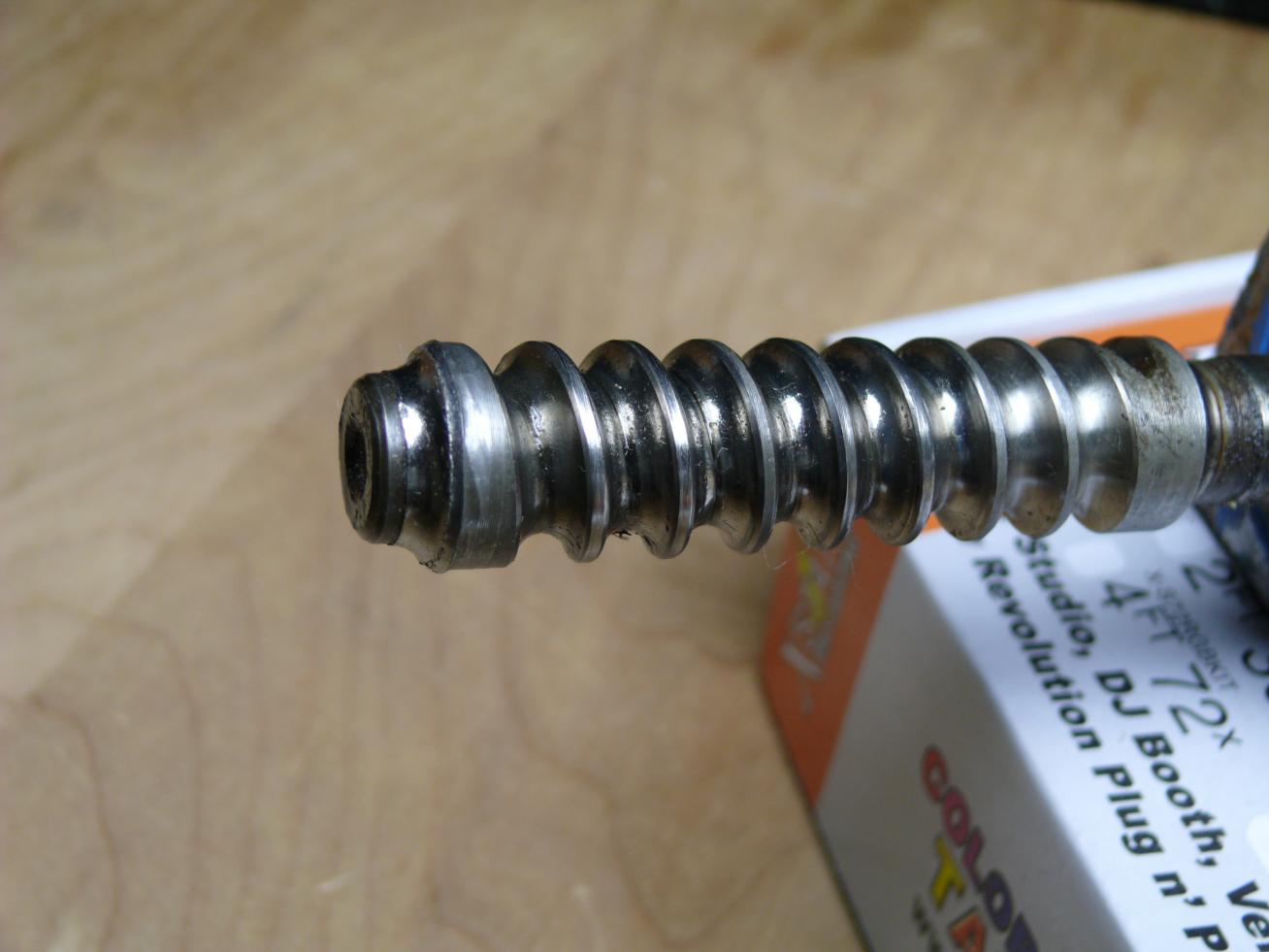

Going to order some parts today and just wanted to get opinions. As I said before I am 6 years into this post now. Exactly 6 years ago the steering broke down on me and here I am again. I think the failure is a combination of things however I do not think it was from water getting in the steer box this time. I didn't see any evidence of water so I may have lucked out with that. But she still broke down same way. When I opened it ball bearings from the ball nut assembly were sitting at the bottom. It seems to me it happened because I never really got the steering to be lined up correctly when I fixed it last time. Steering was never feeling correct but it worked so I left it. This time I am going to try and understand that better.
I should mention another problem which happened before and that is the pitman arm is twisted again. That piece alone is 65$ so I am going to try and use it as it is. I guess all this happens because of the extreme weight the FEL puts on the front. I mean after all these were built for rice paddies right?
So now here is my question about the steering rod (shaft) When I took the shaft out this time and was inspecting the bottom of it I noticed it has developed wear to the point there is a small ridge that is very sharp right near the end. Is that something I should just file down? or does it even matter. the shaft at that point just sits on/in the bottom ball bearing set..but is this sharp ridge causing premature wear?
Everyplace I have checked the Knuckle is not in stock and some places the shaft and knuckle are sold in a kit for about 120$. DO you all think I need to replace he shaft because of the Sharp ridge I have described and attached pic of? Just wondering what to do and how to do it the cheapest as usual. Thanks for any input you can give ,also are they any other vendors I could use besides messicks as they are out of stock. thanks Rick
