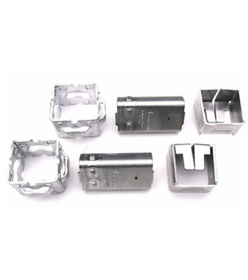

Saw a dog kennel that just used T-posts. All the corner and "gate" posts used other T-posts as braces. Wondered how they connected the posts. Guess was drill and bolt. The wedgelocs look to make life easier.

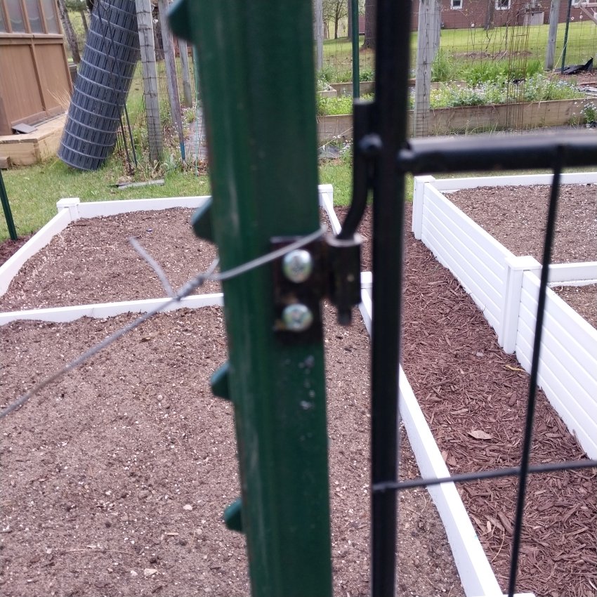

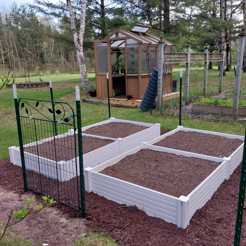

Still working on our small, raised garden. The soil is in, mulch is down and T-posts driven. Here is my question, has anyone tried to drill holes in those things. I have drilled in hot roll steel and it is tough, but these things are at a whole new level. I wanted to put in a small metal gate that is made from those decorative hook together fences. I made a hinge out of an old door hinge that turned out good. Come time to mount them and WOW! these poles are really hard to drill. I went through eight good drill bits that aren't so good now. :mad: I've used T-posts before but this is the first time drilling in one. View attachment 154622 View attachment 154623
Weld the hinges to the posts.

I could if I had a welder. I don't have much call for one otherwise There would be one sitting in the garage right now. ;)(y)
Well, you do have a tractor. A welder is part of the tools to support it. ;)

I have never drilled thru T posts, so take this with a grain of salt:
For a gate, I personally would consider a chain link gate and posts, or wooden 4x4 gate posts and a wooden gate. Standard T bar is great for long runs but not very stable being used as a gate. There isn't enuf surface stiction in the ground or heft in a T bar for 90 or 180 swing with a gate. But, I could be wrong.
Try to push over a t bar that has been in the ground for awhile. You will bend it. Then try the same with a chain link post or 4x4 wooden post. Just sayin'.
I’m new to the site but maybe you could 3d print some kind of bracket to use instead of drilling your posts.
Ps. Your garden looks very nice.

I know I am late to the game.
I have several drill bit sets from different manufacturers and found that for starting holes in steel, mibro cobalt works best for me using a 20v Dewalt Drill. After punching and getting the hole started using a small bit, I use Harbor Freight black oxide step bits to get the hole the size I need. I've done this with up to 1/2" thick steel.
I also use mibro cutting fluid as well.
You want to use slow speed with steady pressure.
