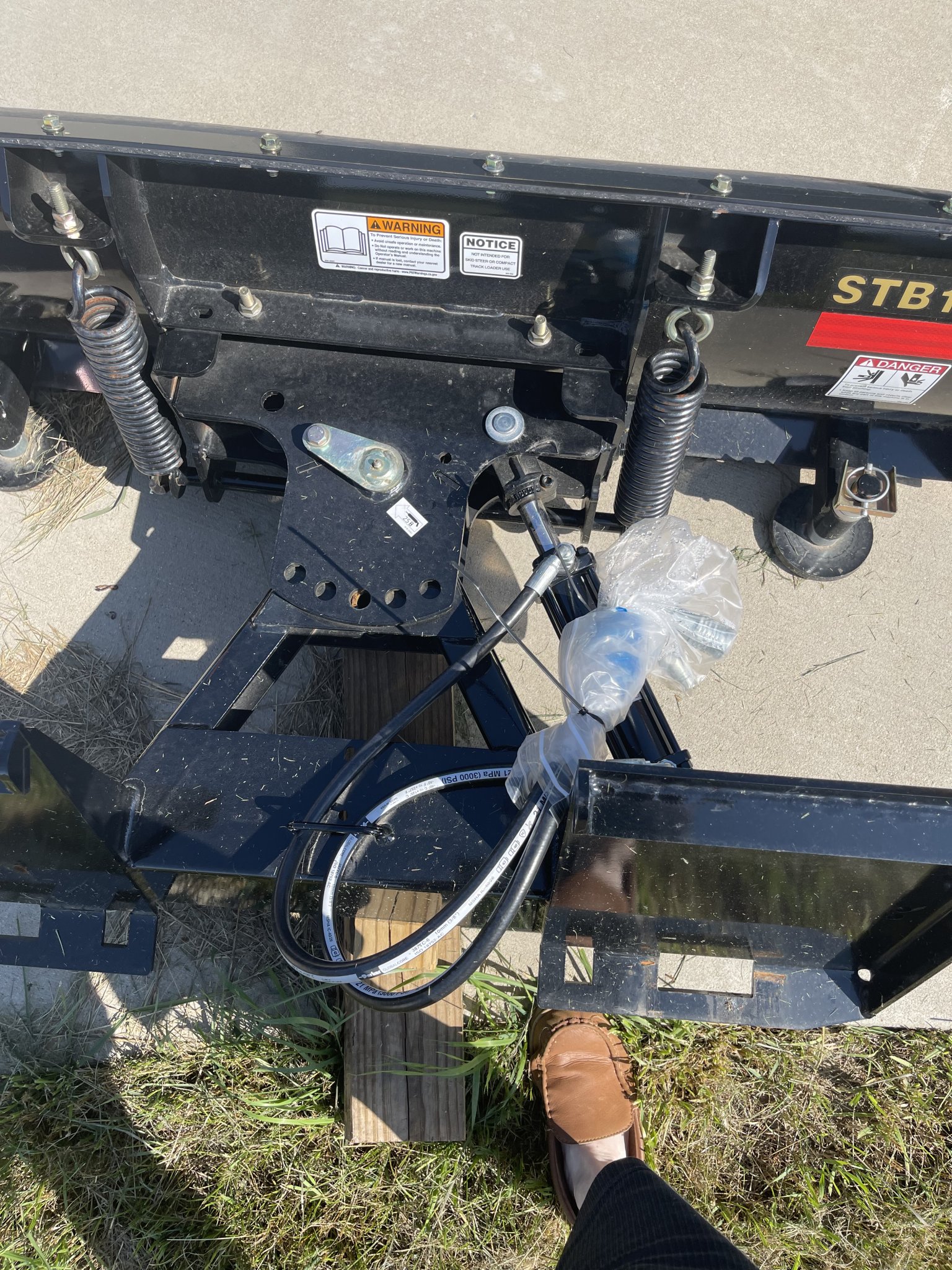

I looked at a 360° product image of the SBT1060 and it sure looks like the mounting is solid to a QA plate with no means of having it hinge to move up and down.

I'm not sure I follow? It does have a trip spring in case you catch a curb edge. There are two bolts on the back that can switch you from a fixed "dozer blade" mode to a "trip" mode.

Trip isn't float. The picture shows structure that can rotate left and right in relation to the QA plate. It doesn't look like the blade can move up and down independent of the QA plate.
Blades that float are usually suspended with chains.

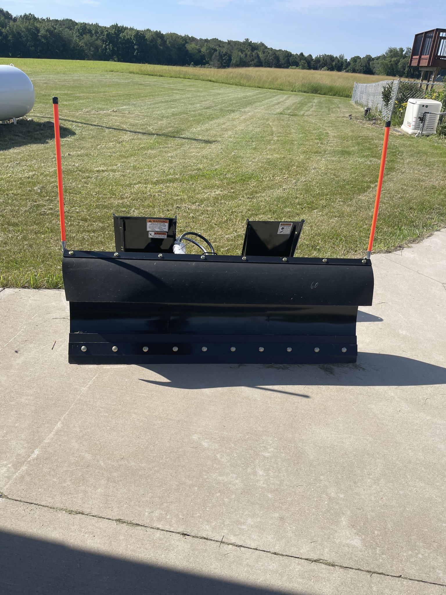

I run the STB-1060 with single hydraulic servo (3rd function) for side to side control on a LX2610 cab model. The blade is poly vice steel. My driveway is asphalt and the parking area is concrete. The only ballast I ran was fluid in the rear tires. I added the rubber curtain on the top to limit spill over and the side post markers as options.

It keeps me from firing up my Ariens snowblower and freezing so I’m a happy camper. The only thing to keep in mind if using a poly blade is the corners may bend slightly. You can see it in the front picture. The blade still performs the same. No regrets there either. I plow in 2wd in low gear and I get to work at about the 4” mark with R14 tires. I save 4wd in case I drift off the hard surfaces and get stuck. Your tractor should be fine if you tackle it early on and use the angle to your advantage. I would recommend getting the 3rd function so you can adjust your angles on the go vice manually doing it.
