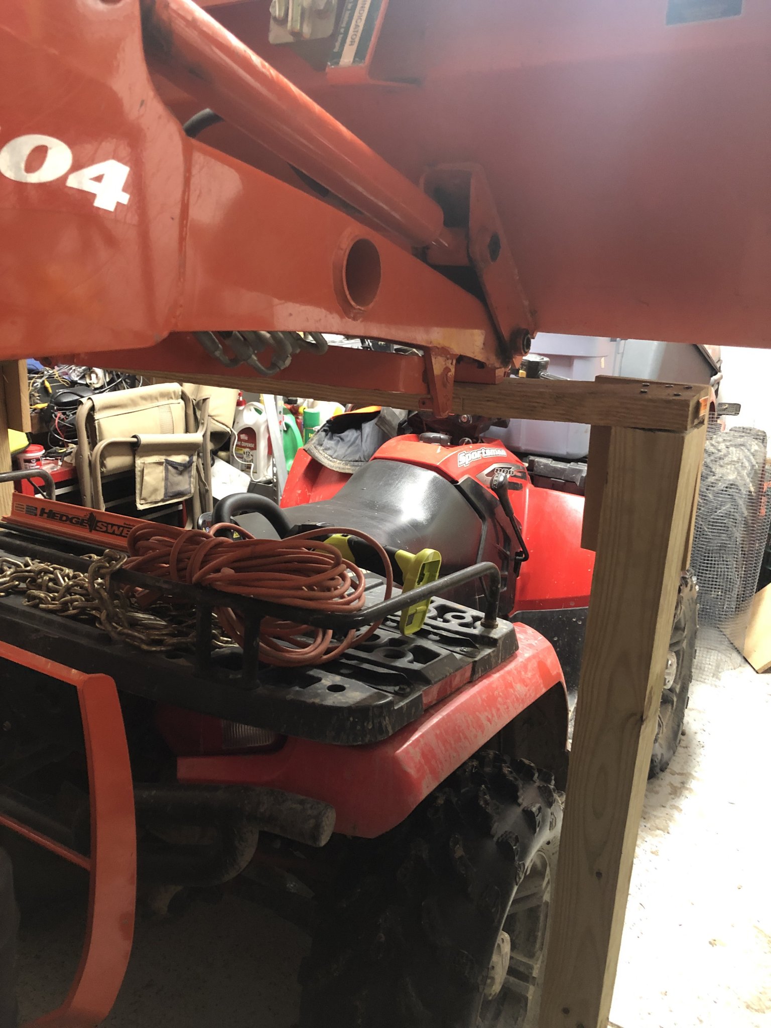

Similar problem here with my B3200 and my quad. I could just rest the bucket on the back of the quad but then I’m overloading the suspension. Version 1 of the support needs a cross section under the 2x4 for more stability but it works great. Now I just need 4’ more behind it to leave my rear blade attached
