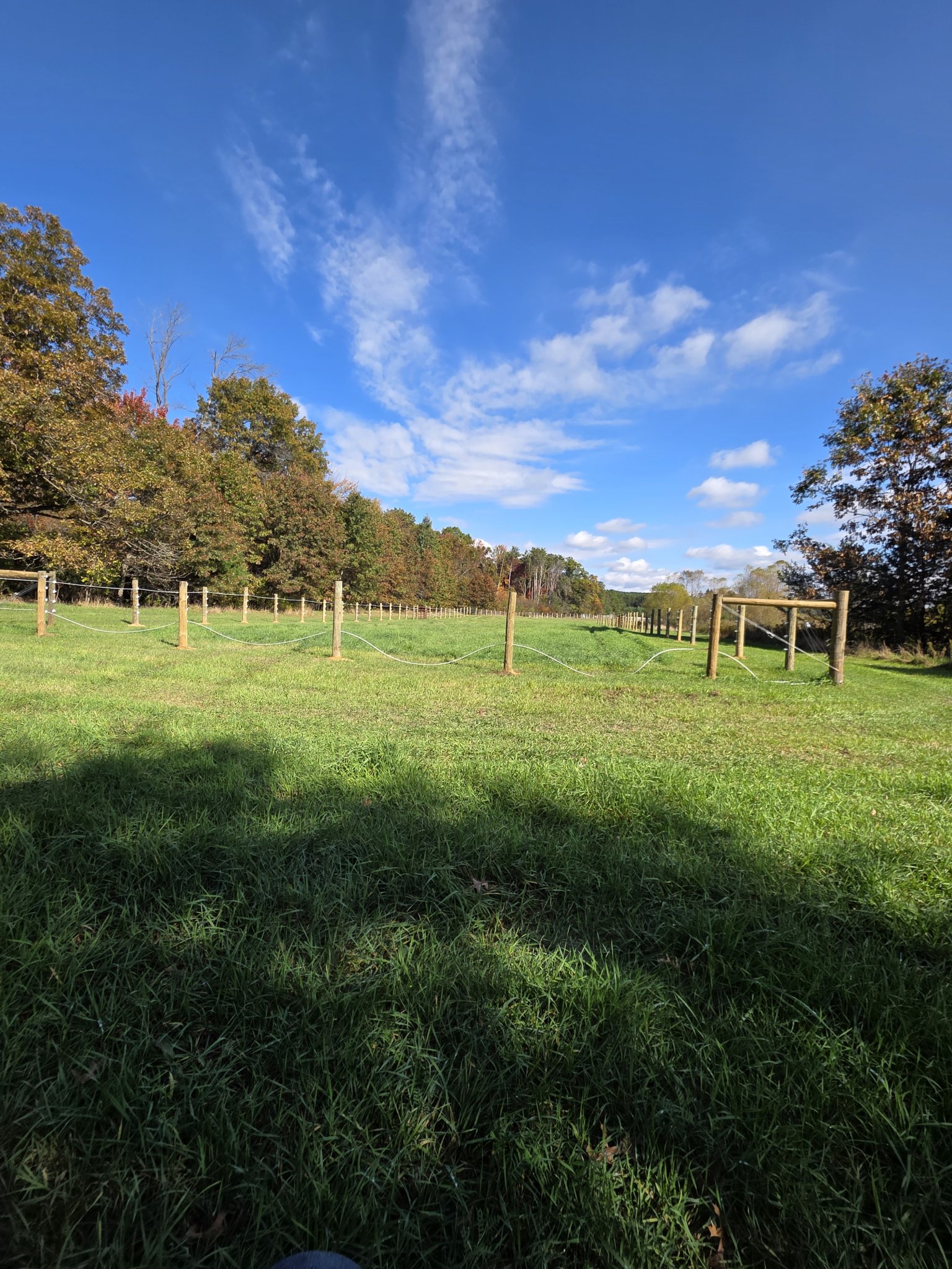

i have a cab l6060 and run a sa20 ssqa phd. the reverse is godly. ive put in about 130 posts with it this summer/fall and got about 250 more to go for next year.
ive been drilling a hole planting the post and moving the next one letting the tractor rest inbetween. it isnt fast but its more than enough. i do love the hst trans.
my use is horse pasture and horse care
