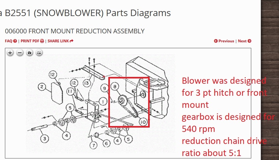

I want to point out a couple of facts which may not be completely clear.
This blower was made for both 3 pt hitch and mid pto front mount.
The worm gear box between the auger halves is designed to run at 540 rpm which is the standard rear pto speed.
When used in a mid pto application, a chain reduction sprocket set was placed between the mid pto shaft and the back of the blower to lower the rpm that the blower sees to 540 rpm.
The chain reduction ratio would be approximately 4.6 to 1. This from 2,500 mid pto rpm divided by rear pto rpm of 540.
Please count the teeth on the two sprockets and advise as a ratio of 40:1 seems most unlikely.
Dave
Dave
Dave you are absolutely right my ratio is 4:1, 40 teeth on one gear and 10 on the other. I calculated operating engine at 2210 to obtain the final 540. Thank you for the response. I dont know what I was thinking about today as I had checked the ratio last spring. Memory goes with time. Thanks agsin

On my B2650HSDC, the mid pto runs at engine rpm, so when I blow snow at full throttle I'm at 2500 rpm. If I get into deep snow I can drop 500 rpm easily, and have to back off on the forward motion of the tractor to regain rpm. I only have 19.5 up on the pto, so full throttle it is.
Dave was right on with the ratio and speeds, it all works out and matches close to your 2650. I ran today on high PTO, 2100 RPM approx on the long shaft just seams so fast. LOL waiting for clearance from the control tower for take off!!
Dave
Hi there,
If I’m convinced that my blower was used in the front with PTO electric clutch by the previous owner, what gear ratio will it be so that I can be sure? AND, if I want to use it on the rear, will I need to change this gear ratio? Any other things I should be doing?
I need to have a 3pt hitch frame made up as I don’t have one.
cheers

Hi there,
cheers
For rear 3 pt operation you will need to completely remove the reduction chain drive as shown in my earlier post.
After doing that, as far as pto operation speed, you are good to go.
Dave
Dave
Great thank you!
will it be a specific 3pt frame I need, or are they fairly generic. Looks like I might need to get one specially fabricated to fit.

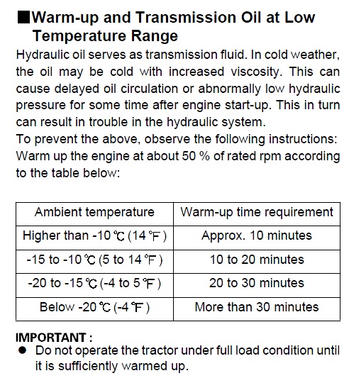

I just engage pto at 1200ish and throttle up to somewhere near 2500 rpm, parked. If starting cold a minute at 2000 and that's it. Then 2500ish all the way. Then I get going and let my hst pedal position (speed) manage the load so there's no lugging.
Just want to make certain you are aware of Kubota's trans/hydraulics warm up recommendations.
You deviate from these recommendations at the risk of expensive damage.
Dave
Dave
Yes, I take great care to warm my tractor before using. That chart is pretty much what I do.
I was referring to the snow blower warming up at less than full engine rpm for a minute or so. Not the tractor! Getting the grease and gear oil flowing a bit before hitting the snow.
Glad to hear what your common practice is. I did not read your post like that and was concerned. Not everyone has nor reads an Operators' manual.
Dave
