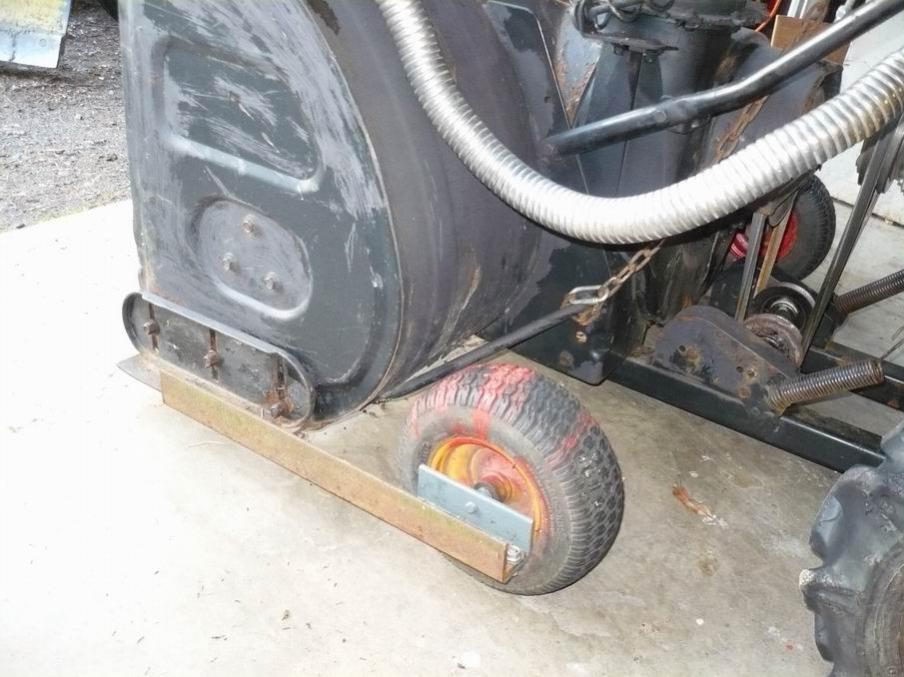

Last year, I had some problems with the snow blower on my B5100 ( front mounted) - essentially I could not get enough ground clearance when i was blowing out about 200 ft of washed 3/4 inch gravel driveway.
The side bars dug in and within about 4 - 5 ft of travel I heard - tik, clack, clack - as the gravel was being heaved up the chute.
So this year,I made what I think is a better way of maintaining about 2 inches of clearance - see pictures.
I've tried it out on a recent small snow fall and it seems to work OK, but so far this year we've had much much less snow .
I know that it works best when going in a straight line , turning requires that I lift the blower a bit so the rubber wheels are above the snow ( more or less)

Not sure it'll work. I would make shoes that get the height you want.
If it does work - and I hope it does - after a few passes at 2" clearance, you may want to have a way to reduce it to 1" or less, once a good base is built up.
Otherwise, you may have a lot of ice to deal with.
That is an ingenious way to get clearance - great idea!!

Best off to tramp all the snow and freeze yourself a base. A drag of sorts works.
My driveway was a souphole this first snowfall, and was a muddy gravel sloppy snowy mess. Turf torn up everywhere.
It snowed heavy but wasnt cold. Ground didnt freeze very fast.
Having those wheels swivel a few degrees in either direction would eliminate the need to lift, unless backing up.
Good idea, building to suit your needs.

We get enough snow falls that we don't get much ice build up - I prefer the hard packed snow.
Many years we do, too. Later on, that hard-pack snow turns into ice.
I like a good base - just not too much of it.....I throw sand down periodically, and that helps during the thaws. Last couple winters, I probably had 4" built up in places.
That is a great idea!! I really hope it works!!
