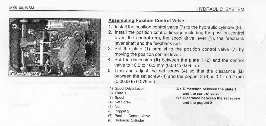

So, now the questions. Does anyone have any insight into the adjustment? Has this been accomplished with adjustments to the valve spool joint 1 and/or poppet 2 set screw as shown in the attachment (something I would try)? Or, does it require actual disassembling of the valve and shimming, replacing springs, etc...(something I probably wouldn't try)?
If accomplished with adjustments to valve spool joint and/or poppet 2 set screw: Is there a tech procedure or preferred direction or order in which to start making movements? A preferred dimension to 'fudge' on first in order to get this hitch smoothed out?
