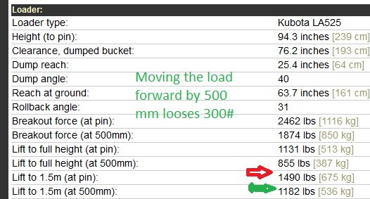

Your instincts are probably right. I'm assuming those are 42 or 48" forks which is a huge lever. The max lift on the loader 500mm (20") in front of the pins is 855 lbs which is about 300lbs less than at the pin (1131 lbs). So you'd be lucky if you got 400-500 lbs of lift.

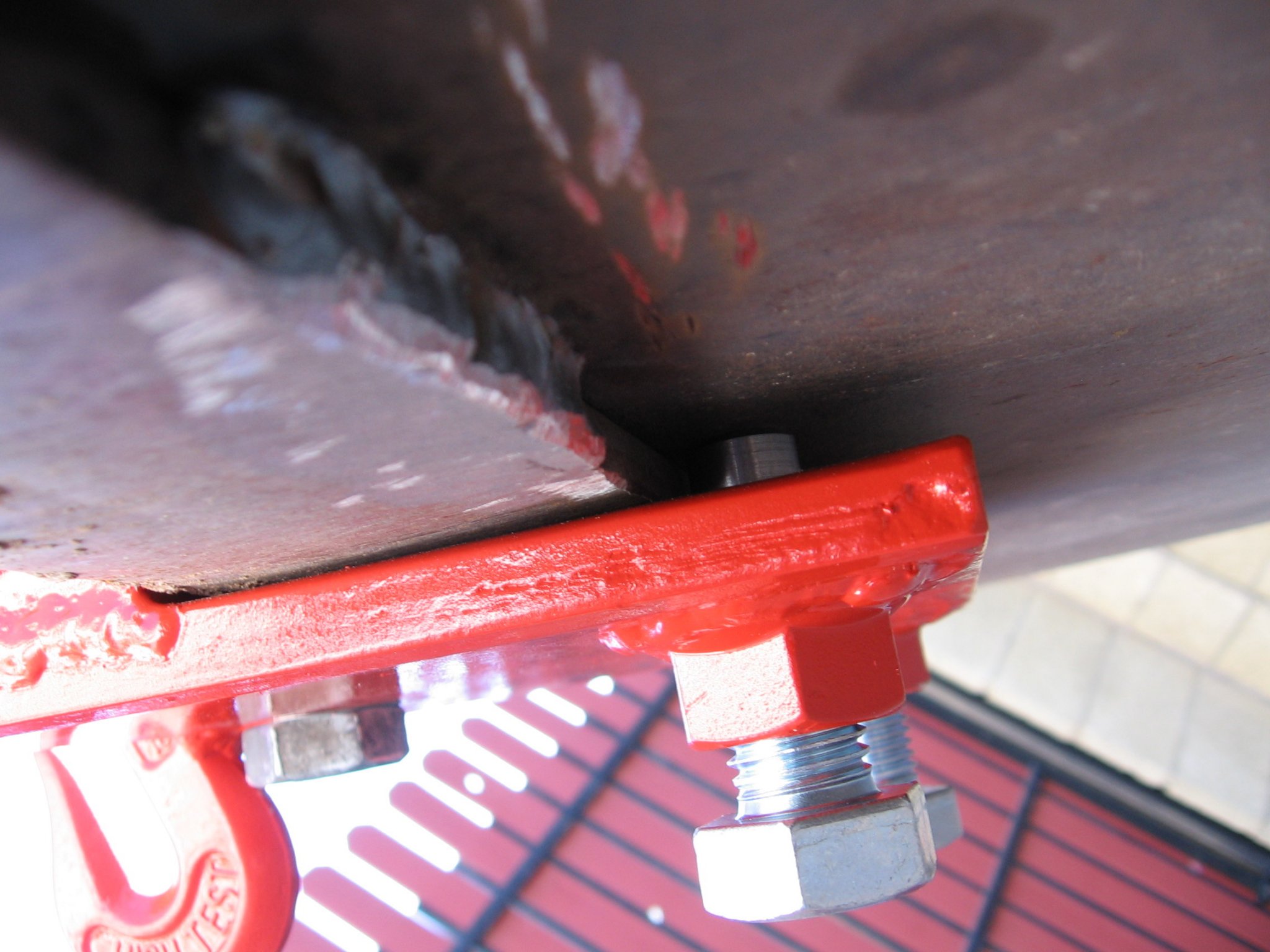

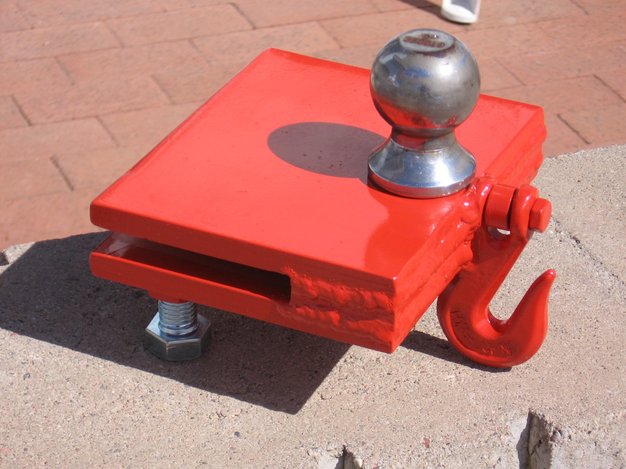

Here is what I made for moving trailers:

Can you see the trailer ball as you connect to your coupler? I assume so, I like the unit you built.
What is that additional bar on the bucket? Looks fairly stout. Thanks for posting
I can see the ball fairly well, unless the trailer tongue is on the ground.
The additional bar is the stock welded on cutting edge.
