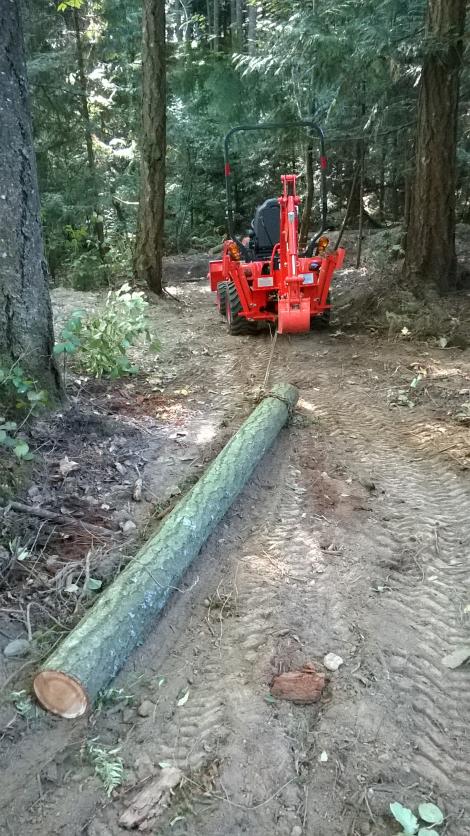

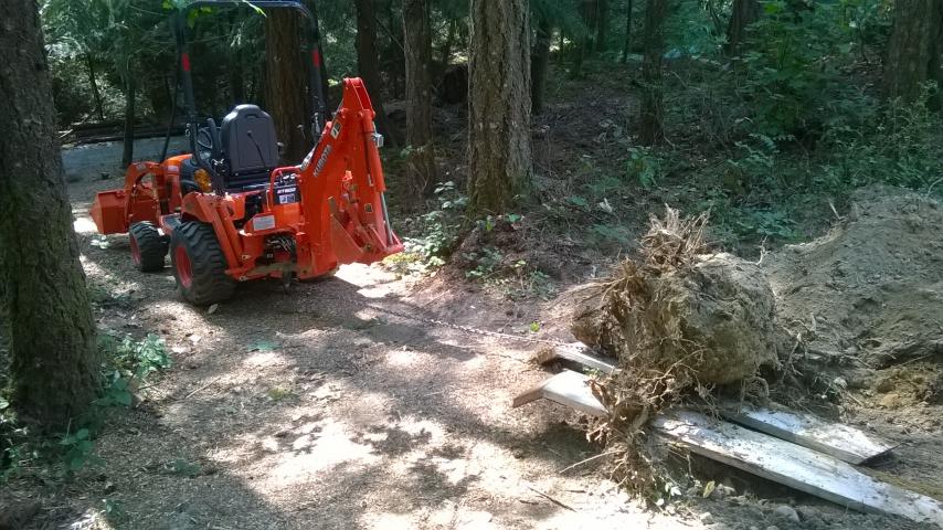

I hooked a chain to a hook (now a proper hitch mount) - it's low enough it did not interfere with the back hoe. The picture shows a stump being hauled out of a hole - the tree was hauled away earlier the same way. (Edit added the picture)
