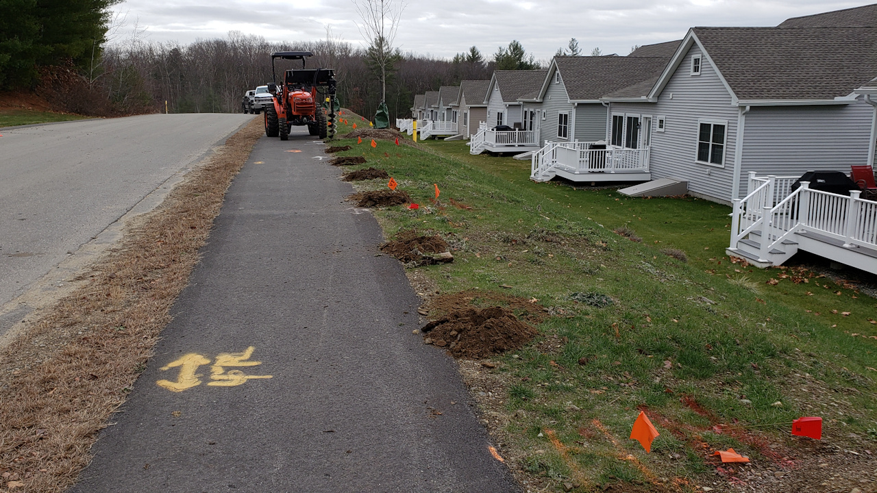

Isn't a hydro drive a "constant flow" application? Drive a few miles down the road....
I have well over 1000 holes drilled in nasty NH ground with a smaller tractor with lower output.
Having owned both auger types and I would never recommend a 3pt auger.
At the same time there are hundreds of hydraulic augers/models out there and the recommended flow rate/pressure of that will be the important number to accommodate.
Man you are killing it with those holes! Every photo has you in a new location. The fence business must be booming despite lumber prices.
NHSleddog
B2650
Dec 19, 2019
2,144
1,834
Southern, NH
This was actually a month ago. It was a DIGSafe minefield.
