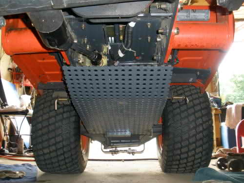

JB good looking plate, Skeets thanks for the info I will just keep the mmm on when cleaning the brush. I will only be clearing for about a week, then hauling fill. And with snow blowing it's not a concern that's good news.

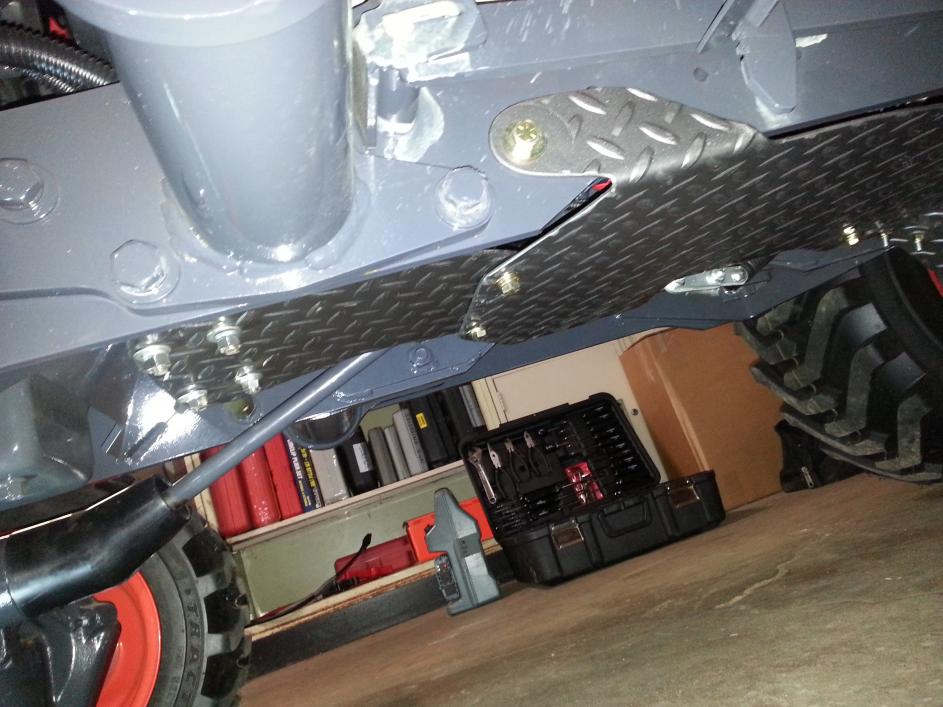

Hi,
I am the proud owner of an BX2370, and am clearing the back property, have read that a skid plate would be a smart investment. I have a 60' mmm and am not sure what to buy. Could anyone chime in with some experiences or direction. Thanks
Here are pics of my "Bro-tek" heavy duty diamond plate shield. http://www.bro-tek.com/
I am in the woods a lot doing logging, with now problems with anything hitting my fan.
Because of this shield, it allows me to just dive into the woods like as if I am driving a small tank.
