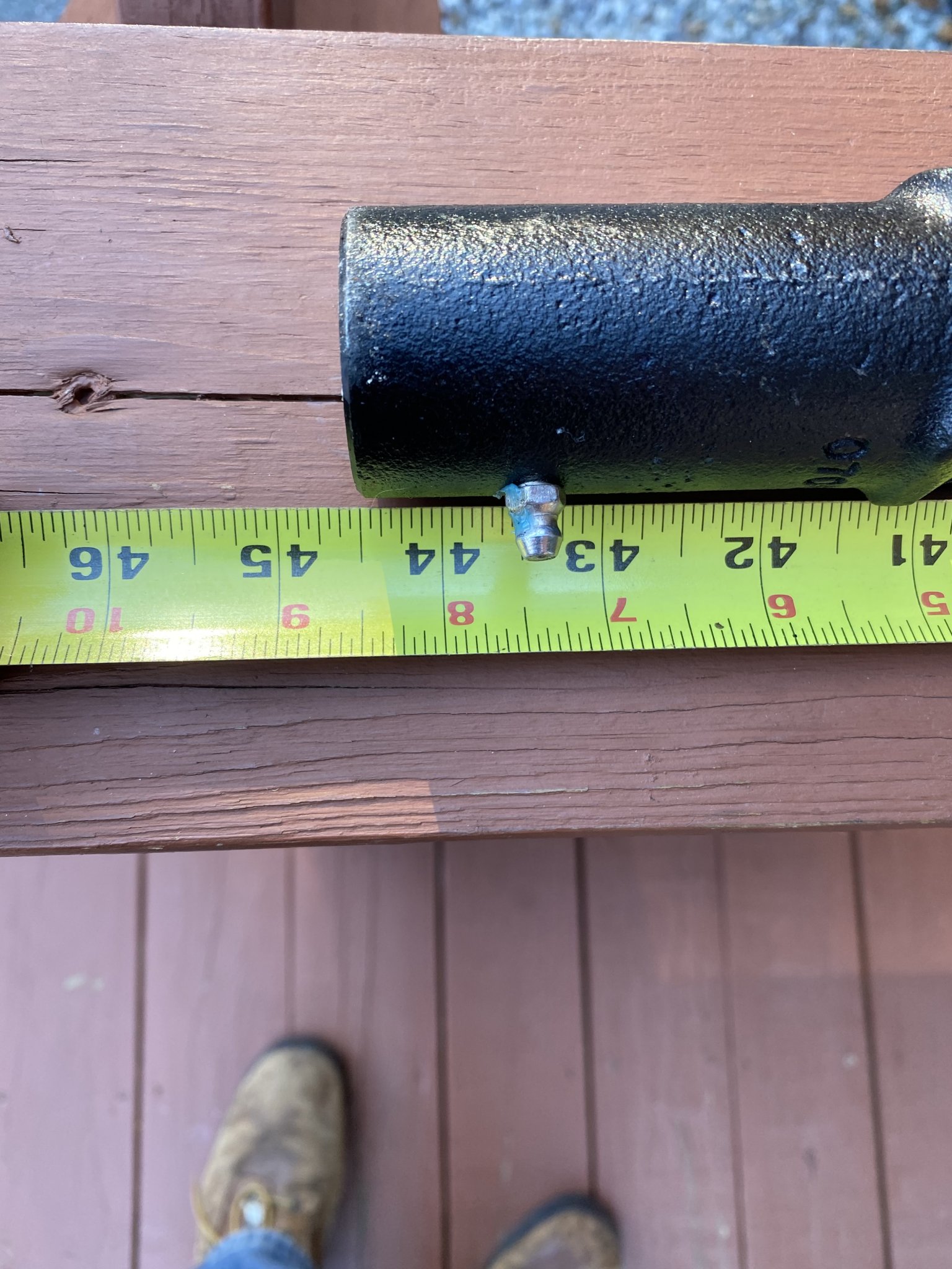

Apparently dealer gave the wrong mid pto shaft when delivering my new BX5455HD snowblower. Installed it yesterday while prepping the BX25D for winter and the shaft is SHORT BY 2" when hooked up to the mid pto output shaft. Hopefully it's just a "bring the shaft back and get the right one" deal...
This shaft measures 44.5" end to end. Anyone have one of these setups? Of course the dealer was closed yesterday and today. I'll bring it back tomorrow but would like to know the actual measurement of the shaft I need. I took pics of the situation...any help is appreciated with the correct measurement so I can tell the salesman what to give me. Thank you!

So…the “dilemma” is solved. This is after I drove myself to a sister dealer (1.5 hours) that had the “correct” mid PTO kits for my BX25d (as my local dealer had none. I spoke with the service mgr at the sister store and he knew what was going on as explained to him by my salesman over the phone. He brings out the kit and we open it and see that the 15” shaft is present. All that needs to happen is my dealer needs a service tech to uninstall the short shaft and install the correct shaft (and flip one of the bearings) I get back to my dealer and get the salesman to come look at the kit in my truck. I say get a guy out here and swap this out please…5 minute job.
Tech comes out and we’re all looking at whole quick hitch and it appears that the installed shaft is the same as the new shaft. WTF? I measure and it is the correct shaft INSTALLED INCORRECTLY!
(Shaft was installed to bx2752 specs with 5” of spline showing when it SHOULD have 8 3/8” showing per bx2753 specs. 😡Tech said it might take some “heat” to unscrew the bearing set screws as they should HAVE RED LOCKTITE on them. Supposed to be doing it this afternoon. Crazy stuff! NEVER TRUST THEIR WORK! Very disappointing and I wasted over half a day to boot (and still have to go pick it up.😡
