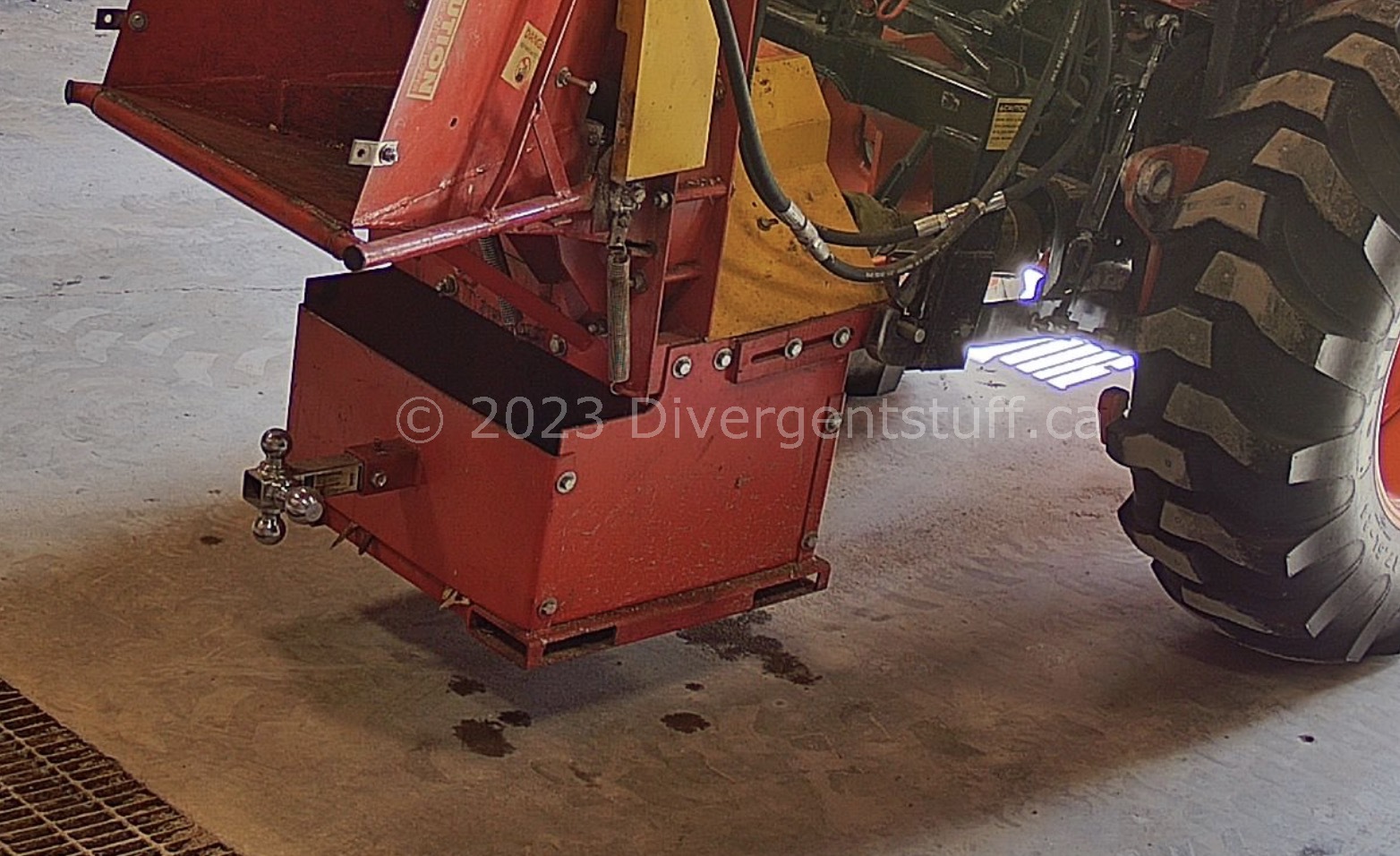

I welded up a steel frame on mine using 2x6 steel tube that allows me to grab the chipper with forks on all four sides. Makes storage easier. The wide base stops the chipper from sinking into the ground while chipping. The added weight also dampens vibration.
Thanks Mike. Any pics available? Sounds like a great idea.

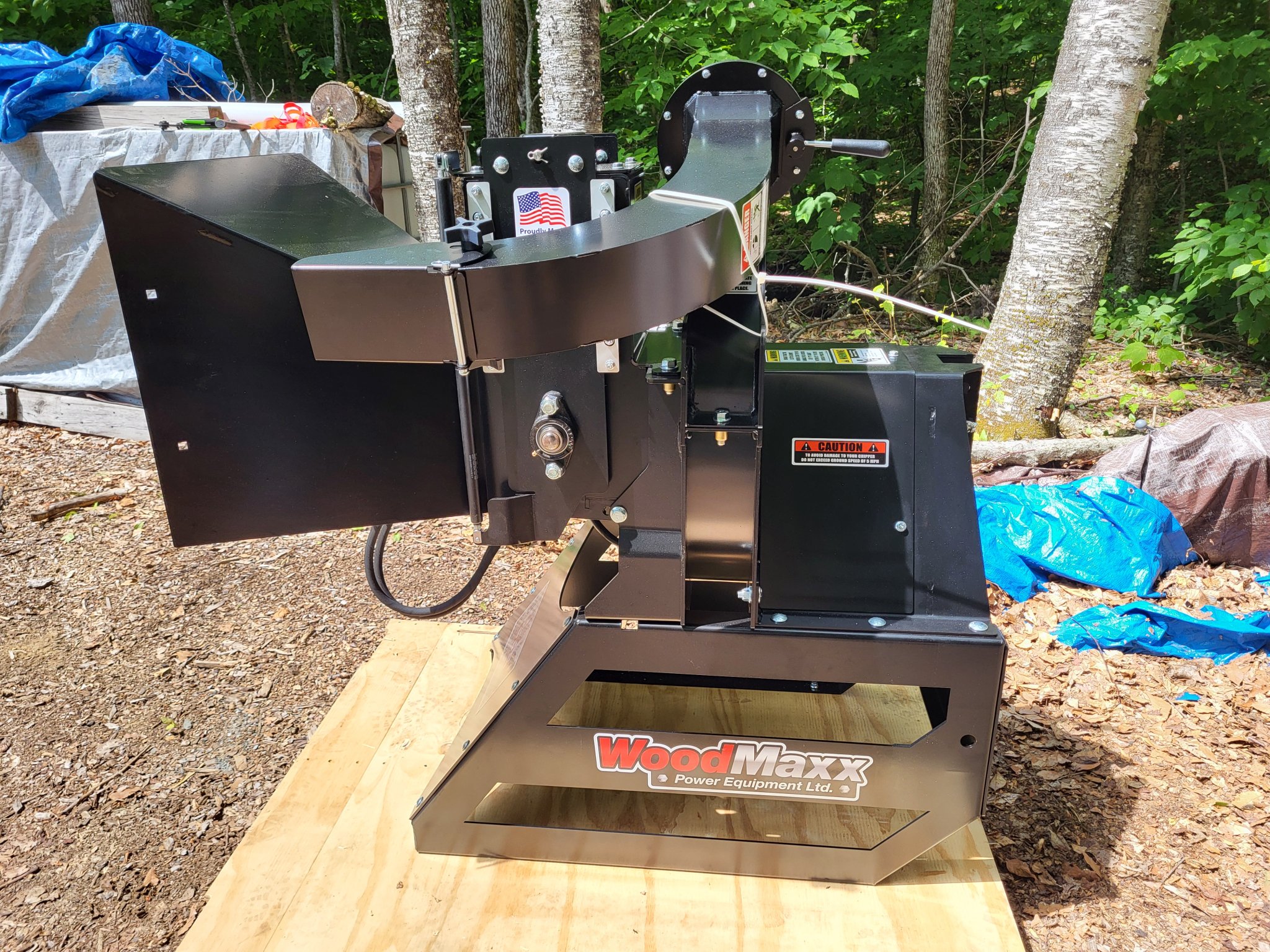

Finally finished assembly of WoodMaxx chipper. Apparently their employees are happy with their work. See pic #2.
